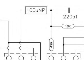

Hi Jan,I thought you would want to know what the function of those caps is so you can make an informed decision for replacement/upgrade.
I would look them up in the schematic to see if they are coupling caps, power supply caps, filter caps, etc.
Jan
As I already answered they are output capacitors.
(I don't know why Bryston used this symbol)
No, also coupling at the input section. What is going on lately? It seems being imprecise as much as possible is now a virtue.

BTW 100nNP could mean Non Polarized.
Jan
You are right with that statement. I am such a fool that gives tailor made solutions for free. The other way around I usually have to pay nowadays or I am forced to still find my own way.
NP, Non Polar, bipolar give it a name. And as can be seen on the picture 6 pieces 100 µF 40V Philips axial bipolar electrolytic caps best replaced for film caps that fit exactly so PCB material stays OK.

Think about it. For power supply use, the electrolytic has to have a large capacitance, but losses are unimportant. In fact, a bit of loss is good and helps to damp ringing.
For a coupling cap you want an 'ideal' cap with no distortion, no losses, and you normally wouldn't use an electrolytic for that, unless the value is very high.
There are other uses like in a filter, crossover or whatever, and you can have other requirements for the 'best' cap.
So asking for 'the best' only leads to more questions.
Before asking for advice, try to collect as much info as you can. That way you have a better chance of getting is useful answer. If the question has not enough info you get all kinds of conflicting 'advice' and you only get lost more.
I realise that when you are a newbee you sometimes don't know what question to ask or what info is needed.
But posting a schematic and asking about a specific part normally can be done. And don't just post a cutout of the schematic with the part you need info about - the whole schematic plays a role!
Often people post a picture and ask about some part in the picture. That most of the time is useless - we need a circuit, unless the color of the part is important to you ...

Hi Jan, I already posted the whole scheme (https://archive.org/details/bryston_BP25_SCHEMATICS), thanks for being more specific about the considerations for using which type of capacitor for which specific purposes.
