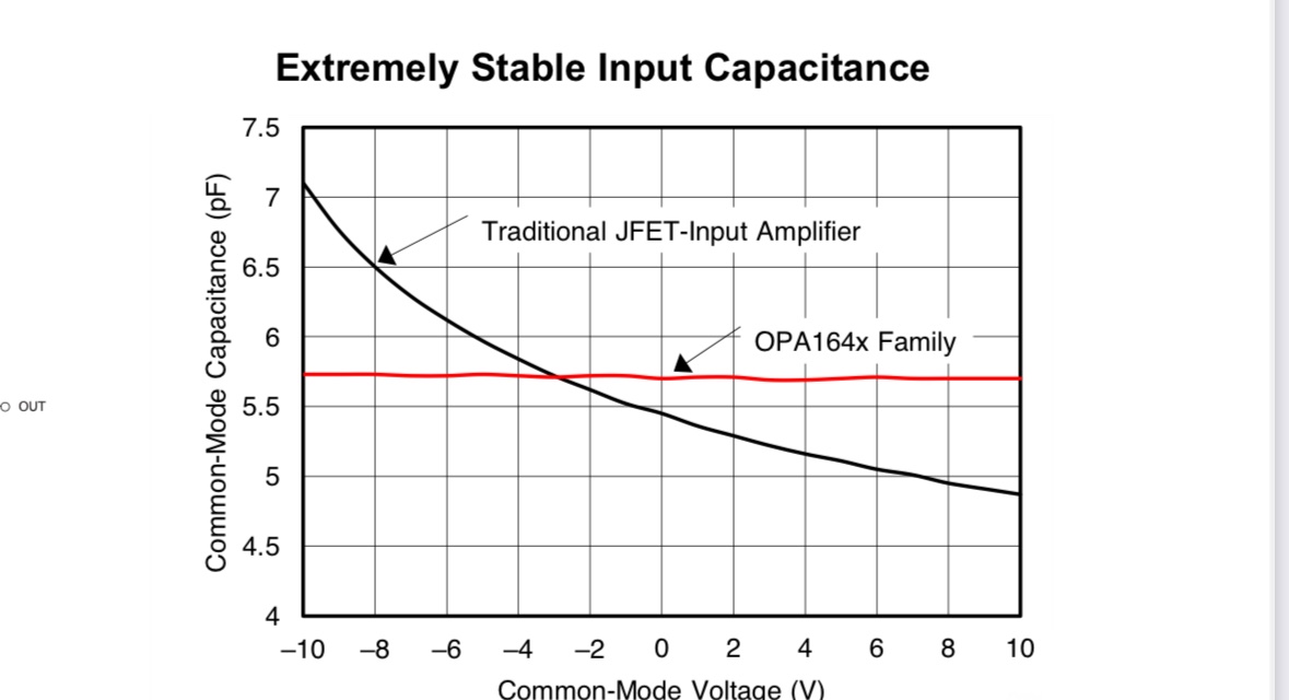

Pity you can't find any of those FETs anymore.
Well there are now possibilities.
I digress to draw attention to relatively recent advances from Ti.
There are no longer barriers to considering Fets or Jfets.
One of the problems with Fets -Jfets is variations of gate capacitance with voltage Right. You then need to include surrounding circuits to stabilise that.
Refer to the link below.
https://www.ti.com/lit/an/slyt595/slyt595.pdf?ts=1744788928133&ref_url=https%3A%2F%2Fwww.google.com%2F
Ti have developed a die fabrication process that gets around this problemo in the OPA1644. The OPA 1656 also has advanced technology including feed forward to improve performance under a wide range of conditions.
I have discussed elsewhere on the forums how diy people can now achieve SOA measurements without resorting to complex discrete stages. You can also parallel opamps and class A SE buffers if required for lower noise with reduced feedback impedances.
For example a quad OPA1644 can used in parallel with 10R load sharing resisters to drive lower impedances like the NE5532.
If you have followed Douglas Self 2 part opamp distortion tests on the AudioExpress publication he provides all the applicable conditions with applications like Sallen Key filter where common mode voltage is a primary source of distortion.
Ti offer full support with detailed application notes and tools like Tina Ti software for free. You do have to use Surface Mount packages but there are immense advantages for optimum layout so your implementation works just like your simulation.
The graphs Ti provides on source impedance versus noise clearly outlines when to use either bi polar or the Fet-JFet counterparts.
These monolithic parts have inherently low temperature drift which means stable temperatures offsets that normally plague discrete through hole implementations.
Some of these opamps have very low noise too.

Thanks for posting the links. The input common mode issue was a concern for JFet input op amps.
