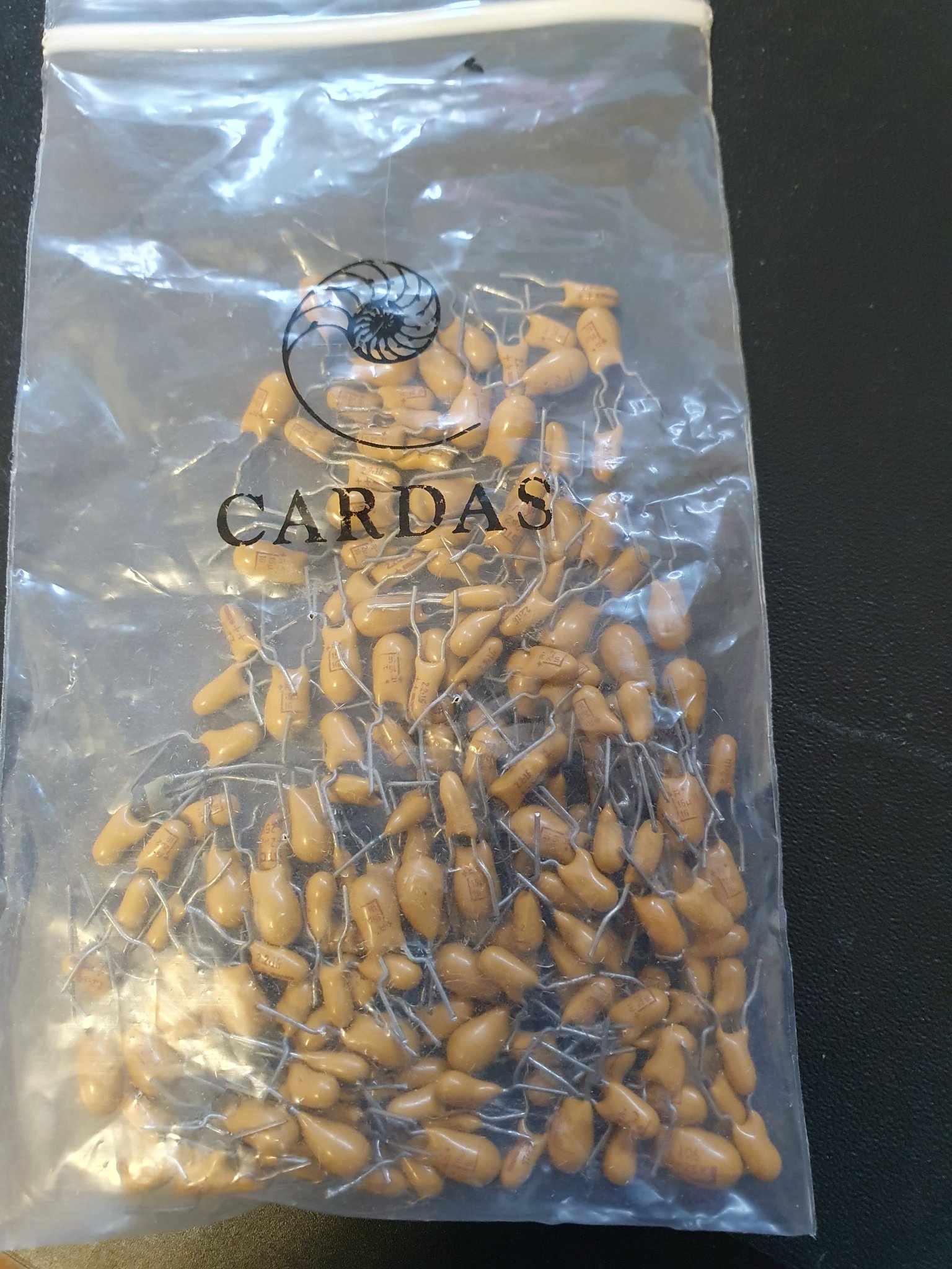

Exactly as described. Check to verify. Usually there is a brand symbol, a value and voltage and a datecode. Still logic says these are not the famous bad tantalum caps of decades ago. These have a reputation so bad that current tantalum caps still suffer and about every designer is familiar with the matter.
I know you think I am retarded but the point is I think it is completely logical to check such trivial things when looking at a board and the parts.
The bag you show has no labels. I would discard those if there can not be determined what brand/series and age they have.
