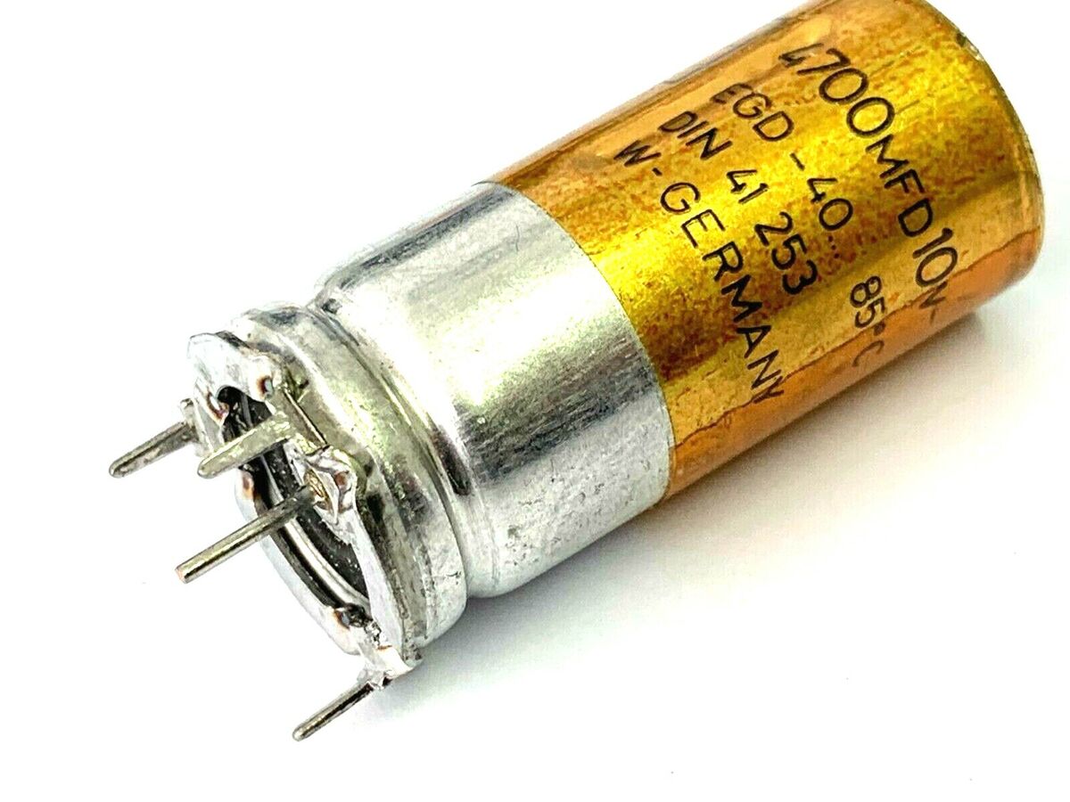

Yeah. Another project involved finding good replacements, I was finding it difficult to locate similar three point mount caps, still am!
Vishay 021ASM were used to replace the axials, at the time no cap was found with the three point mount.
The good thing was the mechanical stability of the mount, looked like a good idea.
The sikorel 125 have a mount version that looked similar, souring anything less than 100's stopped that.
Kemet PHH223 was the other, but the info was 'shelved for later'. a similar sourcing quantity frustration.

RDE I haven't heard until now, but probably you mean "ROE" - the Logo on Elcaps for Ernst Roederstein (on the foil versions was the Logo "ERO")RDE caps are a areal source of trouble in Revox and Studer equipment.
Concerning a lot of trouble on this brand you are right - especially on certainly series like "EK" under
Roederstein 'BAKELITE' series EK capacitors - "Living Legend" OR "Looney Legacy" ...?
often to find even in top class devices from Krell and Mark Levinson, so as the low voltage versions below 40VDC from Roederstein's EDG series (unfortunately also often to find in STUDER/REVOX devices).
By consistently collecting and storing defective electrolytic capacitors over 30 years, it was possible to clearly identify which series were particularly affected by failures.

You're correct. I don't pay much attention to the exact brand name for poorly performing components. Having been warranty for Revox, I have had my fill of these terrible parts. I just recognize and replace.
There are many bad brands of capacitors, but there is no "best" capacitor. It depends on the application and many good brands are in fact equivalent.

I prefer Mundorf mlytics.
They even survive short circuits for extended periods, sound excellent, and all have very similar values.
What's the point of one 10,000uF Sikorel capacitor if the second one differs by 15%! I'd rather buy Mundorfs and not have to buy a dozen because I have to measure the correct values. Mundorf mlytics are always the best choice for me!

Mundorf are relabeled F+T caps.
The slit foils caps have more 'tabs' to connect along the plate length (T-power BHC Aerovox ALN20S1108DF since relabeled) ,
these were designed by Denis Morecroft of DNM, specifically for power supplies in audio to reduce the current path.
