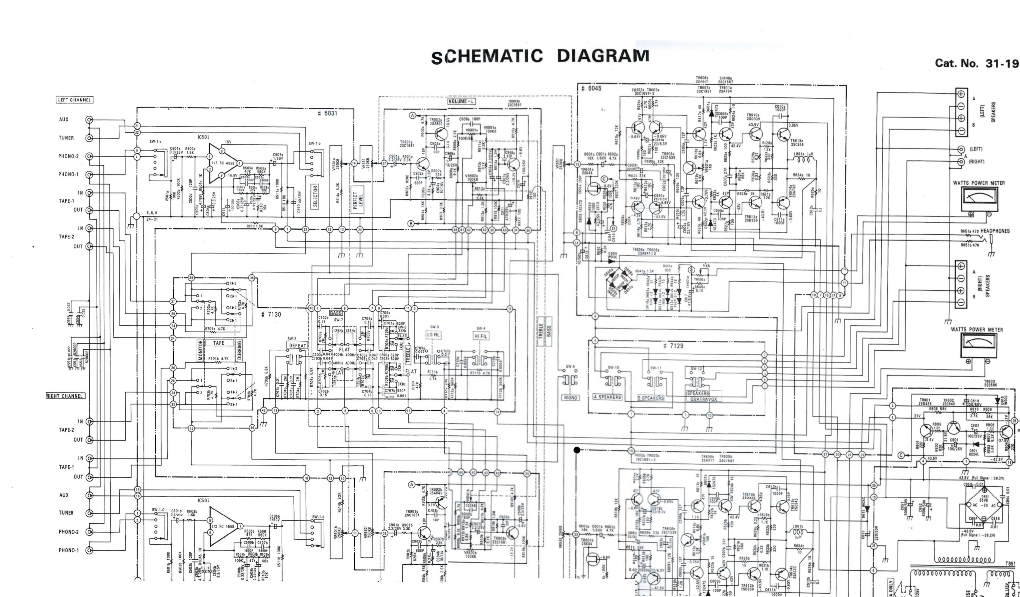

Hi sumotan,
yes it's 55 watts into 8 ohms here's the service manual, model is Realistic SA-2000.
This amp uses a 200V 6A Shindengen S5VB rectifier with standard silicon diodes I believe and it's the integrated type with all the diodes in one case so the Shindengen D6SBN20 which is the same rating but with Schottky diodes would work but with it's package like that I would leave it as the last thing to change out as it would be the most difficult to solder and try to fit, I am also not sure if it would still need the snubber capacitors and if I'm happy with the sound after replacing the stock 8000uF filters with new 10,000uF.
It said the 15 MB service manual file is too large so I will send the schematic instead
I think this might be in the wrong thread

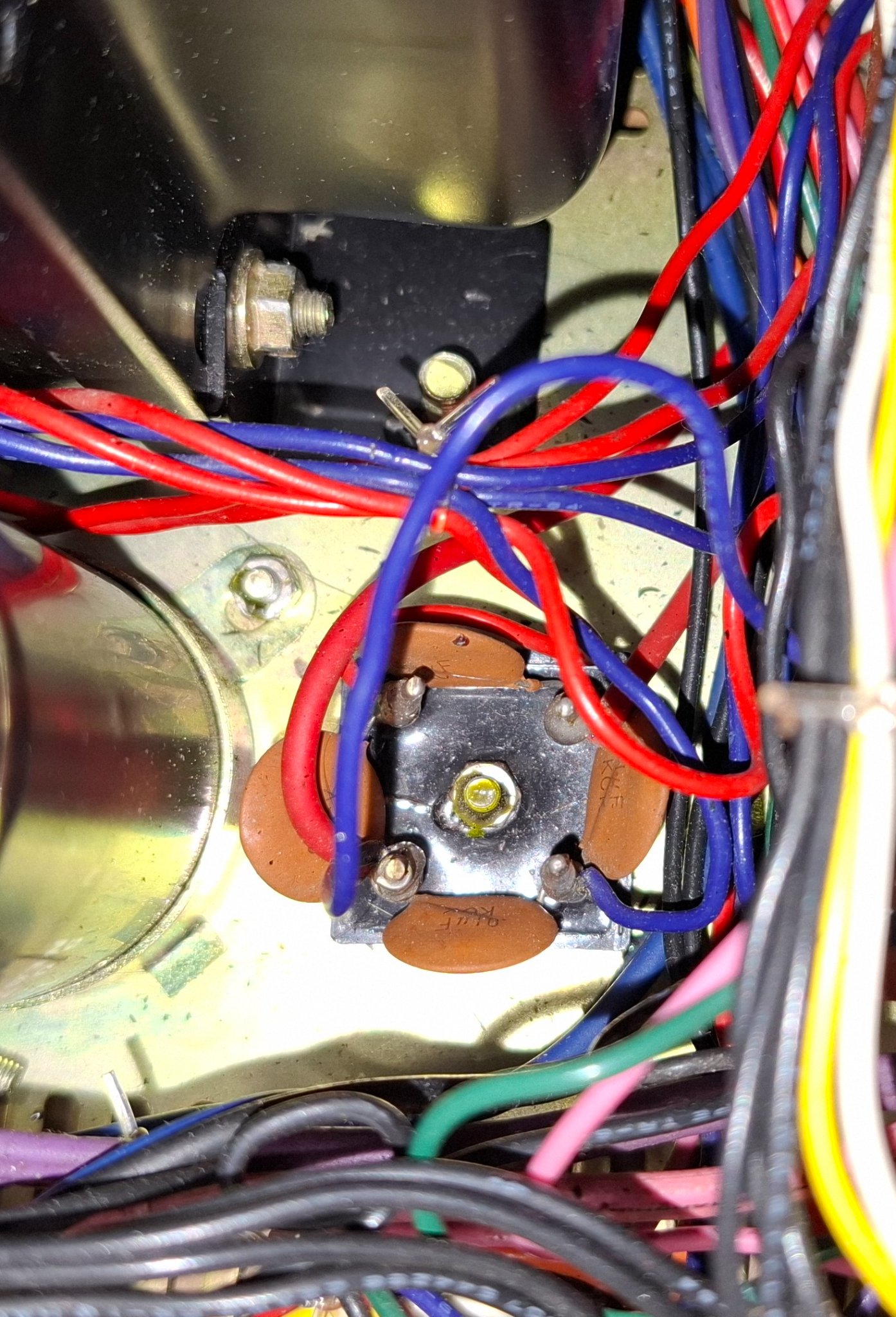

So Sa2000 a vintage intergrated amp, are the sliders the volume pot, if so too bad can't upgrade that part. Lol

Yea they tried to integrate the balance into the volume pot, looks cool and unique but not pratical, unfortunately no stepped attenuator with this one lol. I'll see what I can do about the D6SBN20, I have a variable linear power supply I can probably test it in, I was originally planning to use soft recovery.
