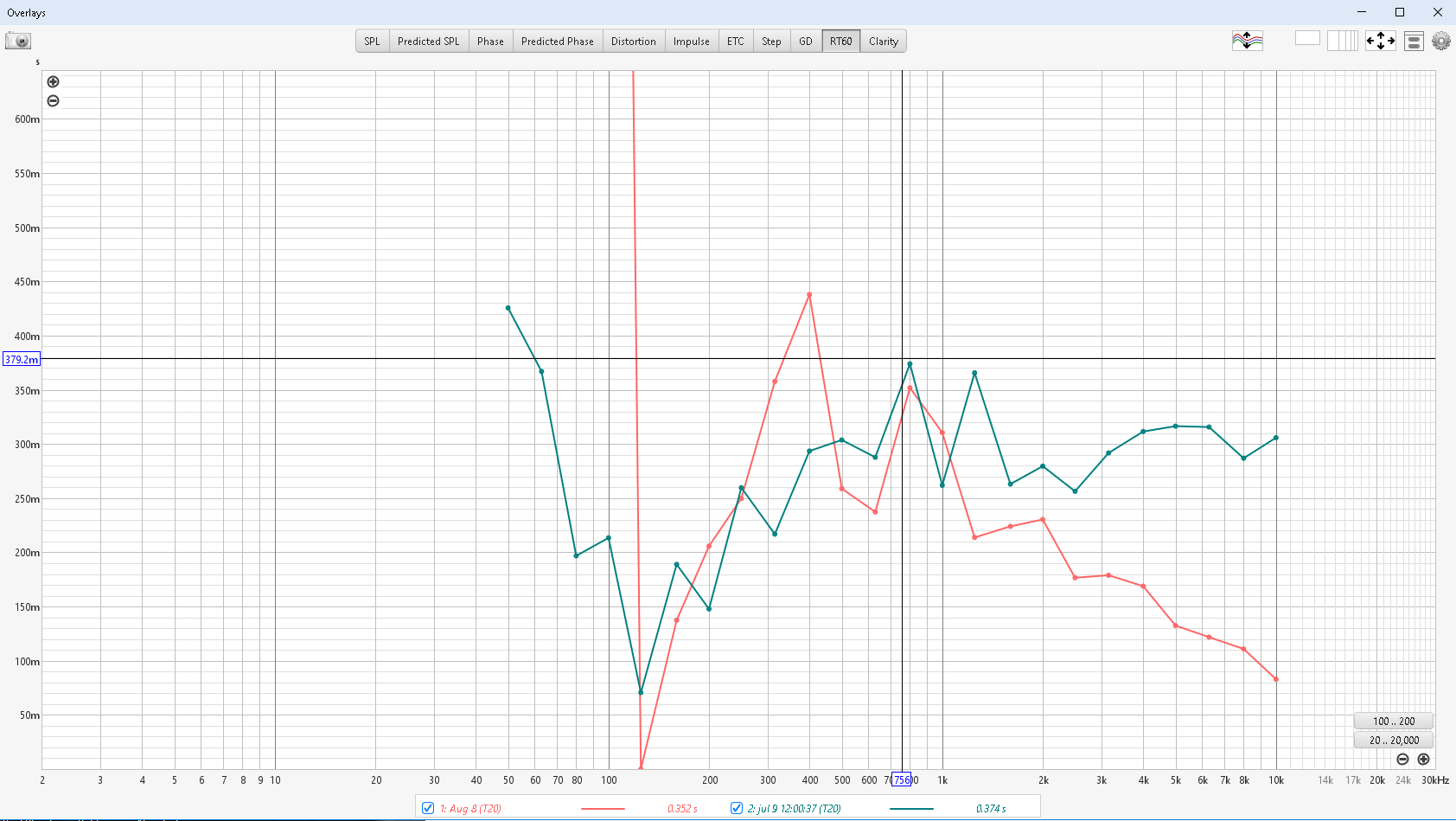

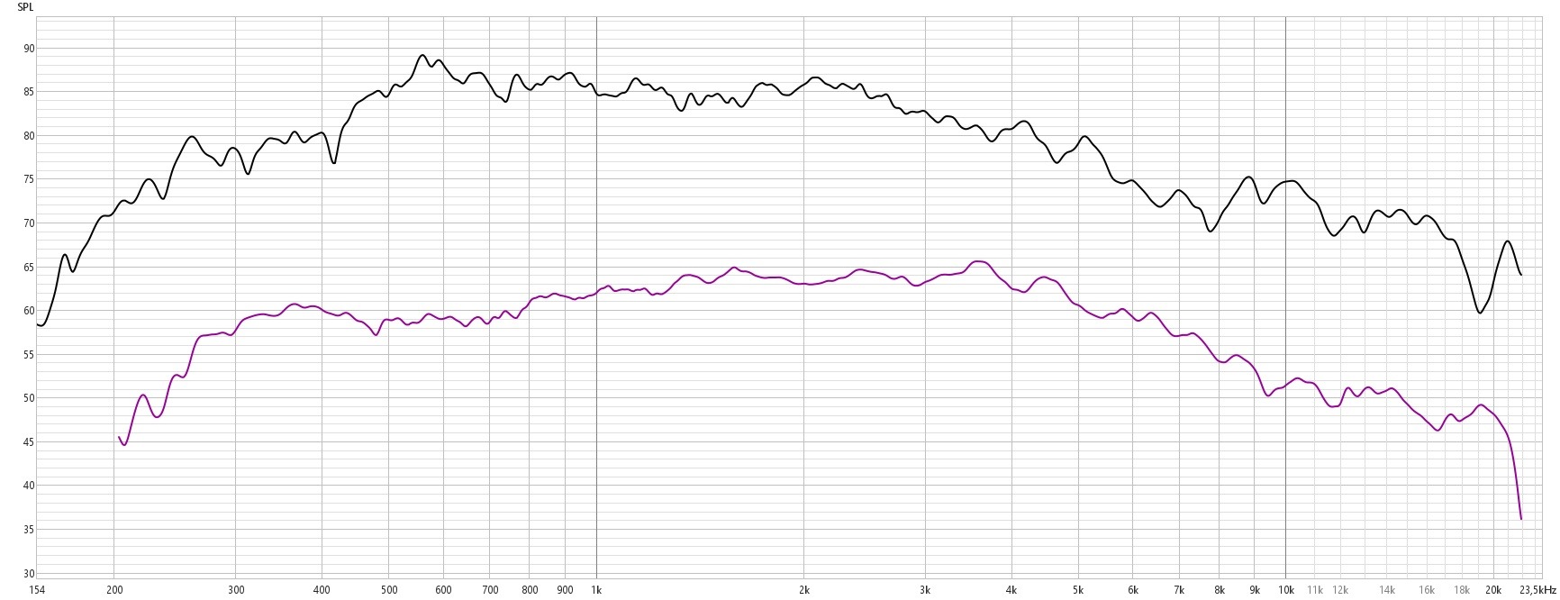

The difference between say an exponential and a CD horn on the systems designed listening axis WRT first arrival, using the precedence effect, is going to be minimal.
The Teal is a CD waveguide at 55cm and the Pink is an Exponential at 1m. Different rooms only make this comparison less objective but its all I got so far. My Room in Pink is all hard boundary and the Teal had hard boundaries but room treatment.
In my experience different materials are different for example reverb tail offs and low level detail appear to be more resolved and transients sharper with Be.

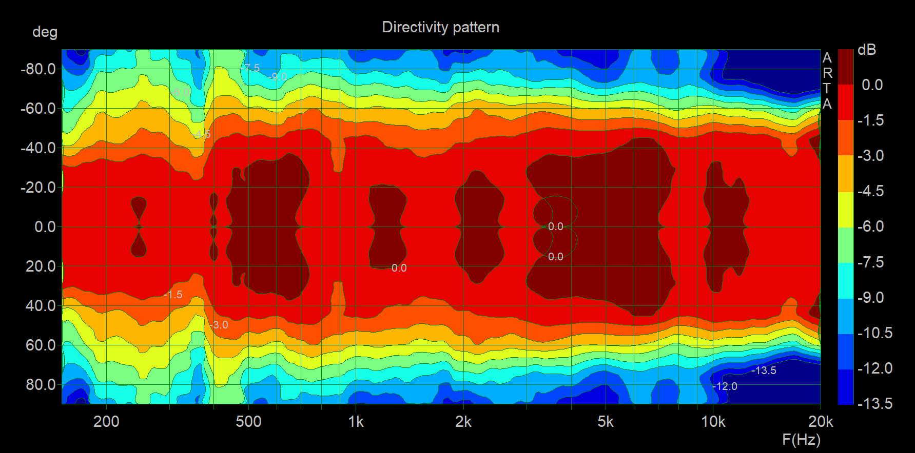

K402 indoor horizontal polar with no gating. Take note that measurements close up like this, end up having a wider beamwidth than what it actually has. But overall polar is otherwise quite accurate down to a certain frequency where the room contributes.

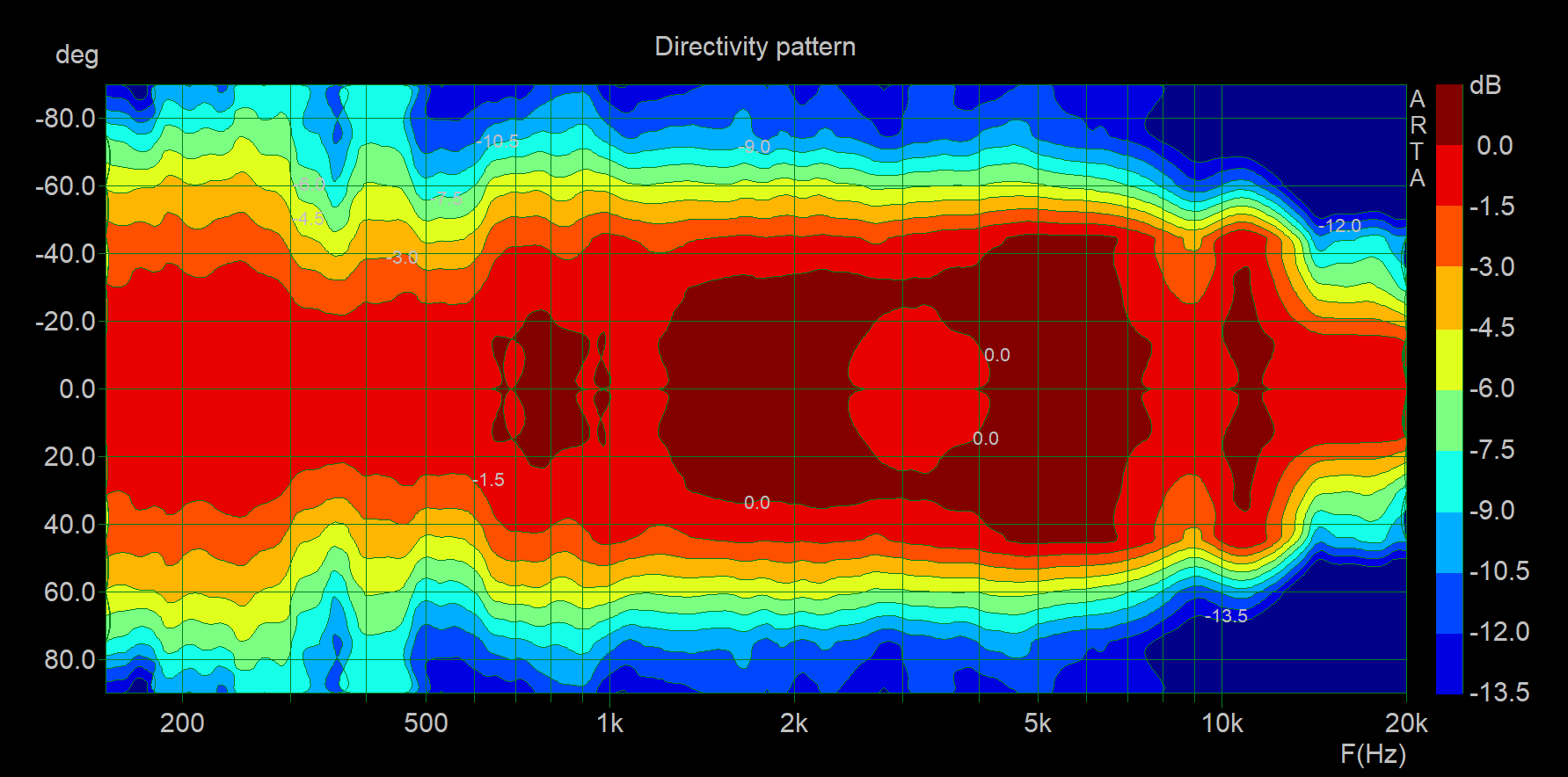

And here's an indoor polar of a horn I used to compare with the K402. It's even wider in the highs, but still sounded considerably smoother, and despite using a less quality driver than used in the K402. So "wideness" in highs is not the issue here IMO. Besides I tested with absorption of early reflections.
90x60 Flat front horn horizontal directivity indoor to 90 degrees no gating_15dB interval.png

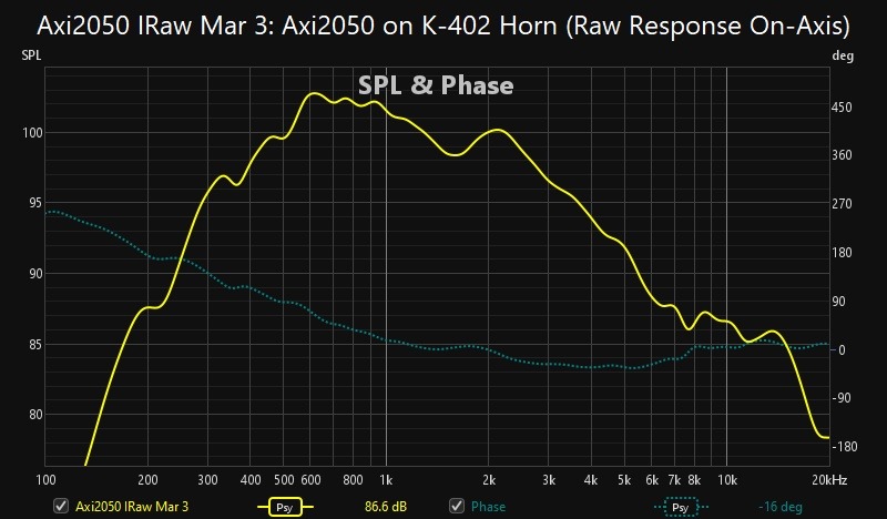

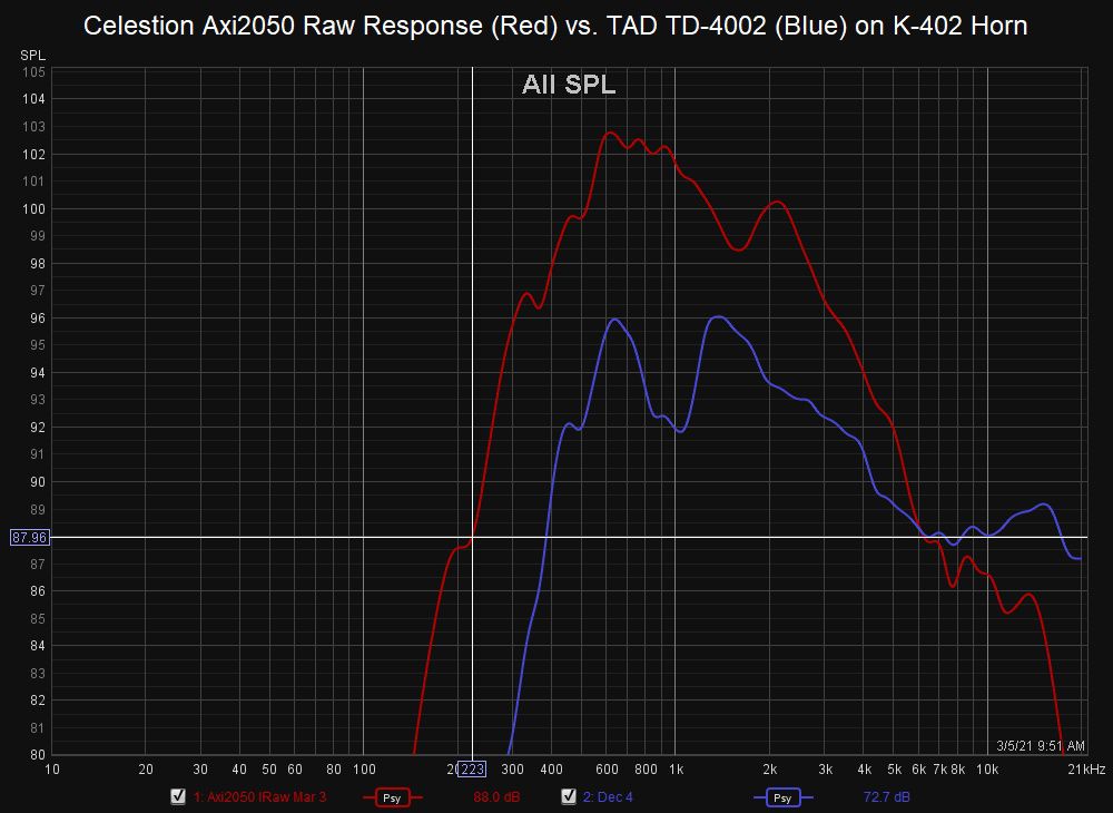

What hyperbole! I think most people that actually listen to and measure the Axi-2050 on a K-402 Horn (the only in-production horn that can actually use all of this driver's output effectively that I'm aware of) will have a dramatically different point of view than yours.
You can read about my observations, spread over a month's worth of listening side-by-side with a TAD TD-4002 on the left channel and Axi2050 on the right (K-402s on top of KPT-KHJ-LF bass bins, dialed-in carefully)--the second posted pdf file found here:
https://www.diyaudio.com/community/...heritage-jubilee-acoustic-performance.396074/
Chris

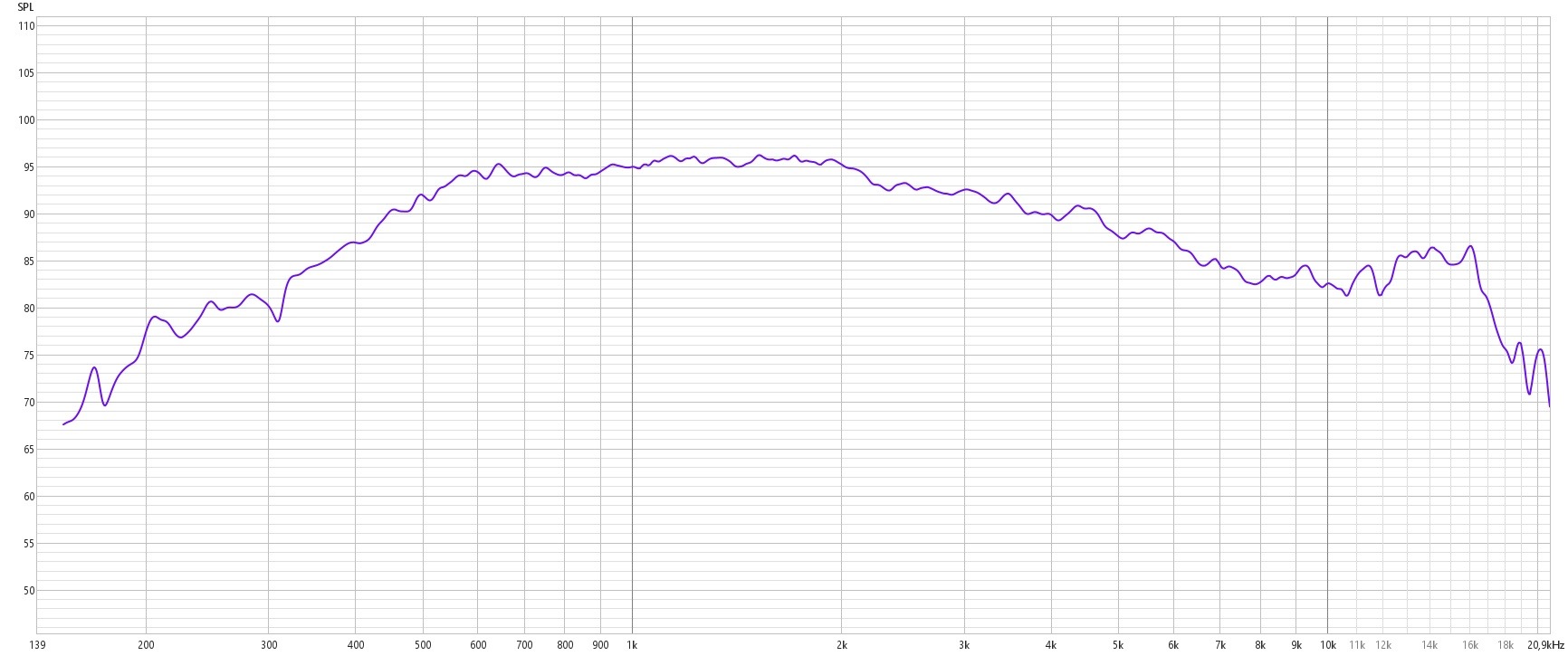

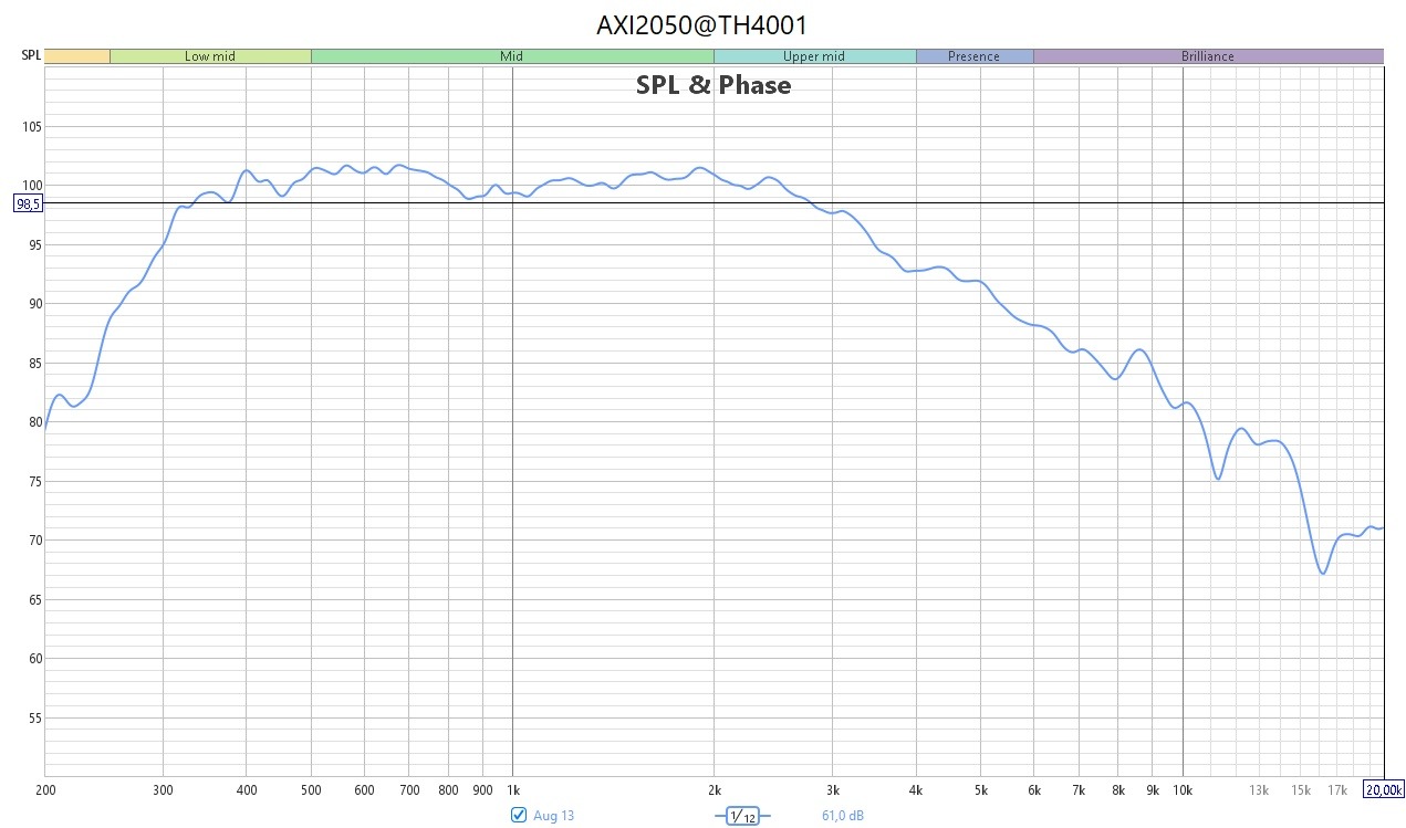

fr does almost nothing tell us about sound quality. Furthermore, the curves are more than disappointing. There is a steep decrease of spl below 600 Hz. The throat region is imo a really stupid design making it easy to manufacture maybe. The surface area expansion of this waveguide is way to fast so it cannot provide much acoustic loading - just learn the math.
Axi2050 attached to TH4001 with a suboptimal adapter. Just recognize the even spl down to almost 300Hz with this much smaller horn. It is a better choice for the AXI.

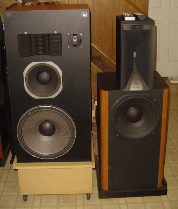

Yes in the sense that I have used older horn systems. Here is a picture of a pair of clones I built and still have. One is 4344 the other an Array 1400. The 4344 has increasing DI even with the lens over the 2307 which is an Exponential horn. The 077 has the same basic pattern with a wide horizontal but very narrow vertical pattern,
The Array has an 80 X 80 and a 60 X 30 Biradial CD type horns. I had both in the same room for a while. I built the 4344's first had them for about 5 years and then built the Arrays.
The 4344's were almost head in vise. If you stood or moved off axis you could easily hear the effects of the increasing DI. The 1400's were night and day better in this respect.

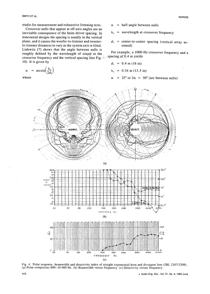

These obviously don't and can't use the same drivers. Here is the plot for pattern on the 2307/2308 if you take off the lens the Horizontal mirrors the vertical. As you can see it's gets very beamy up high.

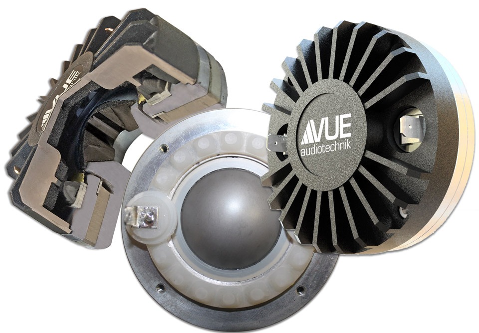

Does anyone on here have experience, or extended information on this driver btw ?
1" exit, Be truextent dome, with a "plastic" suspension, 34mm Voice coil.
Diaphragm assembly looks rather unique, with the terminal arrangement, going directly through the backcover.
16 0hm diaphragm.
3 slot phase plug it looks like.
And a phaseplug that does not extend to driver exit.
Backcap is very similar to the Radians 745.
External Neo ring magnet.
The air gap looks rather large on the bottom, not nessecearily a admirable trait.
Looks like cutout did not go very smoothly on that pic.
They're E series speakers are also interesting creations, but don't belong in this thread.

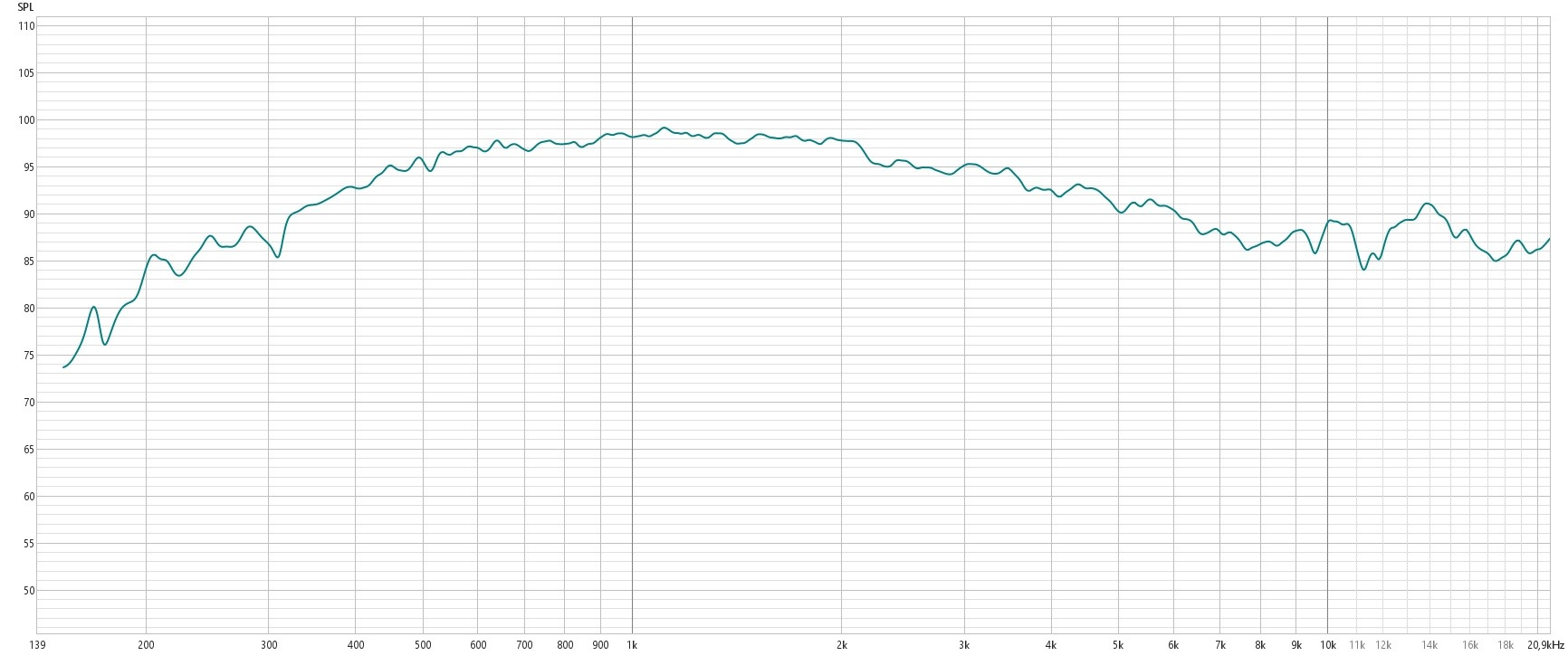

The K69 driver that came with K402 horn was of poor quality. Here's a raw measurement of the K69 driver in the K402 horn:

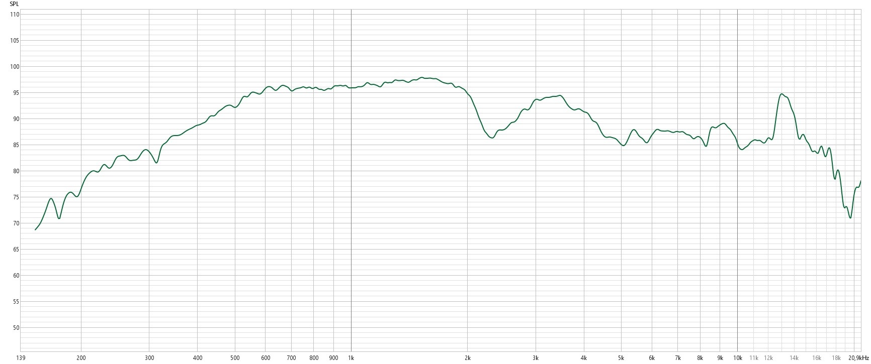

Here's K402 with the JBL 2446 Be in comparison:

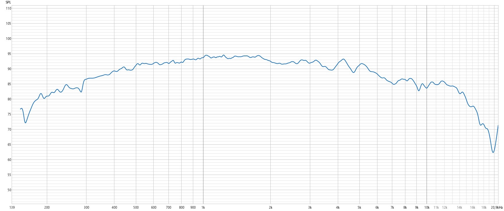

K402 horn with JBL 2446 Aquaplas:

All graphs are with 1/24 oct. smoothing. You can see my measurement of the K402 with the AXi2050 earlier in the thread.
You didn't identify the driver used. Did you forget about that?
