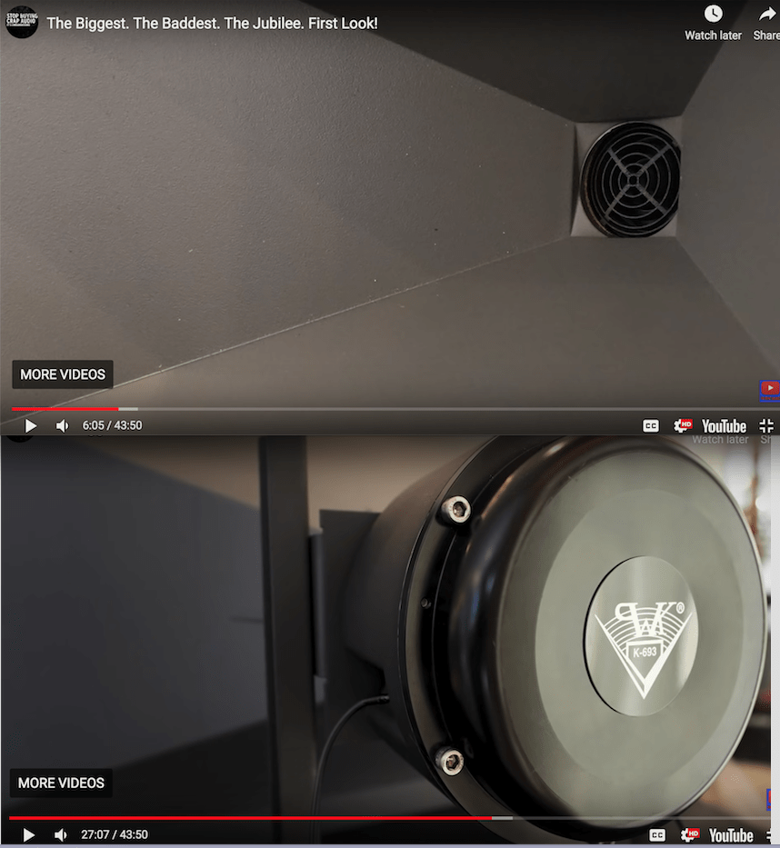

I think that is an interesting question. Klipsch made some kind of horn entry adapter for the Celestion Axi2050 as well. But I believe the function is not exactly the same for the two either.
So the vanes are a bit like aircraft wing profile, but symmetrical. This means they displace a bit of the cross section area half way through. If you look at the profile of the horn, the start of the horn is pretty smoothly shaped. But by displacing some of the area, and then adding it back in, you slow down the expansion first, and then increases it rapidly. This is done in the horizontal plane only, and that improves the dispersion uniformity over a wide range.
The Klipsch Jubilee uses, as far as I have understood, this adapter to improve the integration between the beginning of the horn and the driver exit. Besides making sure any flow is kept laminar throughout the adapter, it is also slightly deeper in the middel. This will keep the expansion of the wave from pulling out all the energy from the center of the wave, but instead allows for more of a collaps along the sides. It really causes the same thing as the vanes, it improves dispersion over a wide range by controling the shape of the wave.

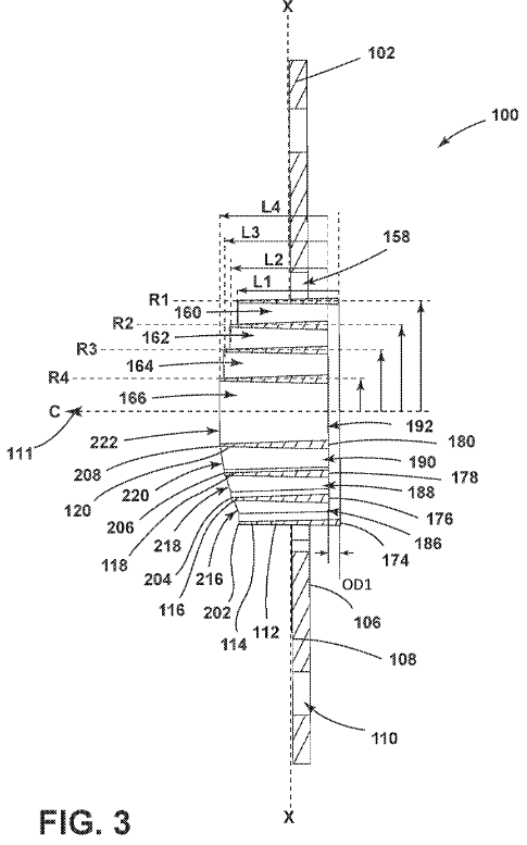

The "phasing plug adaptor" (sic) (US11903728, WO 2022/033953 A1) is there to address an acoustic beaming issue that occurs above a certain frequency that corresponds with a half wavelength of sound fitting across the throat diameter at the horn's throat....The Klipsch Jubilee uses, as far as I have understood, this adapter to improve the integration between the beginning of the horn and the driver exit. Besides making sure any flow is kept laminar throughout the adapter, it is also slightly deeper in the middel. This will keep the expansion of the wave from pulling out all the energy from the center of the wave, but instead allows for more of a collaps along the sides. It really causes the same thing as the vanes, it improves dispersion over a wide range by controling the shape of the wave.
For a 2" horn throat diameter/compression driver exit diameter, this corresponds to the speed of sound at room temperature (~13582 in/sec) divided by the throat diameter--2", i.e., 6792 Hz. Above that frequency, the angular acoustic coverage pattern as measured from the horn's mouth begins to separate from the horn's walls and collimates into an acoustic beam. The "phasing plug adaptor" simply spreads out the acoustic pattern to more closely follow the horn's straight walls for about an octave higher in frequency (~13584 Hz), at which point the spaced concentric rings of the "adaptor" are no longer as effective in spreading out the acoustic output field to the horn's walls, and beaming again begins to occur--just at the same frequency of beaming in a 1" throat compression driver/horn. This transition to beaming appears to be complete by ~15 kHz:
The exact mechanism of this acoustic spreading above the half-wavelength-across-the-throat beaming frequency is explainable from the standpoint of the Huygens-Fresnel principle (i.e., re-radiating wavefronts from the curved portion of the adapter into the horn's throat area, on the left side of the above cross section diagram taken from the patent document). This is the action of an acoustic lens, not a phase plug as used in compression drivers--which are devices that avoid acoustic cancellations across the compression driver's diaphragm area.
There is no "laminar flow" inside a horn, since there is no net flow of air into or out of a typical horn.
Waveguides are typically constant cross-section elongated cavities that carry internal acoustic or electromagnetic energy from an emitter to a horn radiator. The horn disperses the entering energy into the free air field (acoustic) or free space field (E/M), i.e., not the waveguide. What you refer to as a "waveguide", above is actually a horn, (i.e., this is a confusing use of the term "waveguide".)
