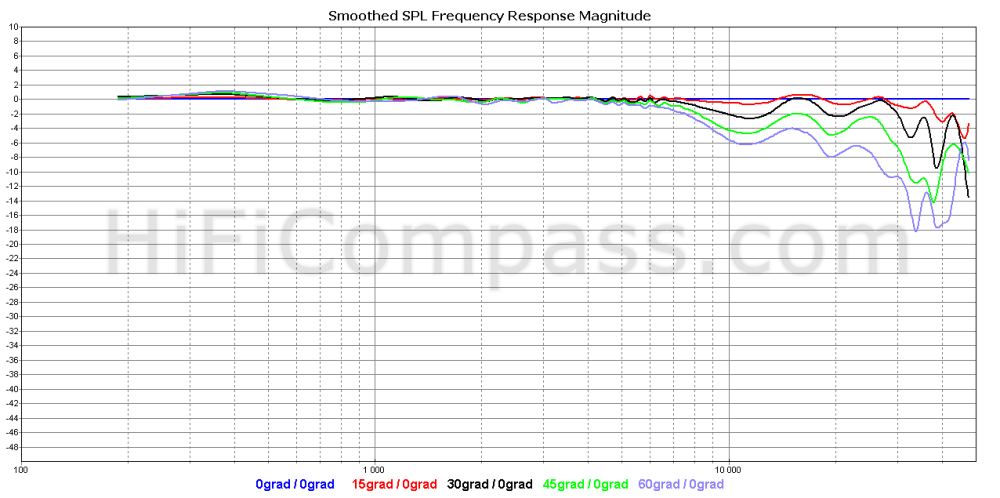

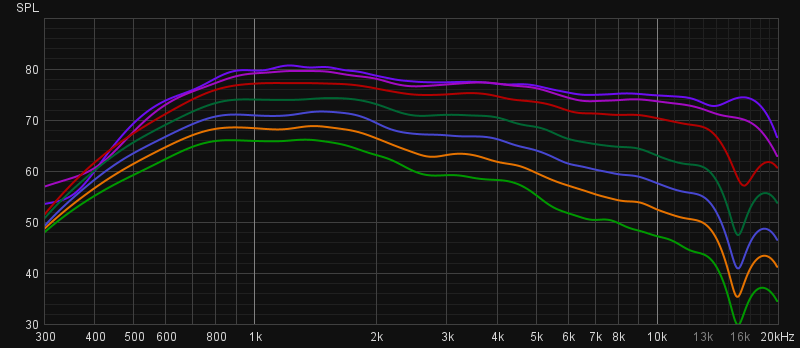

Here are some polar measurements of a 400x460mm horn I have designed. The measurements are done with 18s Nd1480Be. I think those are pretty good drivers, but the plan is to finish a ring radiator design I have been working on to further improve the response of the compression driver as well.
15 degree spacing. No smoothing, only gating. My point is that this type of horn could be used from 750 and would not require a separate tweeter. For example a JMLC horn from 750Hz would not give a lot of air and space at high frequencies, so an additional tweeter would be good to have, regardless of the quality of the compression driver.
Horizontal:
Vertical:

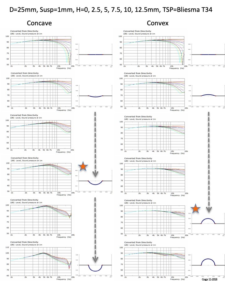

A pistonic small membrane will have a falling FR towards higher frequency. This is physics and can't be argued - and to be clear - the shape doesn't matter - if it really is pistonic.
Shape DOES matter!
Indeed, and this is rarely considered in compression drivers. We also see those spreat tow carbon diaphragms that has promised to solve everything lately, they have so much limitations to how much curve they can be shaped to before fibers start breaking. They do not outperform any other materials as claimed.
Also, the selected material of a diaphragm vs the shape and the phase plug geometry. It will vary across different materials, but you never see anyone change the phase plug when the diaphragm material is being changed.
Could you put some substance behind this claim? And what variation of shape do you talk about between different materials?Also, the selected material of a diaphragm vs the shape and the phase plug geometry. It will vary across different materials, but you never see anyone change the phase plug when the diaphragm material is being changed.
I mean, if the shape of a diaphragm is different than the phase plug, it will be a disaster in high spl environment, sales will be dead in a year…
Off course the phase plug has to fit the diaphragm. That is given by the Venta and Thuras model. But for example JBL 2446, 2450 etc use pretty much the same phase plug for any diaphragm material. Rumour has it that it was first developed for beryllium. But the inner geometry was kept while the final product was released with a titanium diaphragm. They also offer an even slower Aquaplas variant. But the phase plug itself is, as far as I have understood, based on the Smith style. That model is based on a purely pistonic diaphragm, and even if beryllium 4 inch low profile domes are not pistonic, titanium and Aquaplas are even further from pistonic, meaning lots of errors are introduced. And those errors will grow with a slower diaphragm.

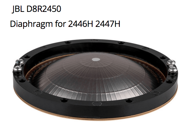

By slower diaphragm, you mean slower sound propagation as in Ti compared to Be?
The transient response ("speed") of different diaphragm materials and their breakup patterns create different time of flight at different locations and frequencies across the dome.
If phase plug path lengths could compensate for those differences, smoother response could be achieved.
Instead of changing phase plugs for each diaphragm material, JBL has opted to try to coax more linear (breakup..) response by stamping in diamond (ish) surrounds, ridges and adding an extra mass dimple at the center, kind of "6 modes of freedom"
Tricky stuff, early diaphragms made this way sounded quite good until the diaphragms turned to confetti, requiring repeated FedEx overnight shipments and early morning cabinet "pit crew" action to keep touring systems alive .
When they got tolerances, surround geometry and rib positions sorted out, both longevity and sound quality improved over the growing pain development era.

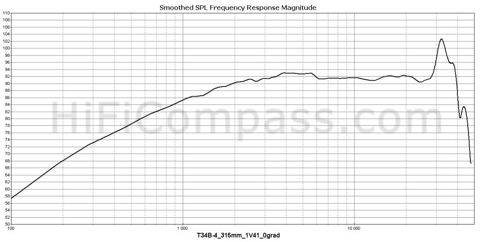

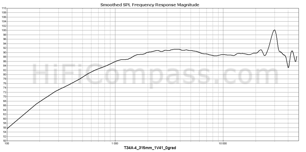

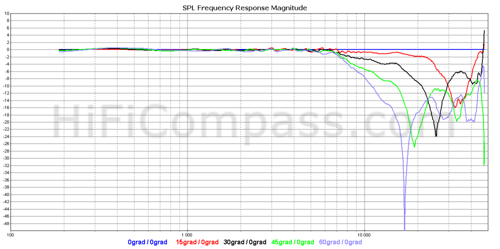

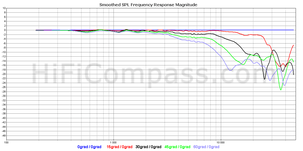

But here are the Bliesma T34 A and B as measured by Hificompass:
Aluminium:
Beryllium:
The two obviously perform very similar to each other, and this is likely due to the difference in shape where the aluminium alloy version has a higher profile and therefore compensates most of the difference between the two materials.

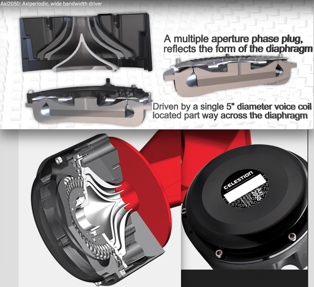

This is quite interesting, and they pulled this idea quite a bit further with the Celestion Axi2050 where a series of domes forms a large ring. Unfortunately, this also has a concentric phase plug.
For those who have not seen it, this video is highly recommended in order to understand some of the stuff that happens inside a compression driver:
Mark Dodd says the Axi2050's diaphragm’s three-dimensional corrugation and its rotational “axiperiodic” symmetry inspiration came from the corrugated Nissen hut roof of the original KEF factory, a thin sheet of material made relatively rigid and strong by bending it in a repeating pattern.
https://www.prosoundweb.com/tech-focus-celestion-axi2050-wideband-axiperiodic-compression-driver/
It is different annular ring approach- I think it will be a long time before aftermarket diaphragms become available for it
