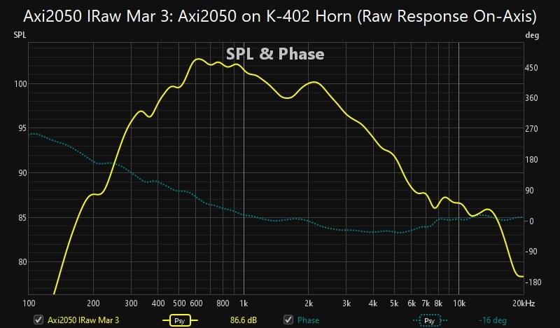

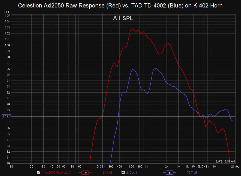

Celestion Axi2050 Raw Response( Red) vs. TAD TD-4002 (Blue) on K-402Horn.jpg

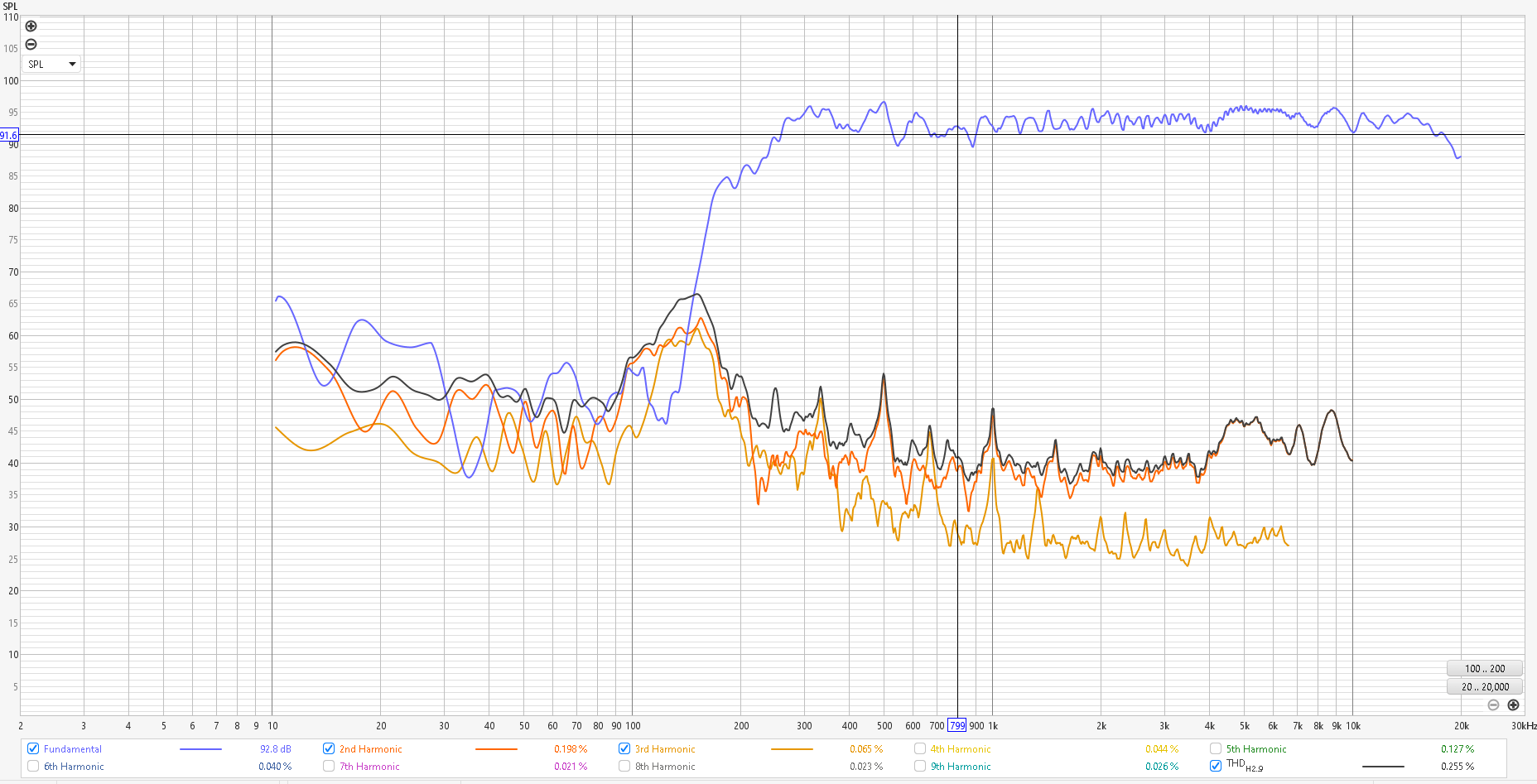

Axi2050 is perhaps the most disappointing compression driver I've ever tested.
What hyperbole! I think most people that actually listen to and measure the Axi-2050 on a K-402 Horn (the only in-production horn that can actually use all of this driver's output effectively that I'm aware of) will have a dramatically different point of view than yours.
You can read about my observations, spread over a month's worth of listening side-by-side with a TAD TD-4002 on the left channel and Axi2050 on the right (K-402s on top of KPT-KHJ-LF bass bins, dialed-in carefully)--the second posted pdf file found here:

They haven't done the comparison I have. There are other people who have come to the same conlusion as me. Thirdly and most importantly; measurements comfirm the rise in distortion. If there wasn't a correlation between measurements and listening, I wouldn't trust my own experience. Perhaps TAD 4002 isn't that great either or doesn't match the K402 horn that well, I don't know.
...In direct comparison to Radian 950BePB where I had one in each horn and did a lot AB comparisons in mono with level matching and similar EQ/tuning over several days, I was surprised how much it lacked in openness, clarity and detail compared to the Radian. It was sort of listening to 4"-5" piston driver - sounds comfortable but completely lack high frequency energy...
In fairness, I can say that the Axi2050 probably suffers more from HF beaming above 6.8 kHz than the Radian 950BePB (Be dome diaphragm 2" compression driver). Put the "phasing plug adaptors" (throat diverging lenses) into the horn/compression driver interface and I think the story is going to change a bit. I know that this device used on my TAD TD-4002s did make an audible difference, and the effect is "not boring"... YMMV.

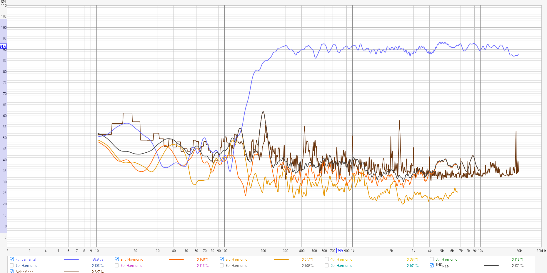

And the I saw in my measurements, that the distortion was high aleady at 700-800 Hz area compared to Radian 950BePB.
I didn't see that in my measurements. In fact, lowering the crossover point to 220 Hz (easy to do with the K-402 and the Axi2050, relative to the TAD TD-4002s crossed an octave higher) actually slightly decreased the harmonic distortion relative to the bass bin HD. I don't think this is a subjective factor that the trained listener could pick out. I listened for a month with a lot of test signals, measurement sweeps and a lot of different types of music (greater than 8 hrs/day, 7 days/wk) and didn't hear anything that I could attribute to HD,

unfortnautely I don't have any outdoor measurements at these levels to share at this time. Its thd is clouded in these measurements
