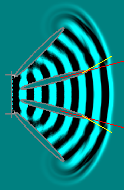

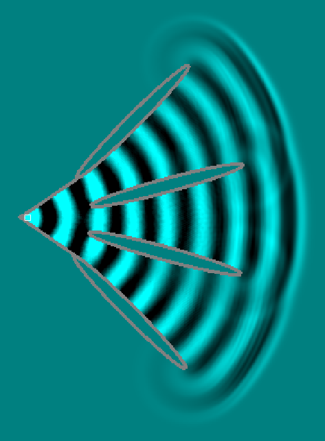

Vanes tend to be problematic for tailoring a wavefront, especially the more they need to achieve.
The OS profile has been found to widen higher frequencies (beyond the source size) with the least struggle.
Here is an example of vanes..
1. Forcing out a flat wavefront,
2. Beginning with a preferred wavefront shape.

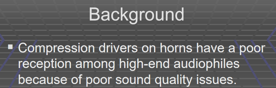

It's in the presentation page I posted. He is the author so from his point of view yes SPL and Group Delay dependent.
http://www.gedlee.com/Papers/Sound Quality Improvements in Compression Driver Systems.pdf

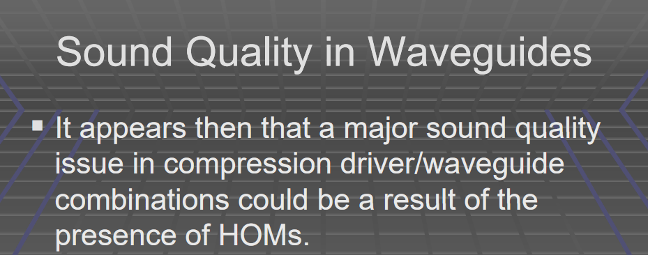

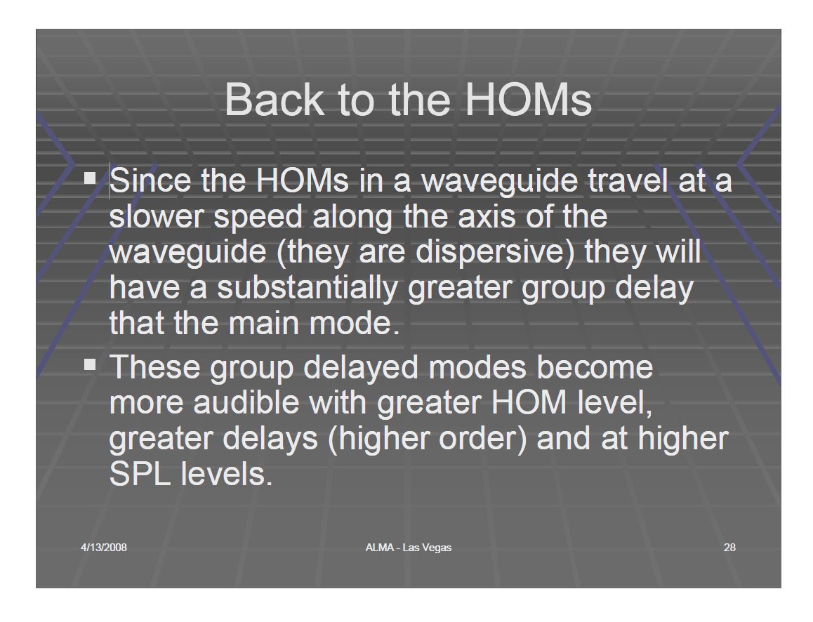

I think it is important to point out that this is in the context of many other pages. On the pages before this, he refers to two studies that shows that group delay is harder to hear at low levels. He also points towards his work together with his wife on harmonic distortion, where they confirmed that harmonic distortion is harder to hear at low levels. I believe this was a very well known fact, one that I also mentioned a few posts ago.
Anyway, he then goes on to say this:
These group delayed modes become more audible with greater HOM level, greater delays (higher order) and at higher SPL levels.
He does not say what he compare these SPL levels with. However, as he refers to the audibility of harmonic distortion and group delay on the pages just before as he is putting this into context, it is fair to assume that he is talking about the levels where these types of distortion becomes more audible. At 110-120-130dB, our ability to identify these distortion types are not improving.
I do not recall who said what, but it was stated that this meant that we would not be able to hear HOM at normal listening levels. I noted that I found it very unlikely that he had actually expressed such an opinion. Here is what I believe we can extract from Geddes' document to shed light on the topic.
Here is what he sets out to investigate:
And here is how he concludes after presenting his findings (and this comes after the reference to SPL):
To me, it does not look like he is trying to tell us that HOM is not a problem at normal listening levels.
I also find it interesting that he presents an OSWG as the answer. I do not know all of his detailed findings, but I had the oportunity to look at some analysis done by Mr Kolbrek, which showed that OSWG was about as bad as a conical horn on this. It was not showed or stated that these horns do create it, but the presence of HOM was huge in these two particular horns while it was very low in a comparable exponential horn. Given all the struggles I at that point had experienced with Seos-horns, it was a bit of an a-ha-moment for me when I saw this.
But as I have mentioned so many times now, this will be driver dependent.

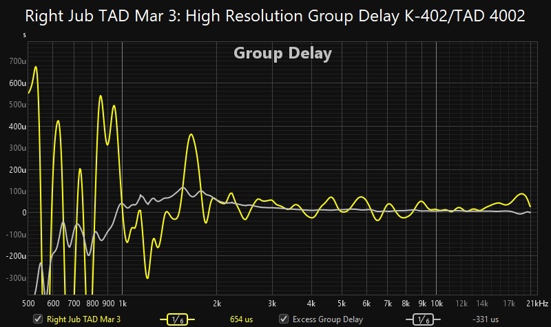

If this is the alternative metric, then where are the high resolution GD plots? I assume that we're not talking exclusively about the excess GD (the leftover GD in excess of the Hilbert Transform of the magnitude response). I can show this data, but it shows values well below audibility levels (i.e., 1 ms, an audibility threshold which is 100 times higher than the typical measured GD):The first property of HOM, described a few posts back, is group delay.

Hello ChrisI've been familiar with that linear distortion audibility metric since at least 2010 (i,e., a long time ago now). The paper itself still begs the question: where are the measurements of HOMs?
I agree I have never been able to definitely "see" them in either a GD plot, as posted, or in a waterfall where I would expect to see it.
Rob
You're not likely to see much looking at a CSD or GD plot as shown.

You're not likely to see much looking at a CSD or GD plot. Perhaps an impulse response..
Hello Allen
Why? You can clearly see the HF break-up modes in the secondary resonance or a compression driver in a CSD? That's stored energy why wouldn't you see HOM's? After all a waterfall is just another way to look at the Impulse.
Same thing with Group Delay? They are defined as group delay so why wouldn't you see it? Again another way to look at the impulse.

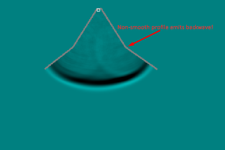

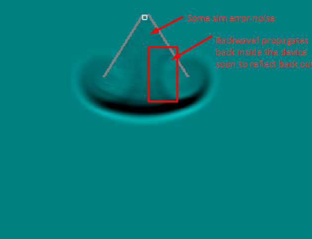

I'll simplify all your lives by saying HOM's are mainly just diffraction related back wave that emits when waveguide profile changes too suddenly and sound diffracts, be it inside the device or at the mouth. The back wave emits backwards where the sound came from, thus back inside to the device, and reflects from inside the device back out.
All this shows up as direction and frequency dependent undulations in frequency response plot. Or group delay plot, as it's sound arriving after direct sound. Now, this shows easily in simulation because the source can be anything ideal so the waveguide contribution to diffraction is clear. If there is more in frequency response measurement it must be from the compression driver, or from junction of the two, and would show up with appropriate delay. So, if you have a waveguide that has proper roll over on the mouth as part of nice continuous profile all the way from phase plug one doesn't see any wiggle in frequency response to any direction up until top octave, where wavelength is smaller than the throat and dominated by what's coming from inside the driver.
If there are some other HOMs in the system, like the waveguide resonating or something, they would not be visible with all the diffraction going on, which is kind of a huge phenomenon in frequency response plots, could be many db. If one makes a diffraction free (relatively) device, and still see wiggle, it should be easy to test and reason what's the issue. If there is no wiggle in frequency response I'd quess there is no HOMs, definitely there is no diffraction then. No matter which profile horn, OS, exponential, no horn at all, if there is no properly sized and shaped mouth rollover there would be a lot of diffraction showing in any plots. Basically, diffraction makes secondary sounds emit from the device, and if HOMs are secondary sounds, I don't know whats the difference in practice, at least they would contribute to similar perception of sound I bet.
As disclaimer, I don't know what HOMs would actualy be, they seem mysterious voodoo like entity but seem awful lot like diffraction. Unlike HOMs seem to be, diffraction is very easy to detect both in measurements and in very simple simulations, it's relatively easy to reason with and happens with any physical objects, also with waveguides.
edit. simplest possible example a "conical" horn
https://www.falstad.com/ripple/Ripple.html?rol=$+3+512+64+0+0+778+0.048828125 s+2+255+21+2+0.46680807839388144+0+10.001413602849373+99.99941507823934+1+0 w+0+207+91+253+18 w+0+306+91+259+17 w+0+253+20+259+20
Same with extension, non smooth profile with sudden change and it emits the backwave as well.
https://www.falstad.com/ripple/Ripple.html?rol=$+3+512+64+0+0+778+0.048828125 s+2+255+21+2+0.46680807839388144+0+10.001413602849373+99.99941507823934+1+0 w+0+207+91+253+18 w+0+306+91+259+17 w+0+253+20+259+20 w+0+365+132+305+90 w+0+208+90+155+131
Click the links to see it happen.
