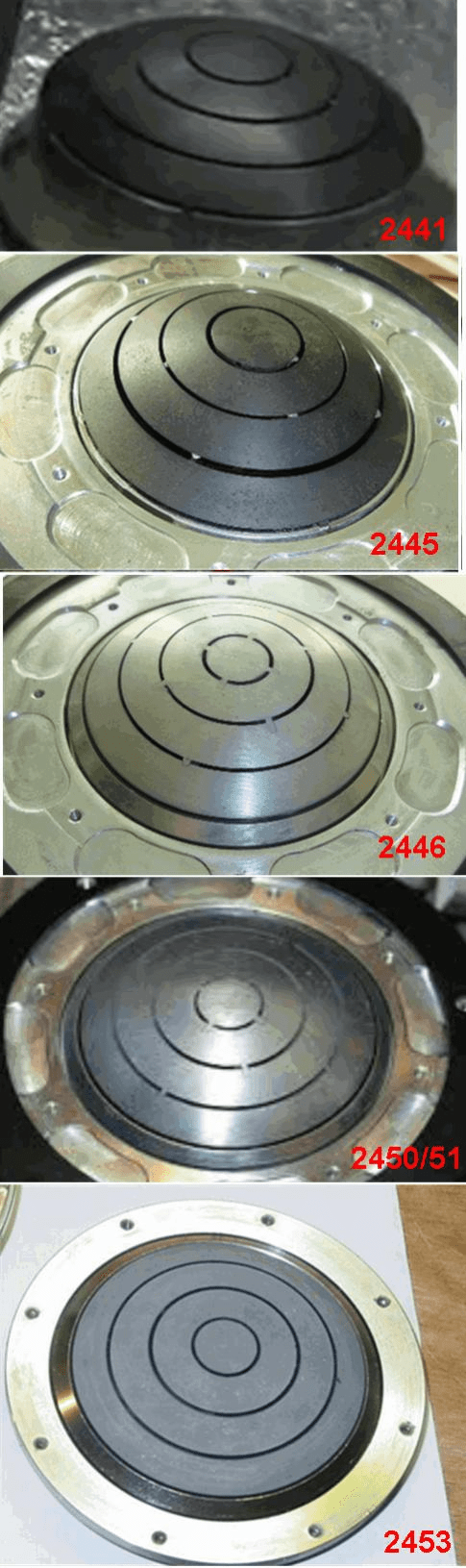

In the driver there are two main sources of HOM. One is any abrupt change in cross section expansion, both negative and positive. The other is what comes out of the phase plug. When modes are generated in the phase plug, it will result in uneven pressurisation after the phase plug at this frequency. These resonances originate in the compression chamber so we can not fully aviod it in concentric phase plugs. However, having more slits (relative to the diaphragm diameter) can move these modes upward in frequency and reduce modes to a less significant level. Also note the difference between different phase plug mathematical models.
As we can see there are differences in the size of the core element, as well as the pacement of the outer ring. 2441/45 is closer to what we see on TAD 4003, and some say they have slightly better bandwidth.
I think the main takeaway is that phase plug geometry matters. But radial phase plugs are not a walk in the park either, as they do not very effectively control the distribution of pressure in the exit as it all comes out in a single wide slot.

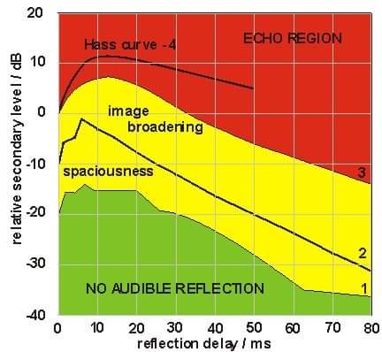

with this said, an anechoic chamber would give the clearest view of direct sound, regardless of the being impractical, it exposes the truth. How much meat you leave on the table is up to you.
There is a concept named "non environment room" which I built in my listening room. "It exposes the truth" is a good description ;)
https://www.soundonsound.com/techniques/sos-guide-control-room-design
edit: here an interesting graph about time and power of reflections and how we receive them:

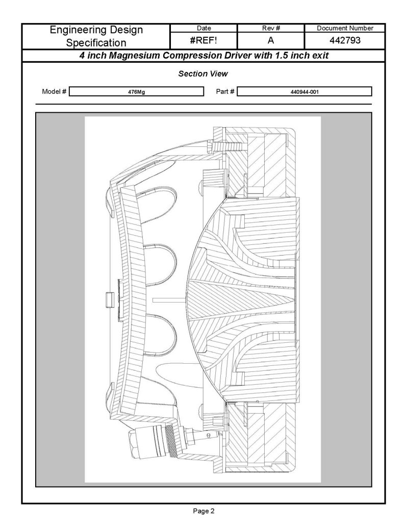

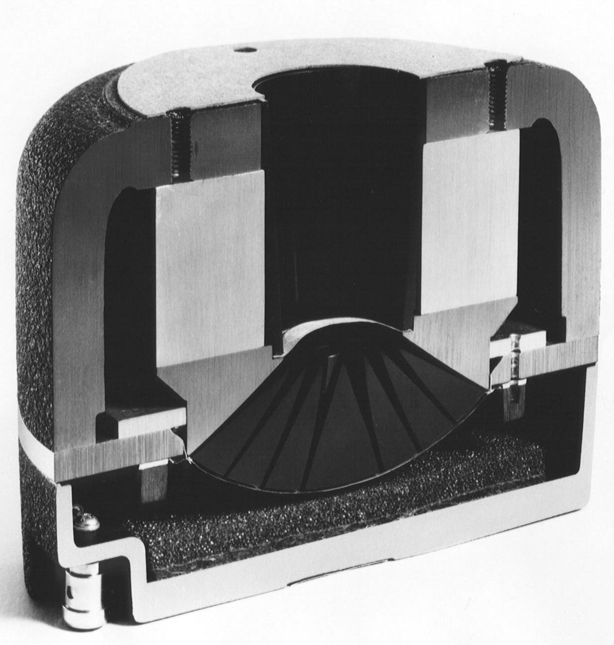

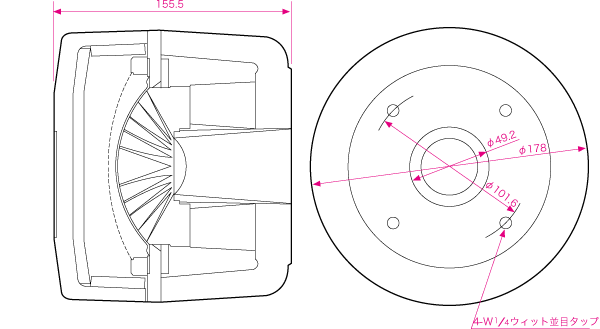

Hello
Why are you not looking at the termination side, the exit at the horn attachment to the driver ?? Tad uses a 5 slit JBL 4
You have 2 completely different phase plug designs shown. Traditional from the say the 1930"s 2441,2445 and modern from the early 90's Concentric Wave starting with the 2446 and carried through to the 2453. The 476Mg uses the same phase plug.
You cannot compare them based on ring spacing alone or make any valid comparisons. Look at how different they are terminated horn side.
Rob :)

Hello
What do you mean? I mentioned both the horn side of the phase plug and the interface between the horn and driver, and I mentioned the importance of the number of slits. What exactly are you missing?
Rob :)
