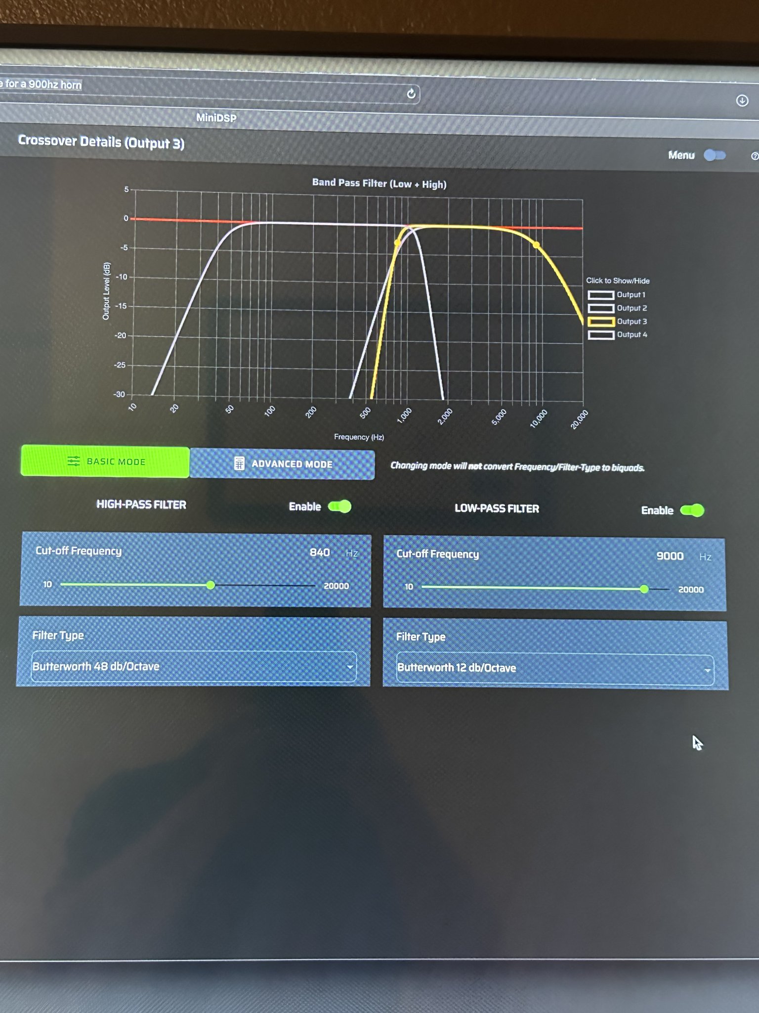

I picked up a pair of used BMS 4594 drivers- and tested it on a B&C Horn - and MiniDSP active crossover. No matter what I did it just sounded tinny and shrill- no matter where I set the crossover points.
Any idea what I might be doing wrong?
I’ve ordered a Dayton Audio active crossover and a different horn- but would love your help on proper set up.
Thanks!

Thanks for the advice all. I've got a Dayton Audio Active Crossover coming to try out. The MiniDSP Flex I just can't get the settings to work. I crossed over at 7000 and just sounds horrible. Even bought another more entry level compression driver and it also sounded horrible. I'm beginning to think it's a faulty MiniDSP Flex.
You say you crossed at 7kHz but you don't mention doing any EQ, or what you based it on..
I’m super new to the hobby so still learning… I had turned off PEQ and FIP on the MiniDSP and was trying to just start with raw crossover settings:

If you are setting the standard fixed crossovers which have equal and opposite slopes for each side, you are not giving yourself any control over the natural variations between sides, nor their own unevenness. They don't start out as flat lines on a plot.
Eg: the tweeter might start out louder than the mid. Maybe the mid has an upward tilt in its response. Then there's the resonances for the parametric EQ you mention.
While it's usual to measure these, you could at least guess for now. Does you EQ allow you to make global adjustments? Can you do tilt? Shelving?

Oh, I'd I strongly advise not to form any opinions or get discouraged by what you hear, until you can get levels right between the CD sections, and between rest of speaker. Then you can begin to EQ sections and play with xover.
Start by turning down the compression drive level in miniDSP. Turn it down until it starts sounding like music. Easy. You might need 10-20 db of lower level for the CD before it comes into normal territory. At least this will help you get closer to what you need and you can enjoy some sound. Then keep learning about crossovers, EQ etc.
