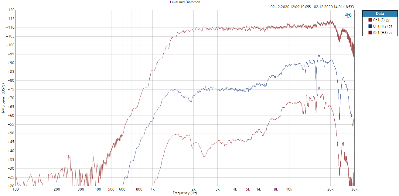

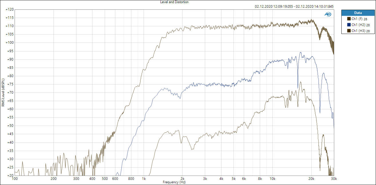

Here a measurement of DE360 red and BMS 4544 blue. While going deeper many BMS show that peak in the 18-19kHz area. B&C used a harder material for the membrane and doesn't have that problem, but needs to be crossed over higher.
That's mainly H2, H3 is actually a liiiittle better with the DE360.

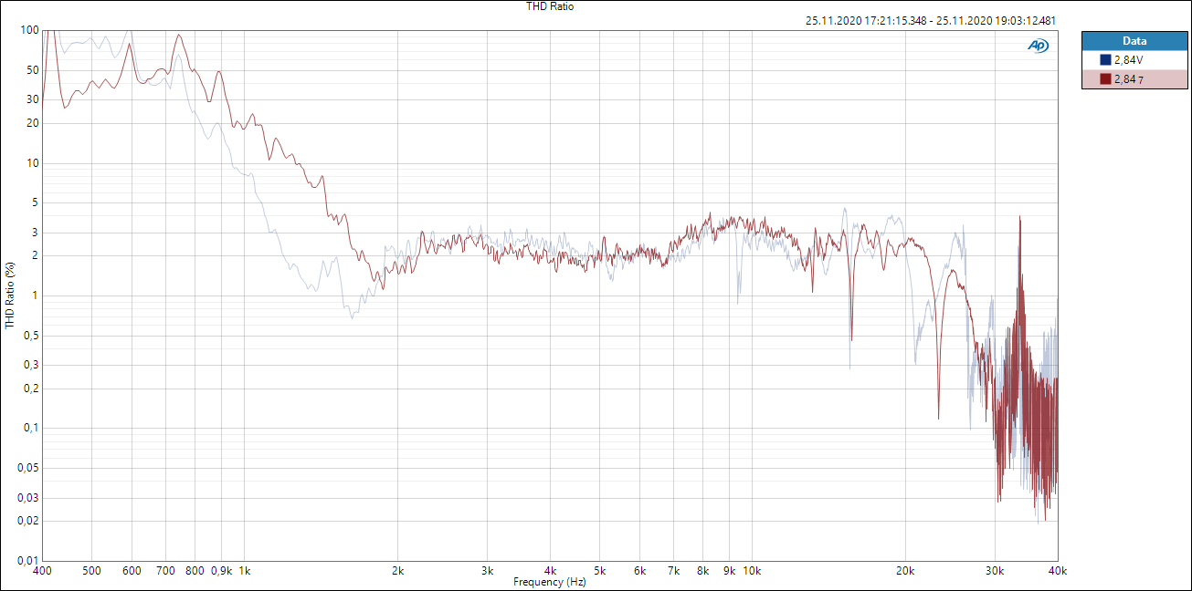

Ähm - why use a compression driver for 80dBSpl? Just use a tweeter with waveguide?
At 90dBSpl/1m it crosses 1% THD at about 1,3kHz. With the 0,1W or less you need for that level you will never destroy it. So I would say yes.
I cross at 1,8kHz for home cinema and this speakers can go loud!

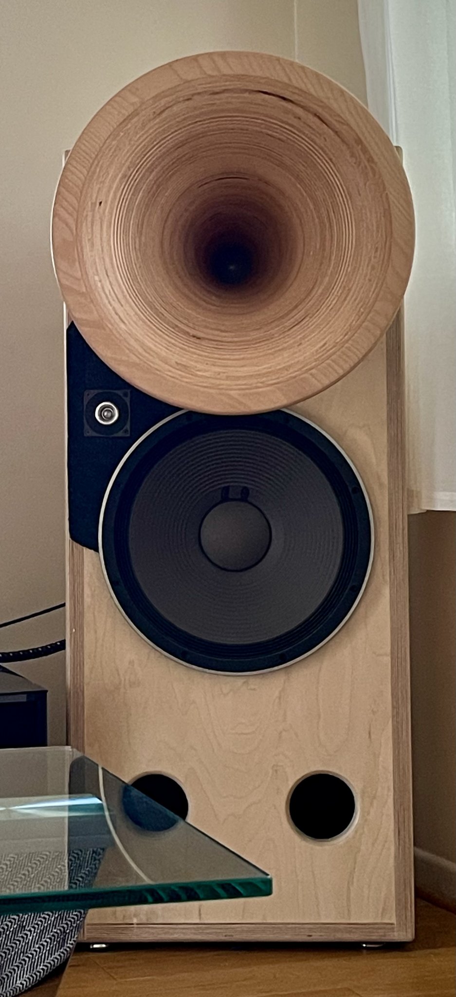

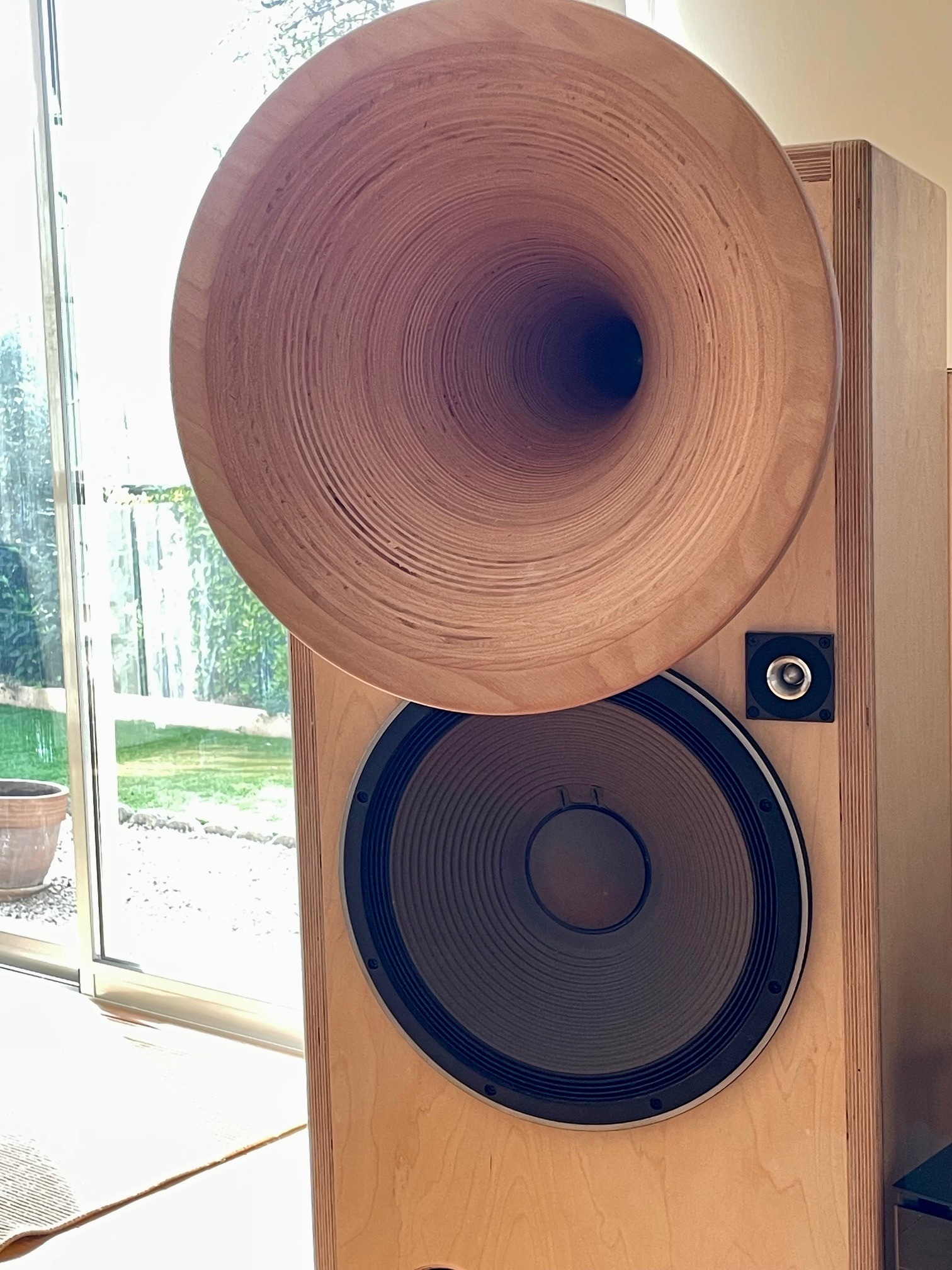

thanks for the review , i have bought a pair of B&C DCM50 to compare with my RCF 850ND 2.0. there are both different beast , the RCF as it is a 1.4inch driver with a 2inch adapter is better on the top and can be listened to it without the need of a tweeter . and on the orher side the B&C DCM50 is very smooth ( some will find them too smooth ) less clean on the fine details compare to the RCF but with my 220hz Tratrix horn and needs a tweeter after 8K but i can push them very low ( 380hz) and their tones match perfectly with the Tad woofer. as i am in 3 way now with a nice little Fostex T96Htweeter . iwill keep the B&C as for me the difference in the low crossover ( 380hz versus 500hz ) is what i prefer vs more details and extension.
notice that unlike the RCF who are pretty flat from 500 to 15K the B&C DCM50 requires some pretty big correction +4db at 3.5khz and -4db at 1.2khz to get flat ..
( P.S the RCF850ND 2.0 are on the swap meet )
the T96H tweeter is really small ...
Do you have any diffraction issues with the large Tratrix horn extending outward and the small Fostex tweeter that's mounted behind it?
it 's a compromise as usual ; i have tried different position and crossover point and to put the tweeter just at the level off my hears was the best for the fusion of the voices . i only listen at the center of my speaker so i can't tell about off axis respons .. but a flat respons is not enough to make it dissapear it really needs to be adjusted in delay and phase . crossed at 11K it doesn't pass much of music when you listen them alone ( i'm 50 years old) and with the RCF 850ND i really don't need it but with the B&C it adds some sparks and air missing..
I have put some foam around just to test ..
