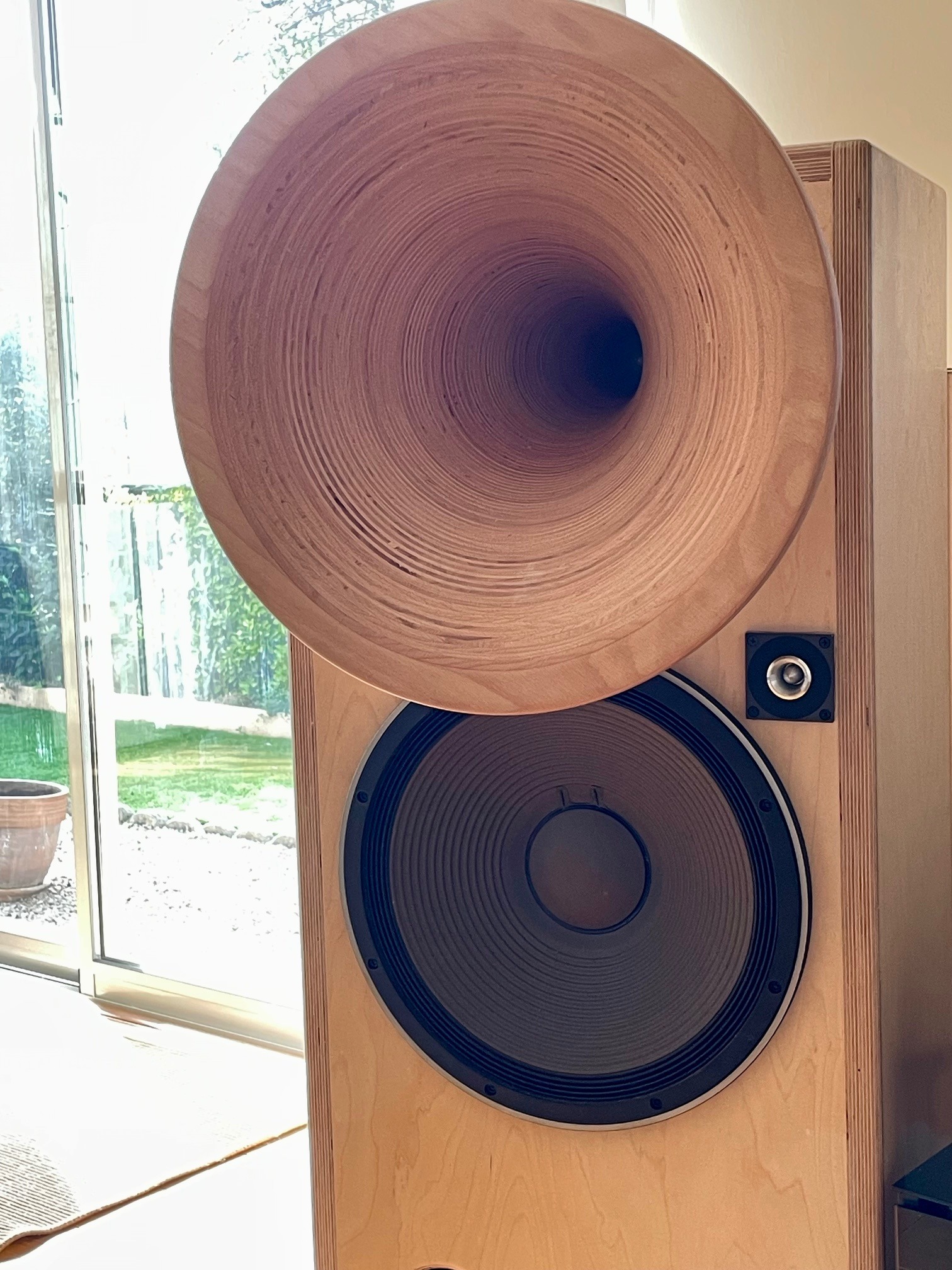

What if I used that wood waveguide at , say, 5kHZ on up.....would it be effective? If not what is the minimum high frequency that you would use that particular wood waveguide, where it's benefits would outway its somewhat restrictive high frequency dispersion characteristics?

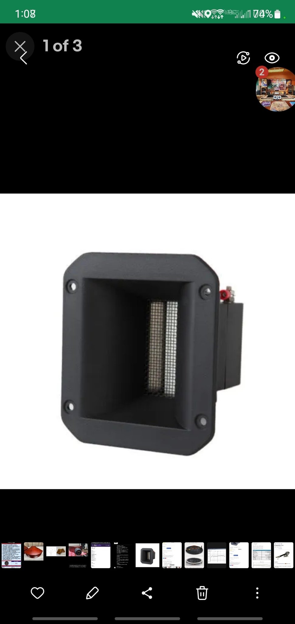

PS: What about this ribbon tweeter from 5kHZ, or higher? It's rated at 95.5 db.
The wood waveguide was pretty deep - you could go quite low (maybe 1.5 kHz) with it but it would depend on your desired high-pass result.
CAUTION: the photo of the actual waveguide is NOT symmetrical (near the CD entrance), I wouldn’t trust that manufacturer at all.
Yes you could use the reinforced ribbon w/ waveguide (prob. >4.5 kHz), though beware of diffraction on the low-end. Note though that horizontal dispersion is still very much limited when comparing to the Beston planar (though this could be useful for integration at lower freq.s for matching dispersion character). Note: I have recommended this driver before for a lower high-pass filter w/ a 2” exit & waveguide combo.. It really needs a modest “box”/“container” that has generous roundovers (sides) and could benefit with some 30 ppi foam pads over the vertical “mouth” of the ribbon’s waveguide.

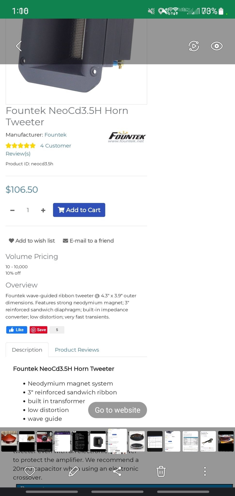

When you say you have "recommended this driver before, and it needs a self contained box with round overs, and vertical pads on the horn opening mouth" (on each vertical side of the ribbon itself..correct?)...are you referring to the pictures of the ribbon tweeters I sent you?, or the one you originally recommended to me ( the Benson ribbon that's on sale at the moment)??
Thanks again....
The Fountek (it’s a ribbon, the other is a planar)
-though to be fair the planar should also be mounted to a baffle/”box” with appropriate round overs but it does not need foam on the vertical edges.
Note: regardless of price between the two I would pick the planar for a super tweeter (>8 kHz). It’s going to give you a bit more “air” and detail up “top”. The ribbons will be quite a bit better below 9 kHz.

Thanks Scott....at the moment am using a Celestion Axi 2050 , CD, X AT >550 , loaded into a Yuichi A290 clone , up to approximately 10kHZ, and then the FOUNTEK ribbon at
9500 kHZ....
So far really liking this combination, however there's still a slight ( very slight) lack of air/ambience-detail, ....so perhaps the Beston will work out a little better .....
FYI, using double JBL 2235's , per side in the bass bin.....and the overall results are pretty impressive.
The only concern with the planar ( Beston) is the lower efficiency ( 92 db versus 95.5 on the Fountek ribbon). I guess I can just raise the gain levels on the super tweeter to match the rest of the system ( using DSP.. DBK DRIVERACK PA 2).

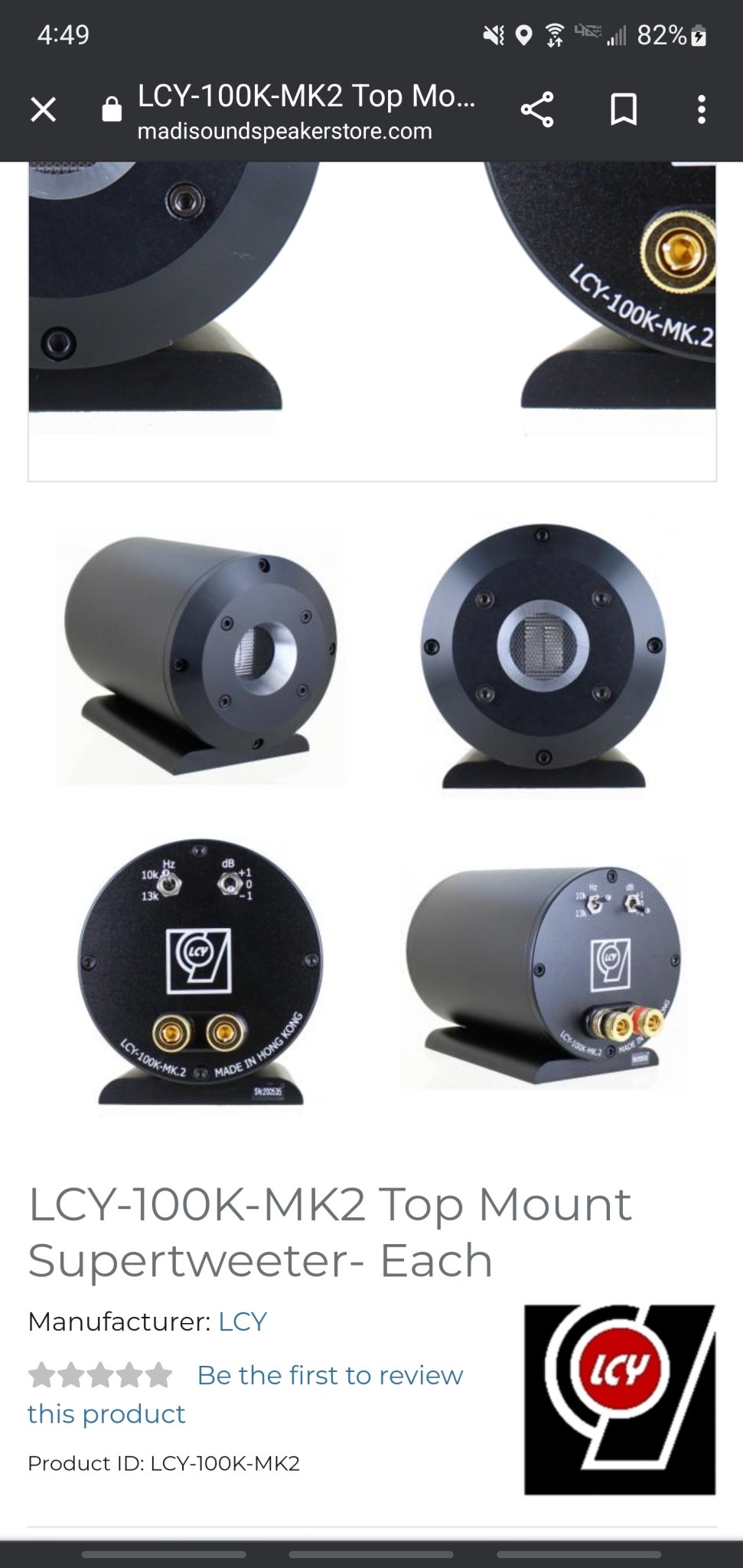

Anyone have any thoughts on this as a supper tweeter? It's rated bandpass :
7 kHz to 100kHZ (??🤔)
95 db efficient
Supposedly works equally well in Vertical as Horizontal.....
Pricey though ( $1100 a pair)

No idea about that super tweeter, but why pay for several octaves of response that no human will be ever able to hear.
