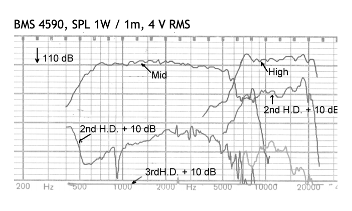

You already have two good 1" compression drivers, and a new-tech 1.4" CD would have a falling SPL above 15kHz. Have you given any consideration to experimenting with a 1.4" exit coaxial compression driver like the BMS 4594Nd-E or B&C DCX464 which measure well between the 400-18.000Hz range? They cost between 500-600Euros, but could provide an excellent in-room sound with fewer/simplier bass and subwoofer. The fiberglass SEOS24 horn(24" wide. 1.4" entry) measures well over this range, and you might find a used pair around your country.

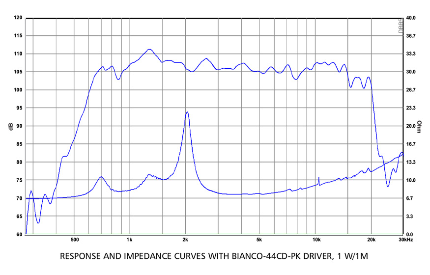

SB Acoustics new Audience line has some CD's (and horns) that look nice.

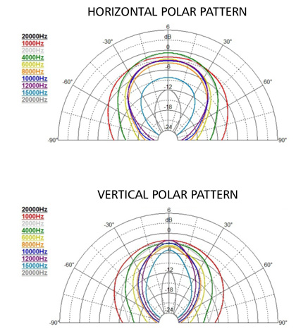

Here's the BIANCO-44CD-PK on their H250 horn....

I'd be ready to accept the fact that my horns have to be pointed at my listening position for what i get in return (point source from 300Hz with acoustic centers aligned at all 3 axes, no breakup at +10kHz characteristic for most 2" exit non coaxial drivers).

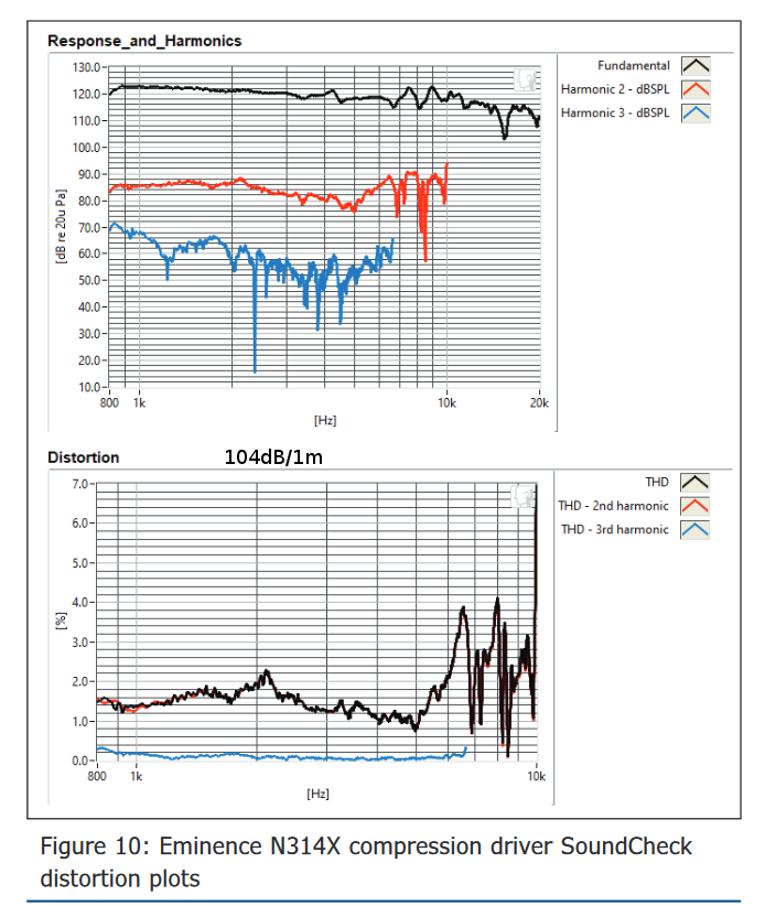

The Eminence looks good. I will have a look at the ND-350.

Regarding the Eminence...
I suggest waiting for independent test results where we can see frequency response graphs that aren’t smoothed. It appears as though Eminence has used 1/3octave smoothing which completely erases dips and peaks caused by resonances. It might sound good or it might not. There’s no way to tell from the published data.
