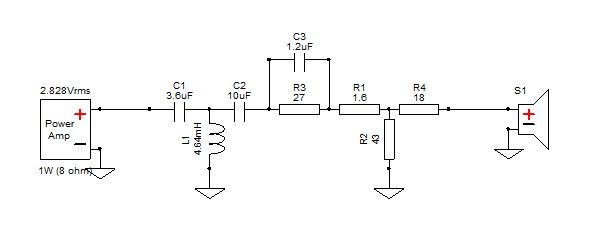

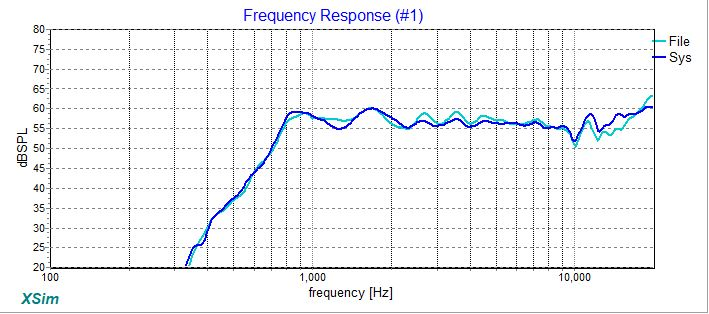

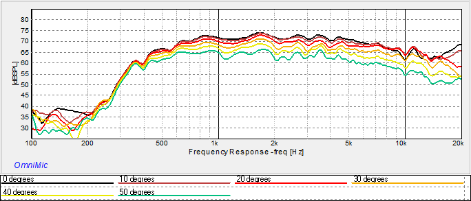

I have a pair of JBL2445 and I like the midrange, but cannot really get a nice top end out of them.
JBL 2445 on 2380A, no EQ, no crossover, 1/12th smoothing, 4ms gating @ 0.8m....
attachment.php
Sample 1&2 with crossover....
attachment.php
Crossover....
attachment.php

LineSource: The 2445 has very nice midrange, but I yet have to find a good way to integrate it with a HF horn properly. I had some success with using an identical horn for the HF and I am experimenting with Karslon-tube inserts - which kind of worked, too. The virus lockdown has really slowed down some custom deliveries, so I am basically stuck at the moment. The DE500 is good, so is the Beyma. I would like to add a third pair of drivers that would be an improvement to both - polymer or Ti with polymer surround diaphragm, but with a better behaved top end than the CP385Nd.
For DSP, I have two T-Racks DSPmini 4x4 (great but needs a bit of effort to set up) and for quick setup and experiments a Driverack PA. These are definitely not the weakest link in my setup at all. The recommendation of HF108 is noted. My setup is most of the time 4 way - with bass horns and midbass horns below the midrange and HF horns.
Mazza: I actually have now the 2445s set up with an 15" mid-bass and DSP equalized. While enjoyable, the top end can be improved. It is not unbearable, but once I tried a nice tweeter horn with them (even with all its problems), there is no way going back🙂
