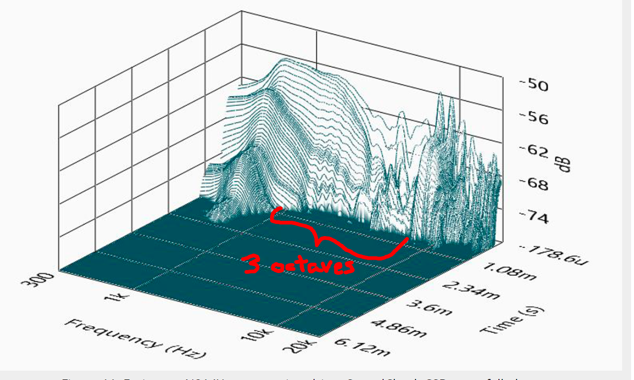

I suggest waiting for independent test results where we can see frequency response graphs that aren’t smoothed. It appears as though Eminence has used 1/3octave smoothing which completely erases dips and peaks caused by resonances. It might sound good or it might not. There’s no way to tell from the published data.
Test Bench: Eminence N314X TeXtreme Compression Driver | audioXpress
It looks like there is serious breakup starting at 7kHz. That's less than 3 octaves of usable bandwidth (if using for hifi). The literature says "Audiophiles prepare yourself for goosebumps". It's not often you see that kind of marketing hype in a compression driver specification sheet.
The break up mode of the TeXtreme diaphragm depends on the the weave.
Thus the claimed "extended response" is indeed nothing more than a series of controlled resonances that may appeal to some audiophiles, but true to the original signal it ain't.

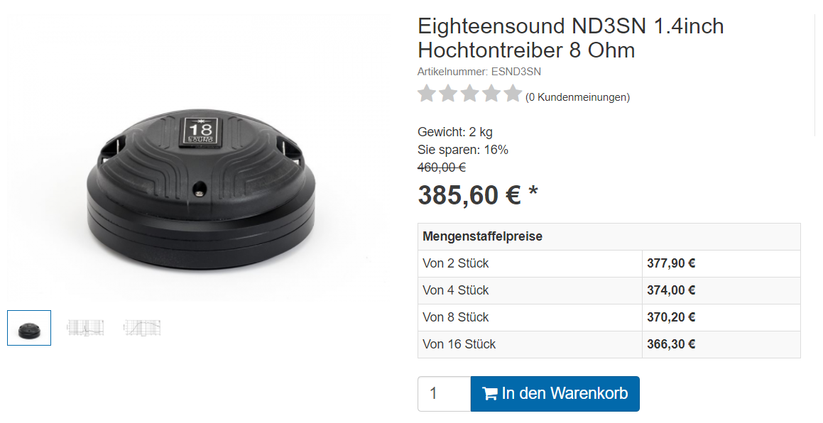

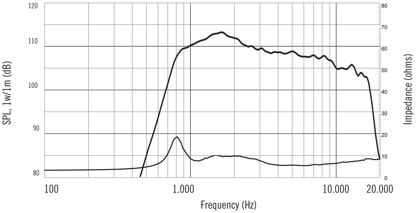

Eminence used to offer decent value for money, but nowadays their drivers are often more expensive than similar products of high-end brands, at least on this side of the pond.
For example, the excellent 18Sound ND3SN costs about the same as the N314X-8.

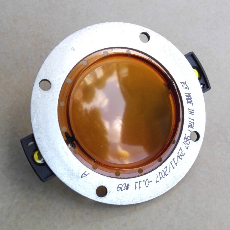

Its higher priced brother (ND350) - with Polyester dia - doesn't work below 1500 Hz, unless you force it.
The RCF ND340 with Polyimide diaphragm delivers about 3dB more output at 1000 Hz and therefore appears to be better suited to low crossover points.

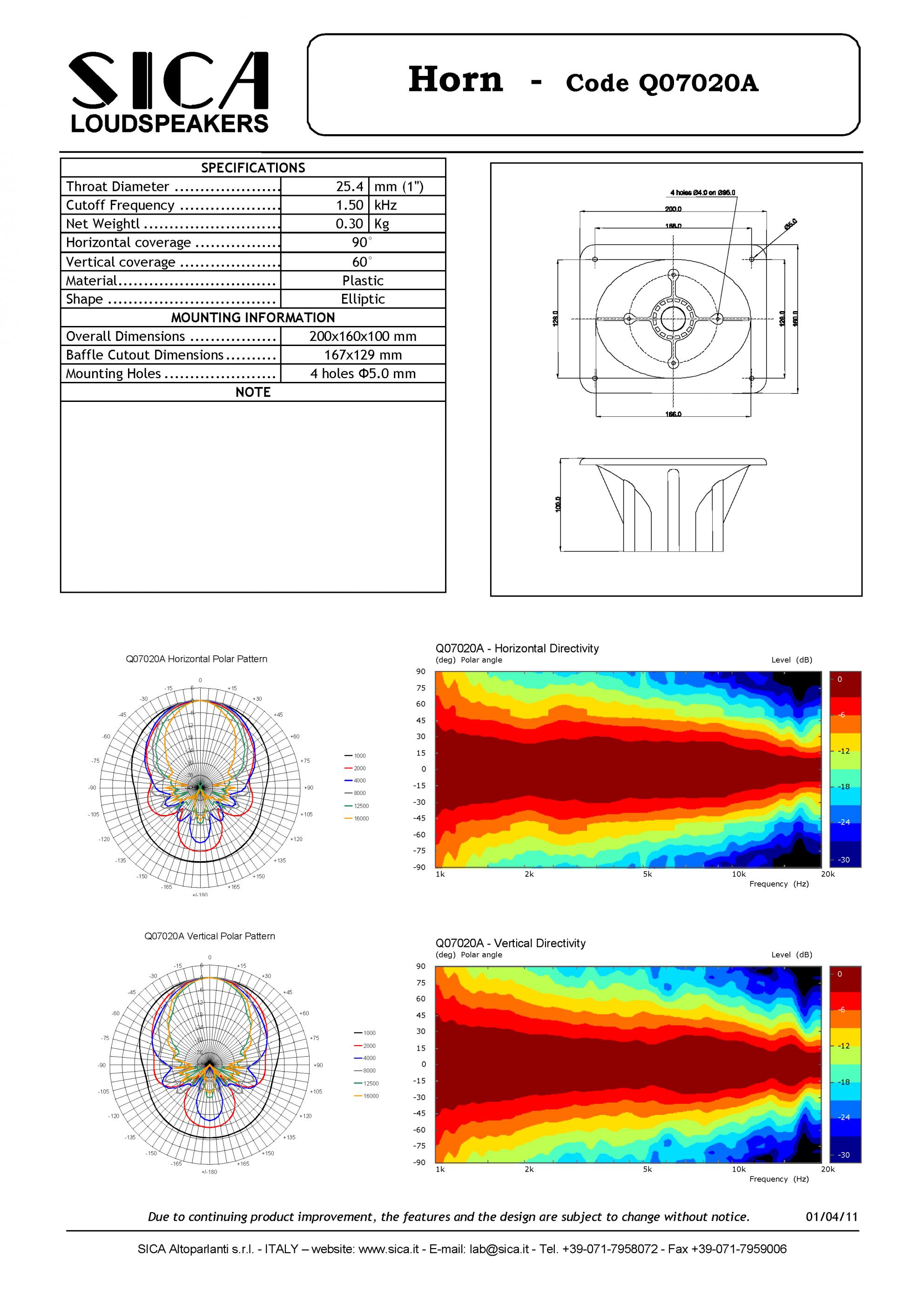

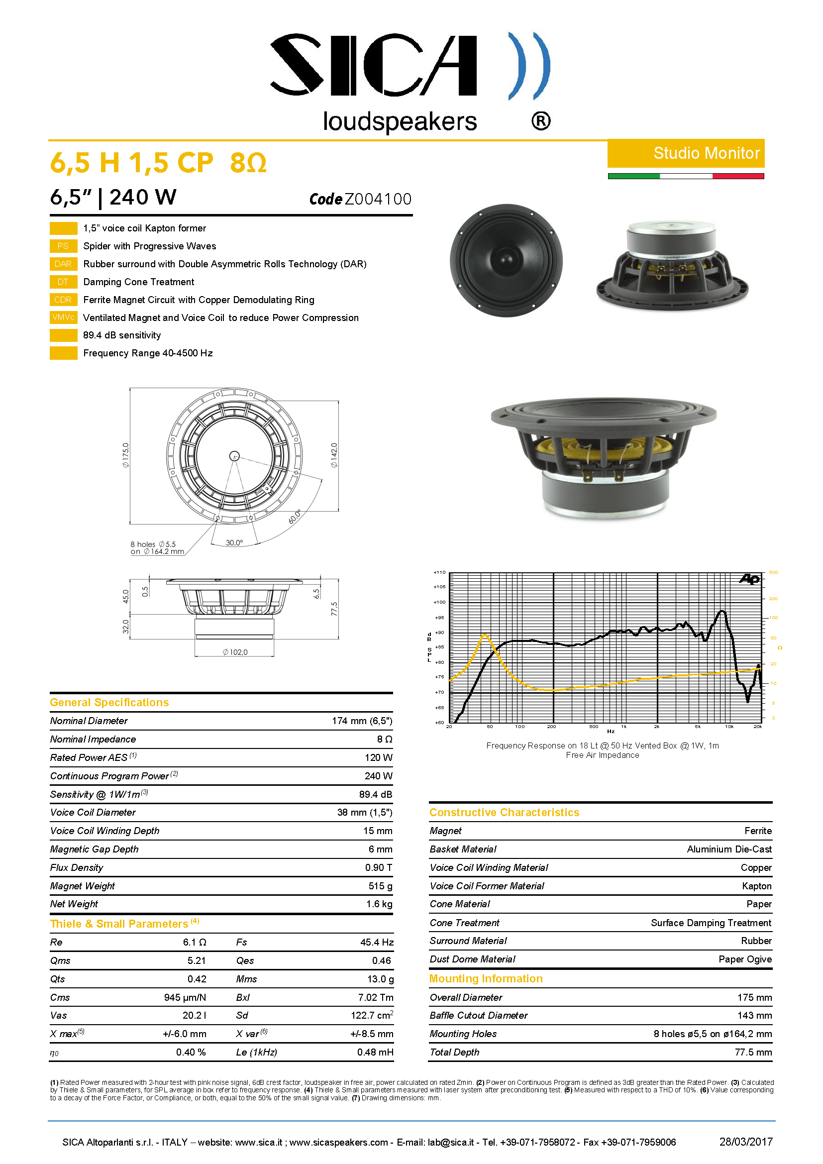

The CD78.26/245TW in combination with Sica's elliptical horn and 2, or 4x 6.5H1.5CP woofers are ingredients for a small MTM or 2.5 MMTMM (XO ≥ 1.8 KHz) that goes down to 30-35Hz in a mid-sized room.

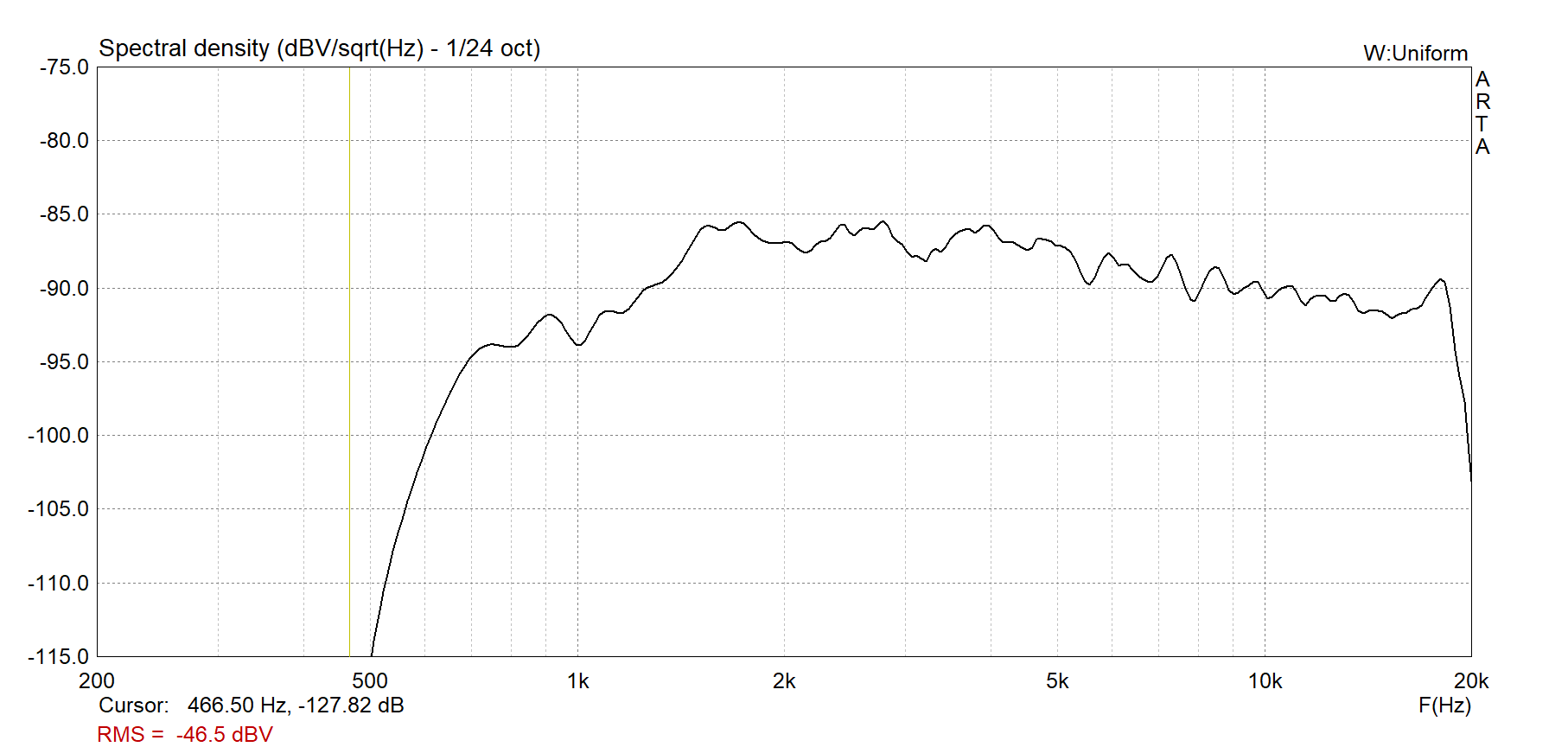

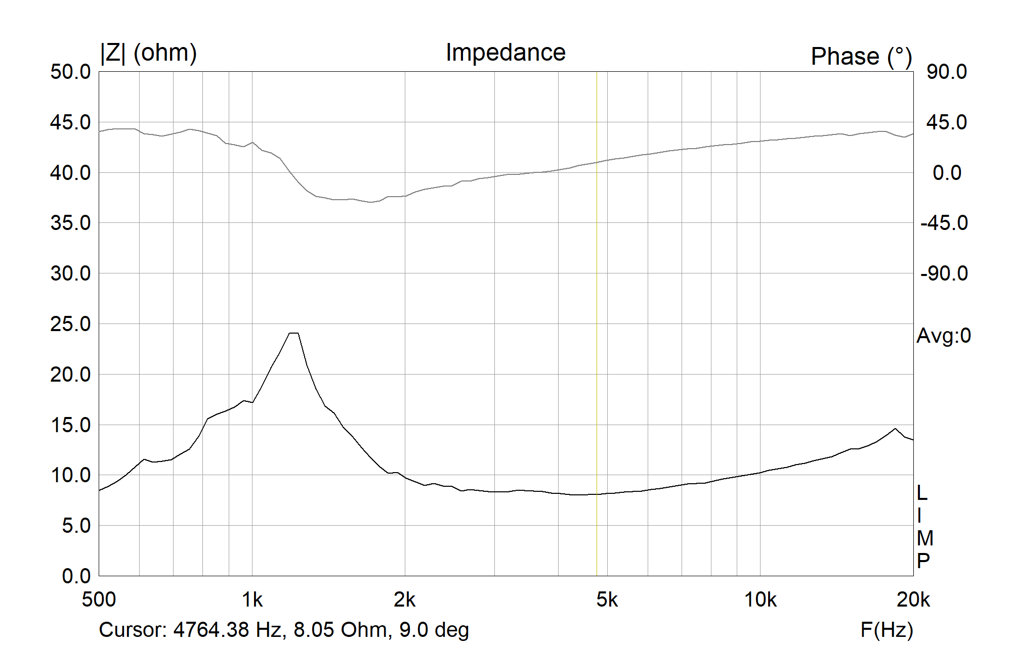

recently acquired a pair of cdx1747 with their H1-9040P horns, below a few gated measurements I've made (earthworks m30 mic) impedance with horn installed
also each driver tracks one another very closely.

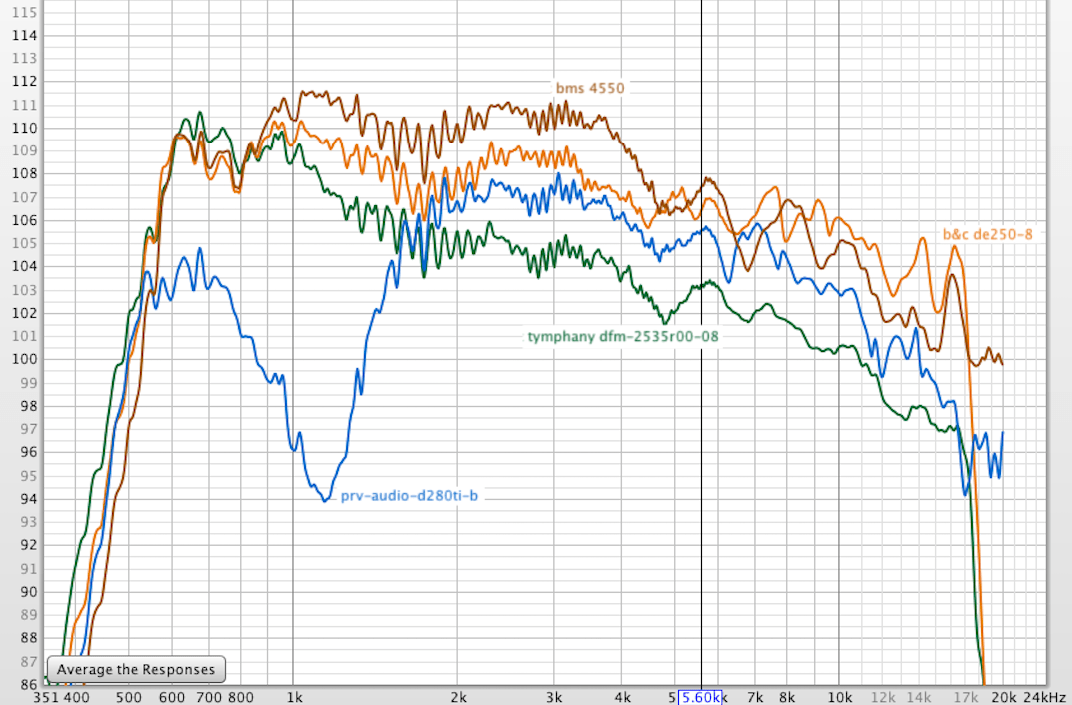

Pelanj, I did a quick measurement of several CDs with the same horn awhile back that included a couple budget one. It was measured about 12" from the horn surface I didn't know exactly. FWIW here's the data.
The PRV audio 1200 Hz "hole" is very odd!
Found it interesting that the 600Hz level was identical, and 600Hz to 1kHz response within 2 dB, while level above varied by as much as 6dB.
1hiep0 DH812 horn:driver 12%22 tests .png
At 12", a little position difference can make a fairly large frequency HF response change with an exponential horn, how similar was the mic position to the horn center axis for the tests?
