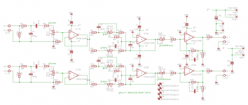

Thanks Julf differential inputs of opamps have been misused for a long time as balanced line receivers and mixers. The circuit above is doing it correctly.
Can you educate us by explaining why you think using the differential inputs of an opamp is incorrect? After all, if you look at what is inside the opamp, you basically find a 5-transistor version of the input stages of your circuit.

Julf, sorry to keep you waiting, will now introduce old new style, lets assume two errors (theoretical), one an inversion of the other come in from the balanced source, what happens next ?
If above holds then we should be able to get better measurements or better sounding experience
How important is it ? You decide
But then there be mongrels like P1, but is it the best of the worlds ? You decide
If the error is differential (one an inversion of the other) and comes from the source, it is totally indistinguishable from the actual signal, no matter what your circuitry. Differential/balanced only helps against common mode noise/error.

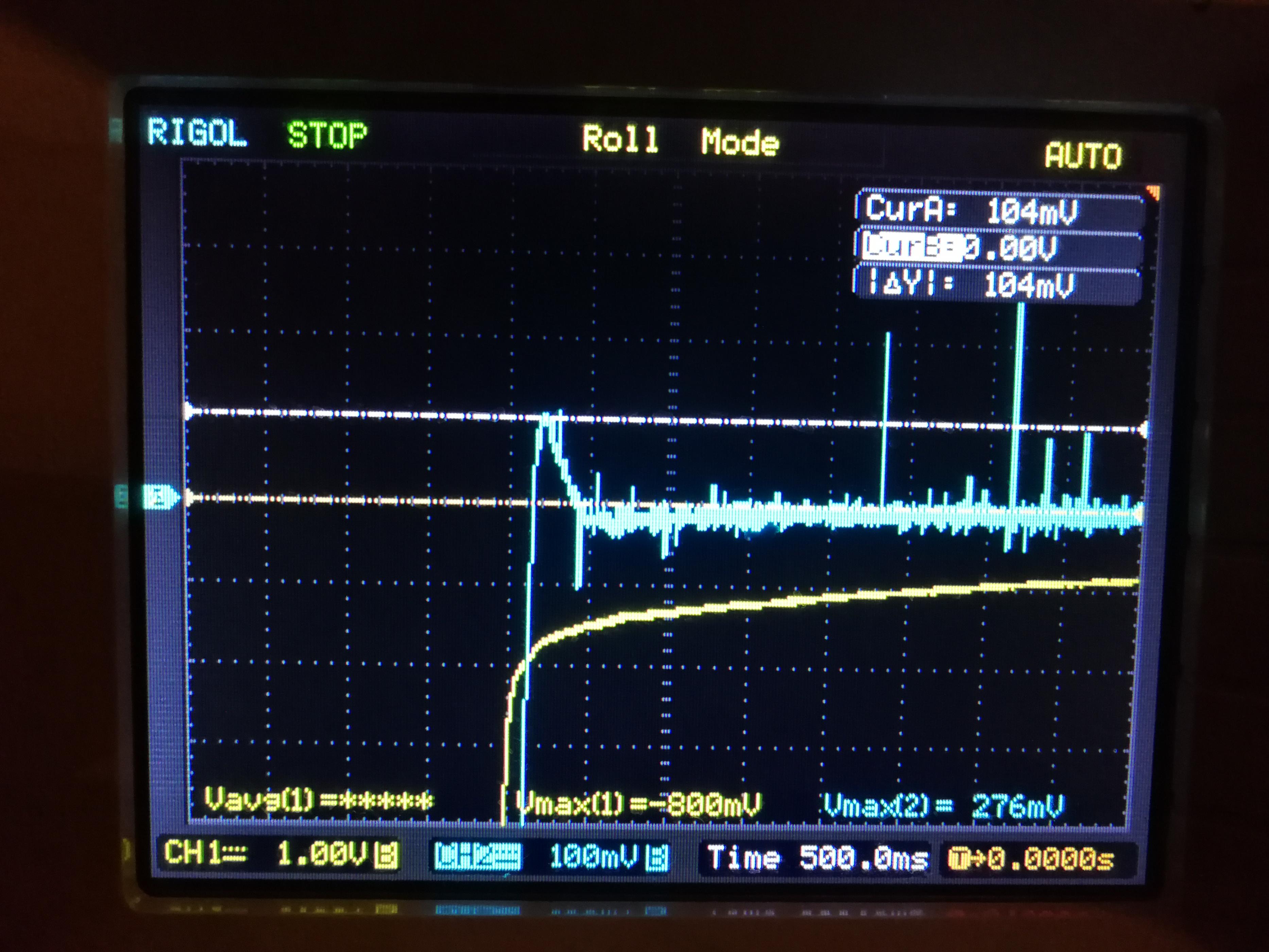

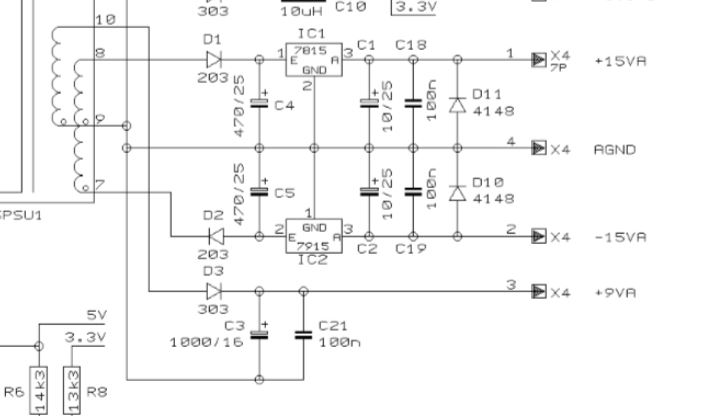

Guys, I'm in desperation. Trying to troubleshoot turn-off thump. Tracked it down to -15V rail going positive (!) briefly after shutdown, which in turn causes opamps to go crazy. This seems to be PSU related as it happens even with DCX mainboard disconnected. I've checked all caps, diodes etc. The only thing I haven't tried replacing are the regulators themselves. Putting Schottky diodes across rails (as per schematic) helps in that the bump is decreased but is still present. The bump increases with capacity before regulators, so it seems something is discharging very inappropriately.
Attached is a screenshot from my scope, yellow trace is voltage before regulator, blue - after. This is with 100uF caps before regulators so the bump is relatively small.
Also included the relevant portion of PSU schematic for reference.
Any ideas would be greatly appreciated!

But isn't there a mute function in the DCX that shorts the output when switching on/off? Was that disabled?
Unlikely that replacing caps and diodes will change it, it's an interplay of supply rate of rise and the load currents required by the various circuits. The only sure way is a mute circuit.
