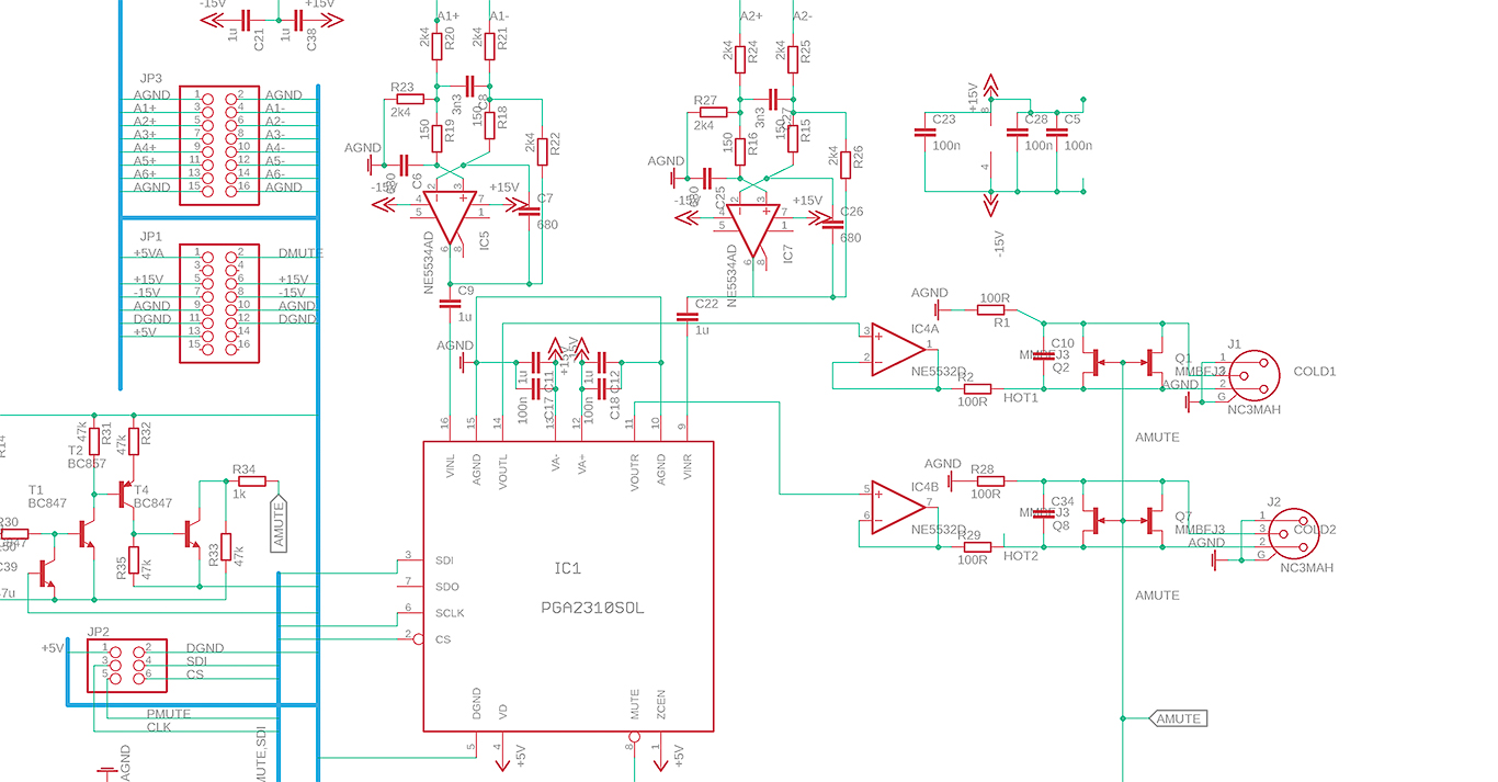

Are those really 1N4148's on the supply rails as shown on that schematic? Those don't have much of a forward current rating when they need to do their jobs. The one you need may have already opened up.
Maybe a 4001 in those locations instead?
The mute circuitry sits a little further to the left in the analog output portion of the DCX. You still have a single-ended op-amp and the differential generating section downstream.

Which I might do anyway but I'm more concerned about possible damage to ICs due to supply reversal in principle, especially if I put something like PGA in the signal path.
Yes they are but are not the culprit, I tried replacing them with pretty beefy Schottky diodes, same story but lower voltage hump (200mV instead of 400mV). Still makes opamps swing wildlyAre those really 1N4148's on the supply rails as shown on that schematic? Those don't have much of a forward current rating when they need to do their jobs. The one you need may have already opened up.

Back on topic, I just can't wrap my head around the fact that 7915+cap somehow inverts its output. And if its normal transient behavior, are linear supplies are susceptible as well? I mean the topology is identical
An obvious option would be to use muting relays at the output, driven by the mute control signal. That would also do away with mute transistors which present a non-linear load when off, raising the distortion.

The original muting transistor implementation in the DCX2496 indeed has the nonlinear load problem jan.didden described, not to mention that it doesn’t mute at the end of the output chain, so any turn on/off transient produced by the output opamps will not be suppressed. Also, the bipolar muting transistor is controlled by the firmware, after the power is turned on the transistor does not turn on to mute until the firmware boots, leaving open a time window for a transient to go through.
The JFET muting transistors across the two balanced output signals on the AMB κDCX upgrade analog board (portion shown in the schematic posted by wxn above) solve all these problems. JFETs are depletion mode devices, so they are “on” (output muted) even when the power is off, and do not un-mute until the circuit is powered up and ready. The reverse-parallel JFET arrangement cancels the nonlinearities and cuts the effective “on” resistance in half. You can see the test results using my Audio Precision audio analyzer at the “Specifications” section of the κDCX website.
Relays at the output would be good, but they are relatively large, cumbersome devices, needing a lot of current to drive their coils.
Good points Ti, I missed the fact that these are JFETs not BJTs. Agree that that is a very good solution, being normally-on.

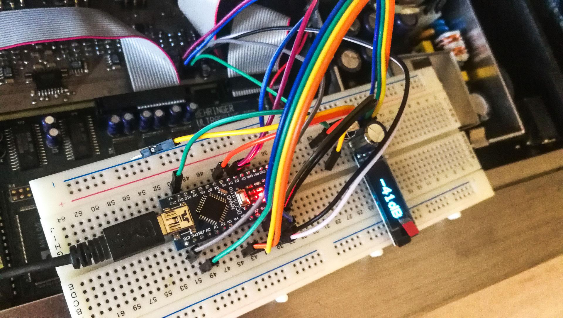

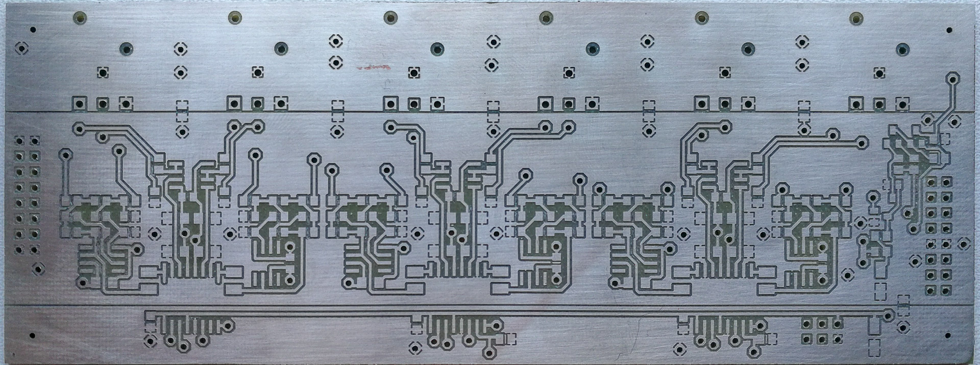

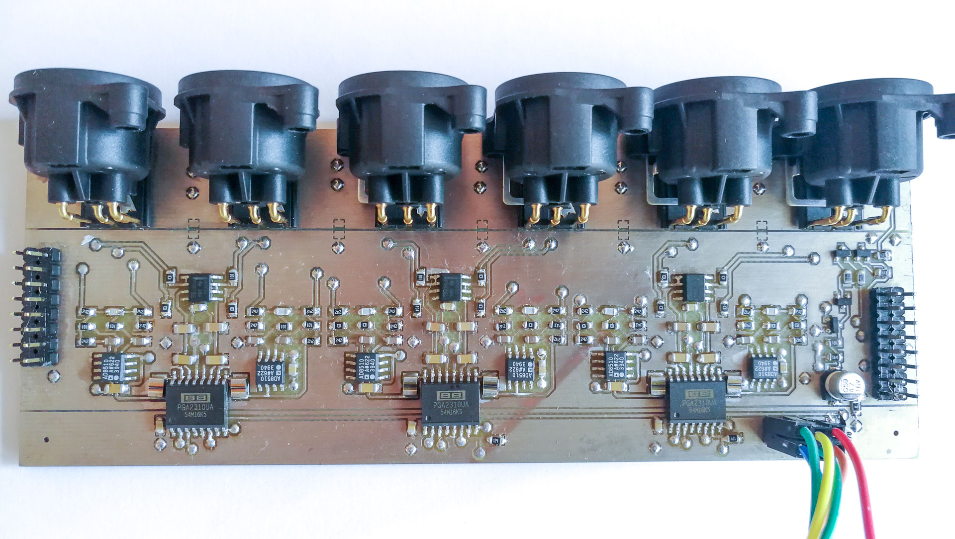

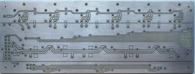

Hi everyone, after a few months of sporadic development my version of DCX2496 output board is complete. Main features:
I never use analog inputs or any of the serial interfaces so I limited myself to outputs only (for input I use USB>I2S streamer, connected directly to SRC chip on DCX main board). Analog inputs (AD8510) are based on AK4396 recommended schematic, then go through DC decoupling and straight to PGA2310. After which I decided to put an impedance balanced buffer of NE5532. Ground cancelling or OPA1632 outputs would have been better but the layout got very crowded and my amps are single-ended anyway. I also included amb's muting circuit, which works wonderfully. I still get a faint click but that's OK, having in mind that I'm running amps at full 36dB gain with no attenuation. The whole analog part is sort of star grounded, all ground references for each channel come to one point on the PCB, which prevents any induced ground currents.
All this is controlled by a Arduino Nano, which only reads IR input, sends SPI data to the PGA and then displays gain on the display.
Technical part: all caps in the signal path are C0G grade except for the AC coupling ones which are acrylic. PCB was done on a home-made CNC, then tin-plated in a liquid tin solution. Vias were done with 0-ohm 0603 resistors in 1mm holes - a genius solution I found on the EEV forums. One lesson I learned the hard way is that low-melt solder paste is not very good for initial soldering - does not flow well and has very low surface tension. Fine for ICs though.
One thing I haven't figured out is that if I connect the ground to case I get a rising 50hz buzz, which only appears when signal is present at the SRC. So I just left the output connectors disconnected electrically from the case and the speakers are dead silent even at full volume.
I also thought about intercepting the main rotary encoder of the unit but didn't bother as remote control is always better 🙂
Can you provide details on how you accomplished this? Somewhere years back I posted an idea on how to do this within this forum, but never had the courage to attempt it.
Well you are the author of the solution 🙂 I even remember having a chat with you about that. Yes, it works and furthermore, I2S input is immune to the dull sound bug that happens with SPDIF input.

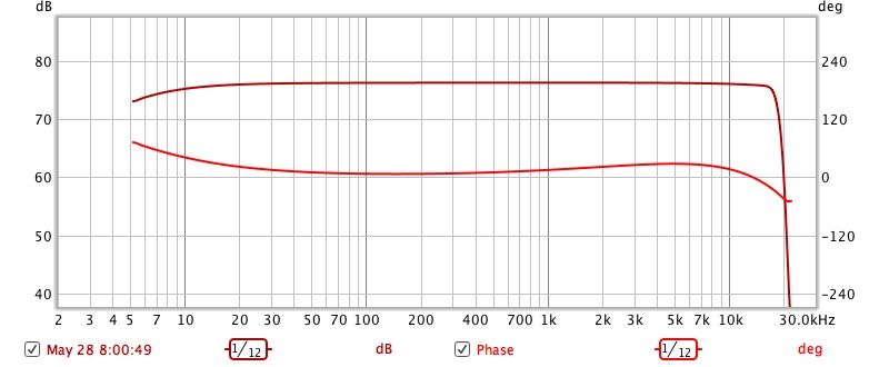

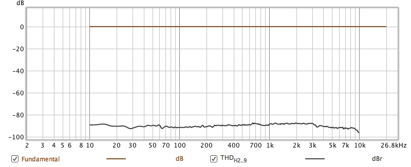

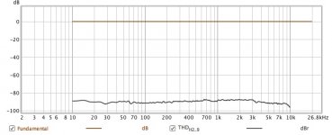

By my amateur measurements, down about 6dB at 5 Hz and about 22kHz. Phase is nice. Distortion near -90dB end to end (that's about .00005%... I don't think I could measure a piece of copper wire better).*...So, in my opinion, there is no need to improve the DCX's AES/EBU...
Makes you wonder how Behringer find room to sneak in the distortion that so many folks on this forum want to fix.
B.
*and that includes some elderly second-hand gear in the test set-up with each adding distortion and error

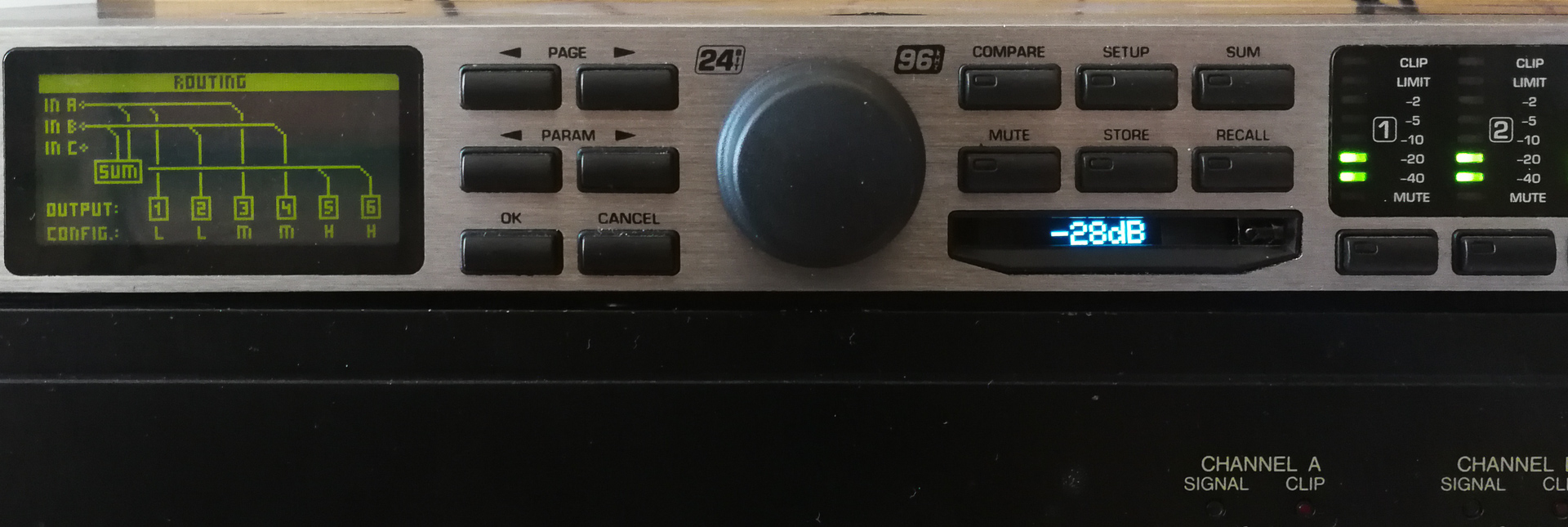

The answer is yes.
Use the "sum/setup" and "routing" portions of the configuration scheme to set it up however you like.
Input C support either microphones (with 15 volt phantom power) or a standard line-level input.
