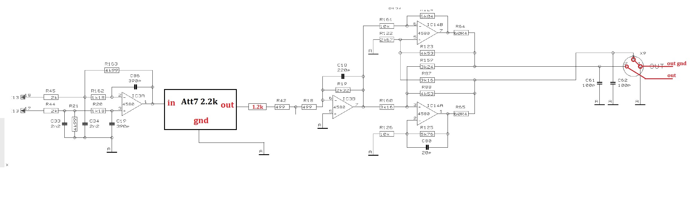

Integrated into DCX2496 - relay six-channel volume control, as well as 3 additional digital inputs TOSLINK. Removed capacitors C43-48, transistors T1-6. Operational amplifiers IC1B-IC6B are converted to a single gain. On / off control, input selector and volume from the remote control. All power capacitors are replaced by polymer

Very impressive! I have a couple of those boards as well. I have several questions about your implementation - how did you integrate the attenuators into the signal path, was it in place of electrolytic decoupling capacitors on the output board?
Second, how in the world did you hijack the main rotary encoder? 😕
Third, how do you control these boards? Last time I checked (which was at least 4 years ago) you needed either an analog voltage or emulate remote IR protocol through digital pin. Did the firmware get upgraded for easier control via microcontroller?

Yes, just like that (as in the picture). These capacitors are not really needed.
Everything is very simple. The encoder does not need to be cracked, I added a latching relay, which in the desired mode connects pins A and B of the encoder to the volume control controller. This does not prevent the use of the encoder to control DCX2496
The volume control is controlled by a separate controller, which allows you to use both the IR receiver and the Enecoder, or the buttons, as you prefer. If you know how to use a translator, more about it here:

If you want to go out unbal/RCA why not use the output of IC3B. Saves a couple ICs in the signal part.
Jan
I decided to keep the possibility of both a balanced and unbalanced connection, and I didn’t want to redo much. If you install RCA connectors, then it is easier to completely change the board, improving its routing and applying a different adder circuit after the DAC.
OK, sorry not to be clear. I only suggested to connect the wires you put in at another point, thus saving a couple of ICs in the signal path. No other changes than you did.
But if you don't mind the extra ICs, that's fine of course.

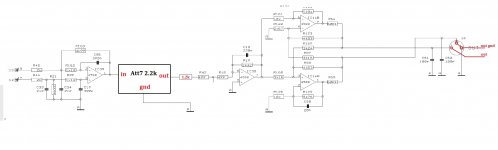

Same comment as to the previous mod - why the extra opamp at the end? Buffering one opamp with another one 😕

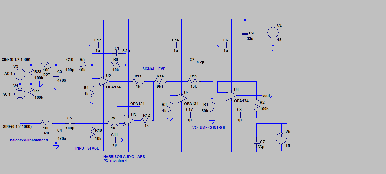

attached is the right way to do balanced inputs. Invert one line and sum it with the other. Try it out, comments welcome
You only need one opamp - opamps have differential inputs.
Looks like R1 is actually supposed to be a pot - note how it's labeled VOLUME CONTROL.Same comment as to the previous mod - why the extra opamp at the end? Buffering one opamp with another one 😕
You can get pot models in the LTspice group's files section, at least I think that's where I obtained mine.
if you have one stage doing the inversion that will cause a delay in that line. if the other stage does not go thru an amp stage, it will suffer no delay.
won't that asymmetrical delay pattern cause distortion? ideally, you want both stages to be 'concluded' at the same time, yes?
maybe an allpass to create a similar delay, so that they come together at the same time?
The delay in one opamp stage is practically negligible. But if you look carefully at the posted schematic, you’ll see that there is an opamp in both the hot and cold lines, one inverting and one non-inverting. So if there was a delay in the opamp, it would be consistent on both lines.
Anyway, I agree with jan.didden, there are too many opamps in there.
Yes Jan there are two many opamps in there, however you will note that part of the members here cringed on seeing those large input caps so the topology still has some polishing to do by probably adding one or more opamps to tweak the topology to work with 10uf or lower, others may want to completely do away with caps by adding dc servos by this time we have a little more opamps, we can do away with u1 which provides volume control, so this is the balanced input in its simplest form.
Thanks Julf differential inputs of opamps have been misused for a long time as balanced line receivers and mixers. The circuit above is doing it correctly.
