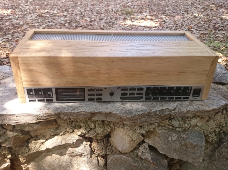

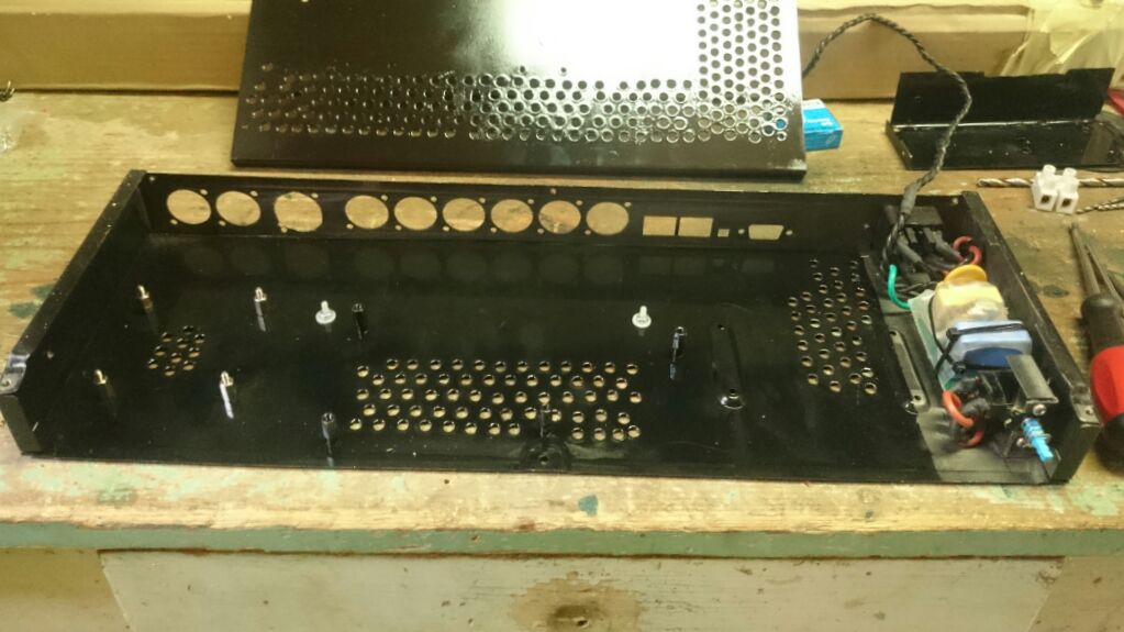

I had some spare time on my holiday so I've got some work done on my DCX . I finaly installed the WaveIO permanently, also the Selectronic clock. The shunts (four of them in the end) go above the DCX chassis, also the new transformer and rectifier/filter.
Swiss cheese. 40W of dissipation have to go out in the end. On the right is a mains filter.
"Lower floor", the original chassis. Left is the WaveIO usb interface, in the back coupling capacitors for direct out mod. Note the Neutrik USB chassis connector.
This is the business end. Still one shunt to complete. 100VA transformer and 3A contignuos consumption. The heatsinks are on the hot side when boxed.
The new chassis

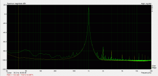

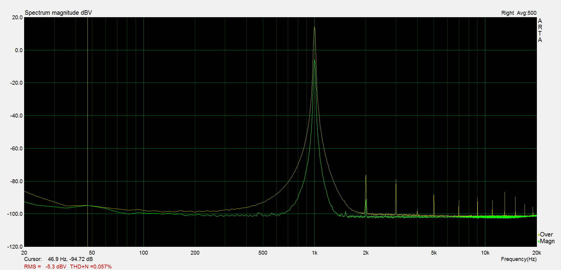

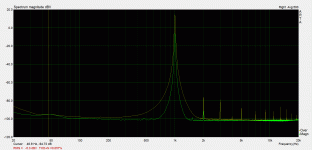

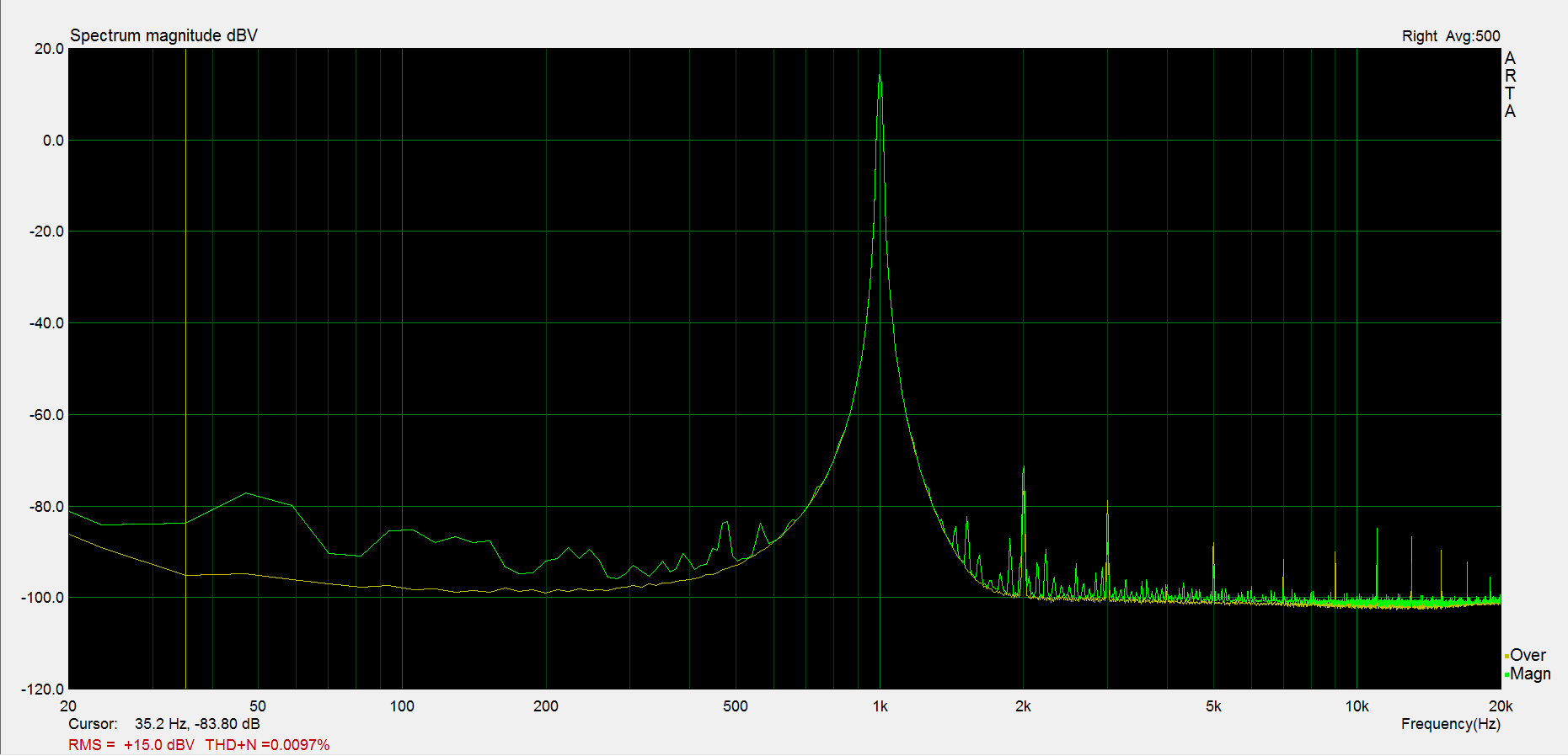

I need some help comparing my before/after results.
I replaced the output OP-amp stage with a simple unbalanced capacitor coupled one.
Now i get ~20 dBV smaller signal out of the DCX with the same setting on the FastTrack and ARTA.
If I toggle the 20dB pad on the FastTrack everything goes up eg. the 1k sine but also some worrying signals which were buried in the noise of the measurement and possibly burried in the noise of the unmodified unit measurements.
I'm not sure if my results are any worth...
