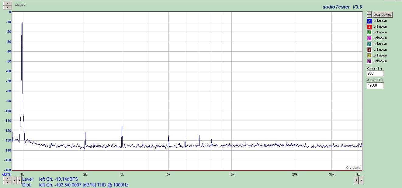

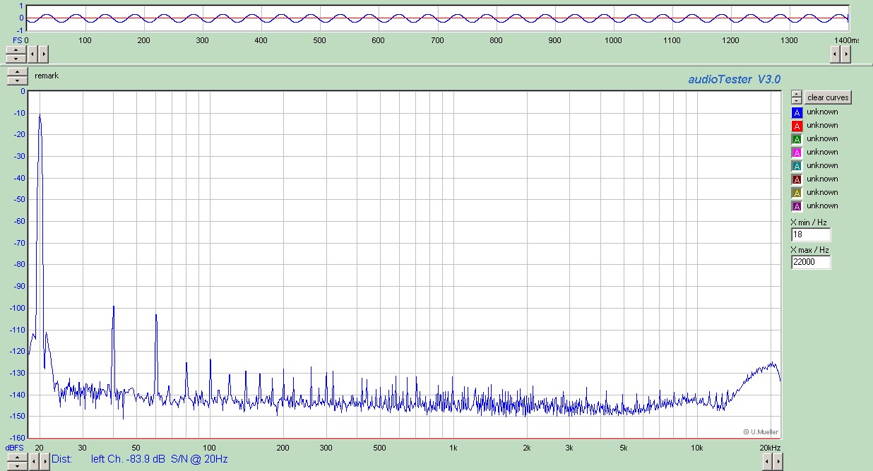

Right Mark won't tell you what you want to know. Better just to look at a spectrum via FFT. I posted that a few years ago. I'm sure others have too.
My files are a mess, I didn't document "as found" conditions, but this is what I get after a number of mods. Digital input using SPDIF, output stage consists of Jensen output transformer directly connected to DAC pins. Stock power supply. Full scale output on DCX (just before clipping).

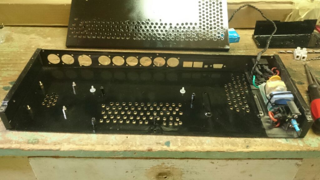

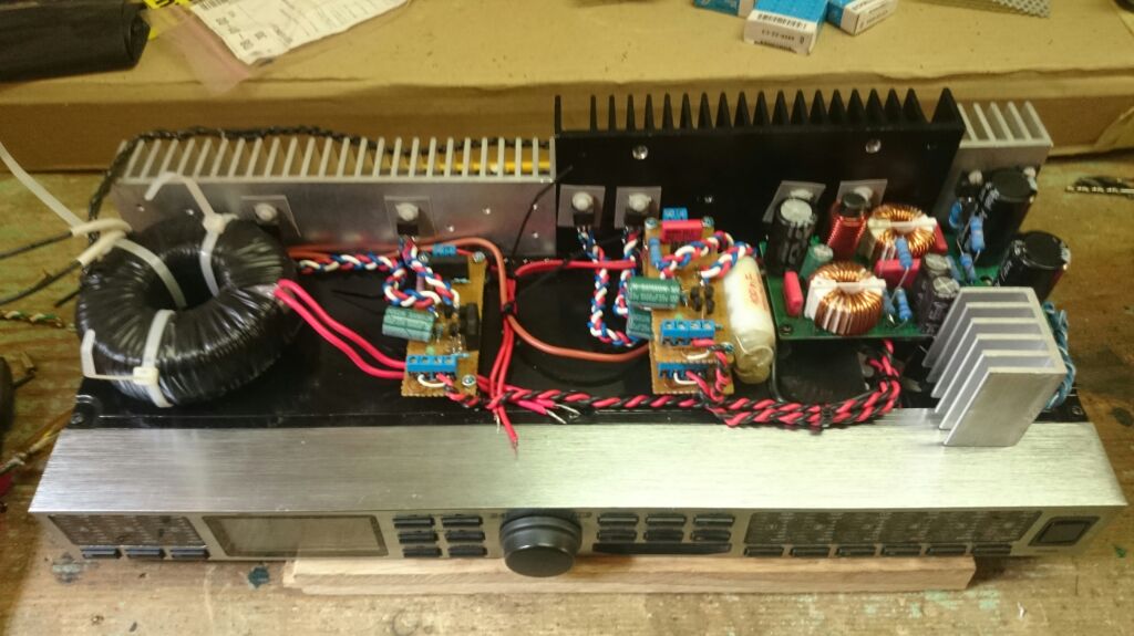

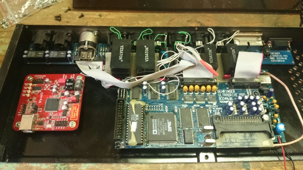

I had some spare time on my holiday so I've got some work done on my DCX . I finaly installed the WaveIO permanently, also the Selectronic clock. The shunts (four of them in the end) go above the DCX chassis, also the new transformer and rectifier/filter.
Swiss cheese. 40W of dissipation have to go out in the end. On the right is a mains filter.
"Lower floor", the original chassis. Left is the WaveIO usb interface, in the back coupling capacitors for direct out mod. Note the Neutrik USB chassis connector.
This is the business end. Still one shunt to complete. 100VA transformer and 3A contignuos consumption. The heatsinks are on the hot side when boxed.
The new chassis
The new chassis
