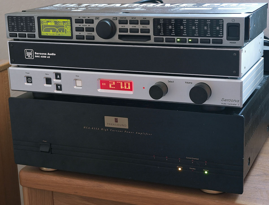

after several years of daily use, I can't see any issues with this concept.
Only that you need a bunch of DACs...
but there are SO many dacs to choose from! there is where your sound comes from. put your money and personal choice there. the numbers-box is a numbers box. cheap, capable but not critical anymore.
I used wolfson transmitter chips since I had them onhand and knew them. I plan to try AK transmitter chips and see how they compare. but I am sold on the concept of spdif-in and spdif-out. its so univeral and you have all the freedom to use $50 dacs or $50k dacs. even ones in between! 😉
It's a great idea - I agree! And I had at least 6 channels of DAC lying around. But I was just too lazy to ever actually do it. 😛
do you run all 3 pairs in the dcx? my needs are just 2-way so its only a pair of dacs for me.
I paid next to nothing for them; a pair of ak4399 dacs in a common chassis with an r-core trafo off to the side (all in a 1U repurposed chassis).
I think the dacs were $50 or so, each. chassis was a spare junker that I put some lasercut acrylic over to hide the previous life of the 1U 😉
has been working out fine. you can spend more. probably less. but its no big deal! come on, now. a 24/96 dac is no big deal anymore. 2 or 3 is still not bank-breaking.
I ran 2x2 or 2x3 depending on what my system was doing at the time. Sometimes I simply used it as stereo DAC with no crossovers turned on. . Usually it was proceeded by the DEQ2496. Short XLR between the two for the AES digital signal.
