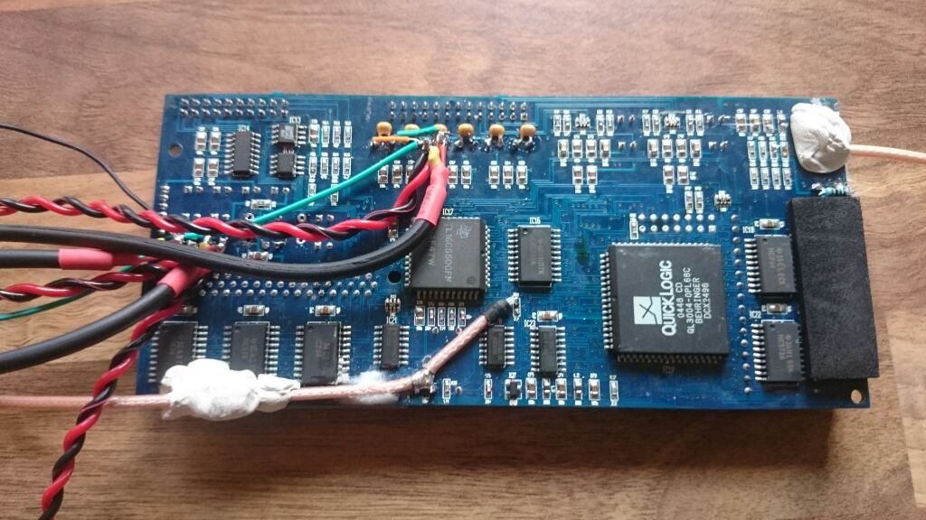

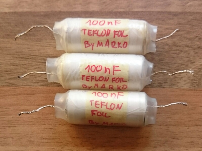

This old unit continues to supprise me and make my music listening experience better and better the more I fiddle with it.
In the latest iteration I installed the WaveIO usb interface in the DCX as SPDIF input, the Selectronic clock and finished an all-out power supply upgrade. The result is quite fantastic. I listen to active two-way dipoles augmented with a large subwoofer and to me - the sound doesn't fall short when comparing it with many systems exibited on the local audio shows. Yes, Accutons do sound more precise and tube-powered full rangers sound sweeter but my system makes involving life-like soud that I adore and the soundstage is to die for.
For the PS I used Salas Reflector D shunts, 5V ones for digital, WaveIO and DAC section and a 3V3 one for digital. The shunts produce quite a bit different sound than simple linear supplies but do get warm. So I'll have to modify the case a bit to allow for heatsinks - I'll keep you up to date with pictures of the build. Right now it's in the rat's nest phase and the soldering on the board didn't go without a jumper or two to fix broken traces so here's only the picture of the board. And a few "white russians" in the regulators 🙂
Ps. with the upgrades there aren't any "frying egg" issues even at 24/96 files!
