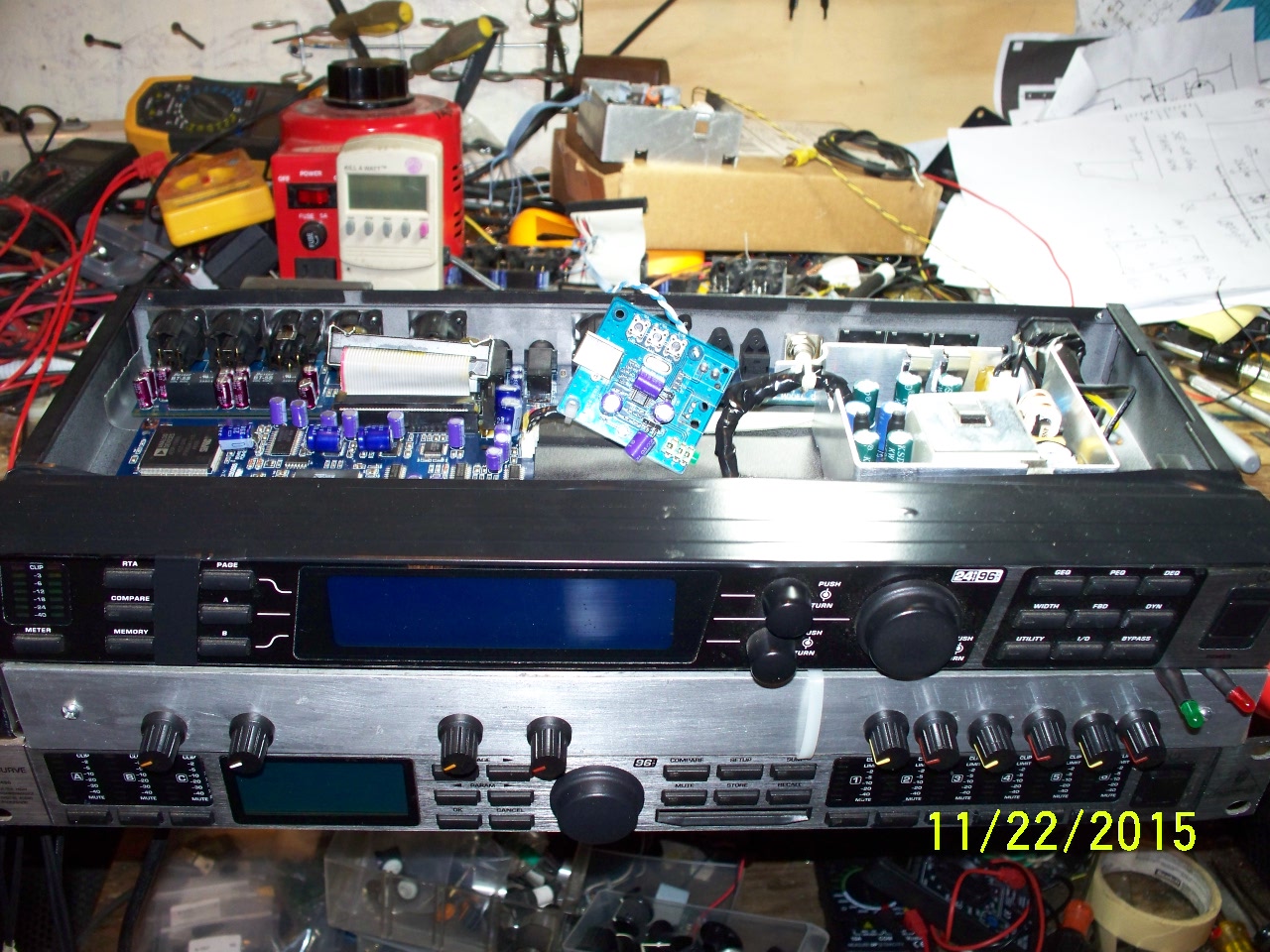

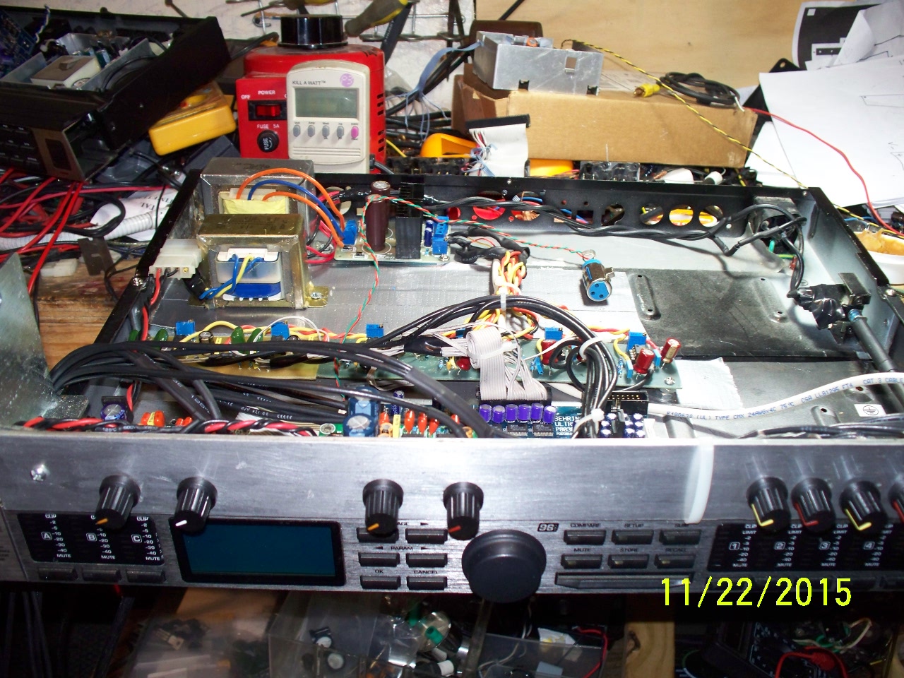

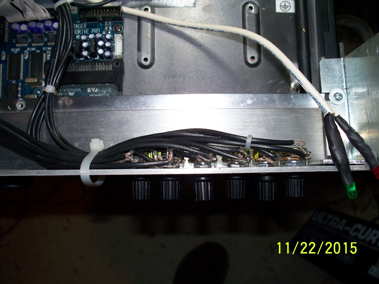

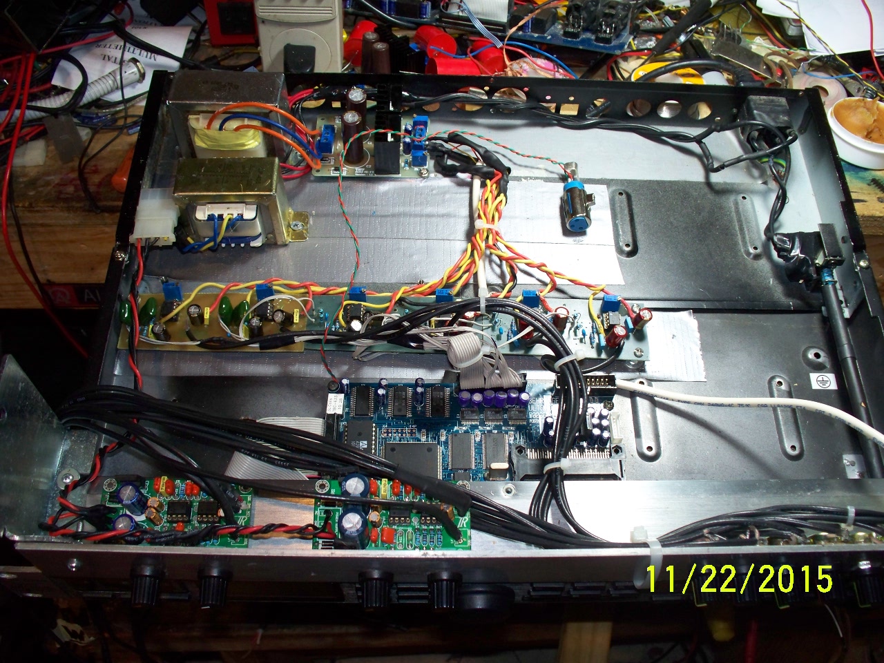

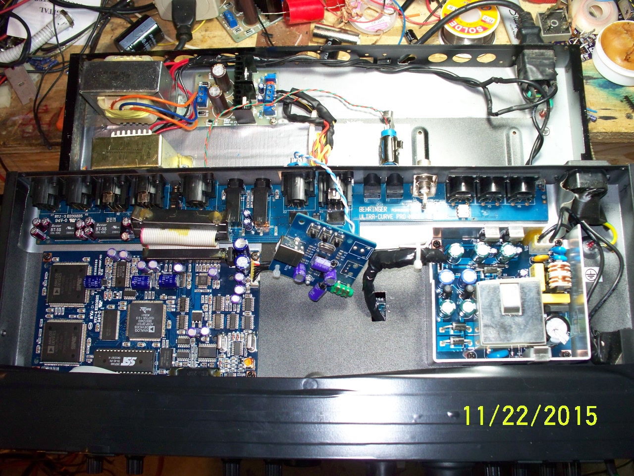

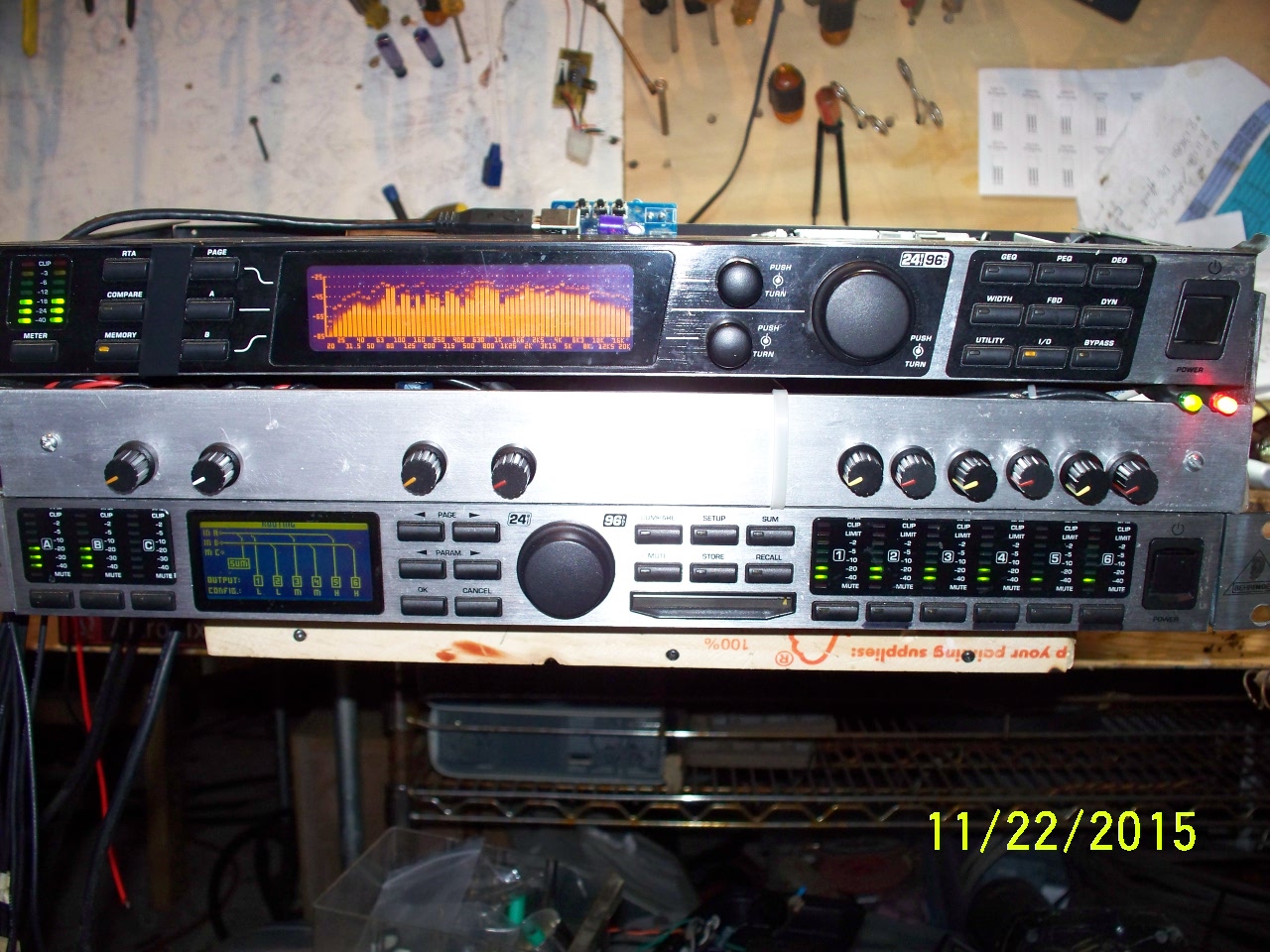

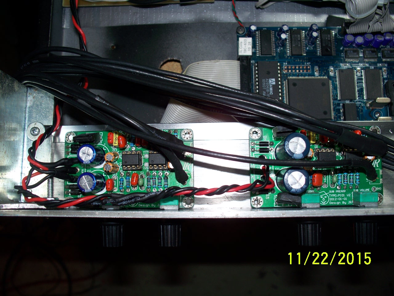

Here a few pic's
The first 2 pics show the xformer and PS for the 6 THAT 1512's they take the dac out to 1512's and out to the T M W amps on the last pic,The third pic is the sub boards,I run 4way and DCX runs 6 amps and the sub boards run 2 sub amp's to 2 XOc1's subs,
Pic 4 is the volume for each channel T M W on the left is sub volume and Freq control,I tapped off the bass op amps to control the subs,that way the DCX is still controling that feed and I can modify the subs response with the extra controls Vol and freq 20hz to 160Hz on the sub board.Pic 7 is the power supply for the dcx(a new board is being made with separate regs )Pic 8 is the 24/192 board going in the digi in to the deq
Pic 9 is what it looks like all together, Pic 10 is the water cooler,lol 2X4" The radiator and resavoir are under neeth,,,,so much fun,lol!

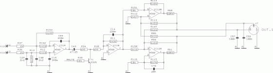

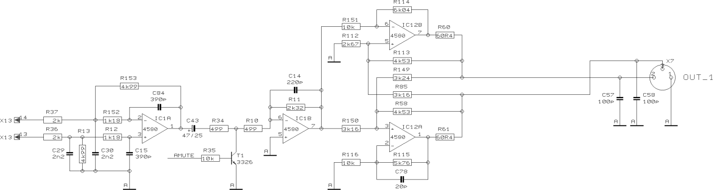

Analog out malfunction
Hi everyone, I'm having trouble with my DCX2496. The first analog out channel started misbehaving recently by presenting frequent and very loud thumps to the speaker. The signal is present and clean between the thumps. They seem to correlate with touching/moving of the jack. A closer inspection revealed that the outputs randomly swing between ~40mV to 14.5VDC on both signal lines simultaneously. As the signal is present in both states and same gain, I figure it must be a lost ground reference somewhere due to mechanically broken resistor or trace.
Now I've poked around with a scope, the first opamp (IC1, see schematic) seems to be OK, it has no DC on pin 7. I haven't much experience debugging this type of virtual balanced circuit. Can anyone give me an advice on which parts are the most likely cause before I go berserk resoldering everything?
I think you're on the right track. If moving the jack causes the issue it's most likely a broken trace somewhere in the area of U12. Since your outputs swing to the positive direction it's possible the issue is related to the -V input on pin 4 of U12
I suggest to take the board loose from the chassis and take a good visual look. It's kind of a pain with the DCX since many of the components are on the bottom side and you need to remove all the screws on the back. 🙂
Dave.
Dave.
Before you take it apart check the cable that is plugged into the jack with another one,
if it does the same thing then you have a bad solder joint around the jack, I hope you have and electric screw driver,lol.You could resolder the pins from the top side and might get lucky and that fixes it,They use hard solder and it likes heat and some extra flux helps too!
