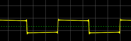

This post may not mean much except to old guys who used to spend hours looking at amp outputs on their 'scopes*. Tested around 2 LEDs loud.
If you can make a 200 Hz square wave look pretty (left picture), your system is handling everything from 20 to 2000 Hz just fine, including phase. For 2kHz sq wave (right picture), 200 to 20kHz.
Here is the "obstacle course" the signal is passing through: REW software signal generator, the Breeze USB to AES gizmo mentioned in previous post (and I'm using the disrespected USB power instead of the external transformer), DCX2496 set flat, a 15 yr old ADC USB-powered I bought at the Salvation Army for $4, patch cords, 99-cent scope software for Mac OS.
Not sure of test levels, but residual distortion and crap on a sine sweep in this long chain is down roughly 90dB (flat). And flat as low as REW goes, 5 Hz.
For a person who was a bit of a digital skeptic until not long ago, I was really impressed by how good ALL the pieces in this chain must be.

A digital generator assemblies a series of sinewaves to make a close approximation of a squarewave.
Because the digital generator is limited by it's inherent frequency limits, it will always show ripple in the square wave.
An analogue square wave generator usually has a much higher frequency limit and the waves look much closer to a real squarewave.
Yes, one more reason to have low expectations.Because the digital generator is limited by it's inherent frequency limits, it will always show ripple in the square wave.
So quite amazing to see such good square waves after passing through thousands of transistors. Actually, even small screw-ups with phase would have made these square waves look terrible.
