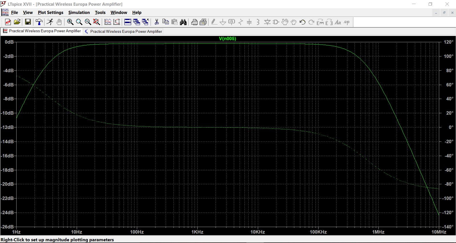

It looks pretty standard... but it all depends what you are trying to stop getting in though. It should cover potential problems from RF in most cases.
This is your filter response.

... but it all depends what you are trying to stop getting in though. It should cover potential problems from RF in most cases. This is your filter response.
Thanks for the chart! That's incredibly helpful.
So, db0 at 100khz with 470n, then 2n2 would be close to the audio band without harm? Down by 0 at 21khz?

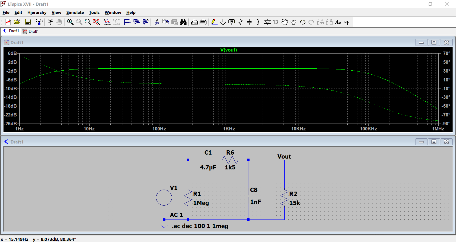

Referring to the schematic below, borrowed from post #693:Should the R6/C8 network be in front or behind C1?
When there is an RC series to an amplifier input, the R should make contact with the amplifier input. Like this (links to one of Mooly's 3 options) P.S. looks like you want 1k2 in your filter, or a slightly smaller RF cap.

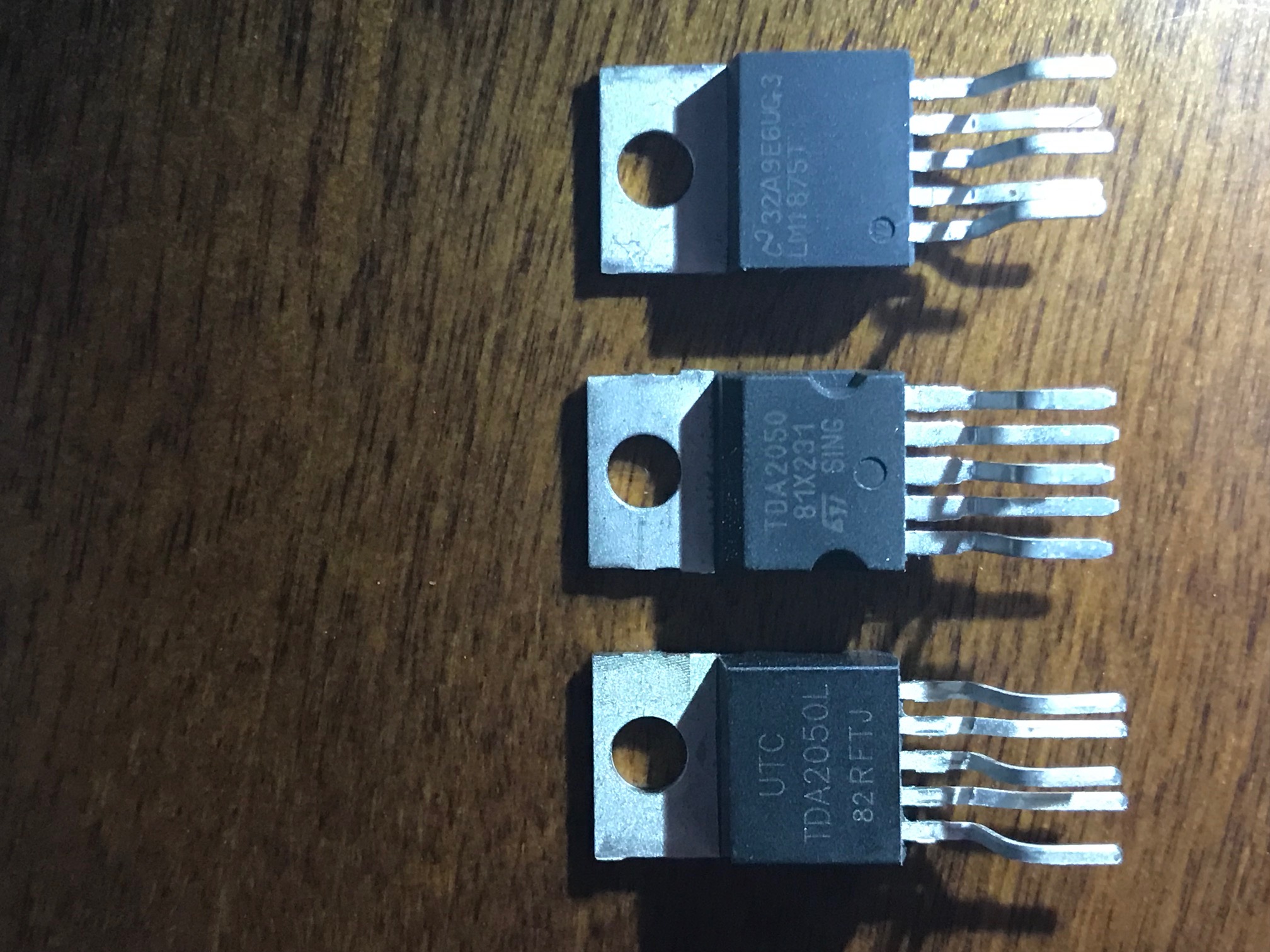

I'm sending a picture of LM1875 as attachment. Please anyone tell me if it's original or fake one. I am waiting to make an amp with this for my home. Thanks! ! 🙂

Please anyone tell me if it's original or fake one. I am waiting to make an amp with this for my home. Thanks! ! :-)[/QUOTE said:
My chips are authentic, well , the one from left is not the original STMicroelectronics but it was made by http://www.unisonic.com.tw/datasheet/TDA2050.pdf.
The one on the right is lm1875 made by Texas Instruments(National was bought in 2011 by TI). I do believe that your chips are not authentic.
Has LM1875 gone out of Production or it's still there? I'm sending a picture of LM1875 as attachment. Please anyone tell me if it's original or fake one. I am waiting to make an amp with this for my home. Thanks! ! 🙂
Real LM1875's are available, but that does vary by market. The fakes do make amplifiers, and the closest match is the TDA2030 datasheet (especially flyback diodes and lower voltage).

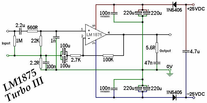

Yes, the groundlift is like throwing a wrench in the works, resulting in some RCR's (like high-esr bad caps) instead of the desired RC's. For the hookup that was recommended, the only patch I could think of was to throw a token 100n resistor at the problem. For treble quality at the 200u, choices include bypass routing (seen earlier) bypass the groundlift resistor with a cap, a DC Tracker (yuk!) or bypass the groundlift resistor with a solid copper wire.

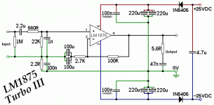

It was also necessary to look reasonable as well as work, so there's this (attached).

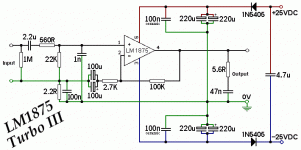

To be done is a graph that shows different input and gain dividers as well as fine tuned stability components corresponding to different voltage (and use). However, if you have the 18-0-18 transformer handy, this works. It may be somewhat party oriented, which is unusual for the 5-pin chip amp.

Daniel, can you share a pcb version for your lm1875 turbo III? thanks
I used a vero-build. Start at post #24.
Be sure to compare the resistor values on the TurboIII with an orthodox build. It is good to see which you like better. There are also quite a few varieties in 5-pin chips, some of which need the high gain, and some don't. The label on front, really doesn't provide a clue about which chip is inside.
