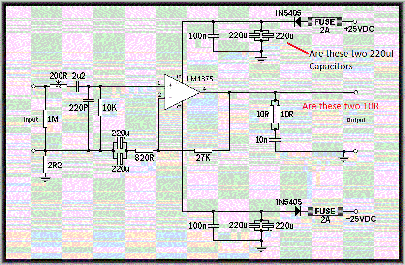

Please see the picture.
Thank you
Vijay
India
Two cheap 10R 1/4w cost much less than a 5R 1/2w resistor.
This can be replaced with one 1/2w resistor; and, there are many other options (most of which won't be needed if the amp is stable).
Two cheap 220u caps sum to 440u and result in maximum quality.
This cannot be replaced with a single part because it would cost either a higher gain setting resulting in lower resolution, or cut the power voltage (not slightly) to increase stability. I say, make room on the board for duplicate power caps, run tandem. It probably will be worth doing that for all of audio amplifiers.
Edit: Don't go nuts--I said two, not fifty.

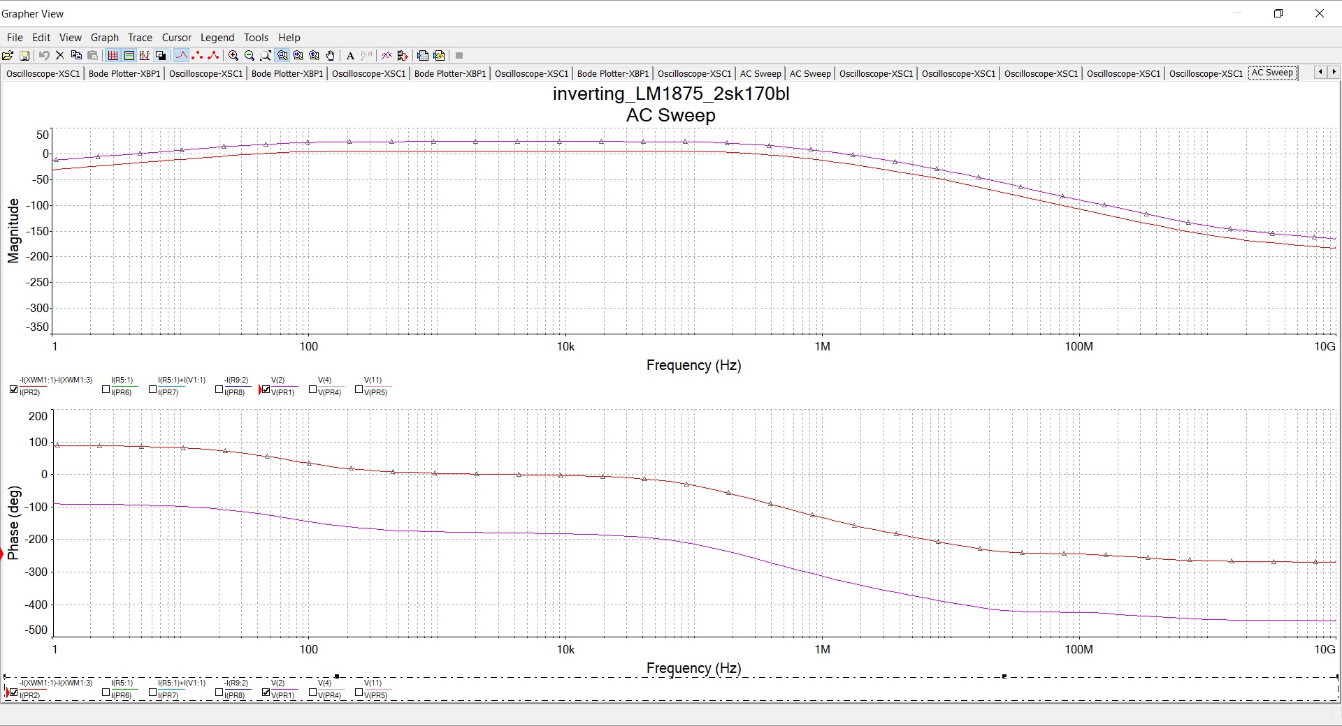

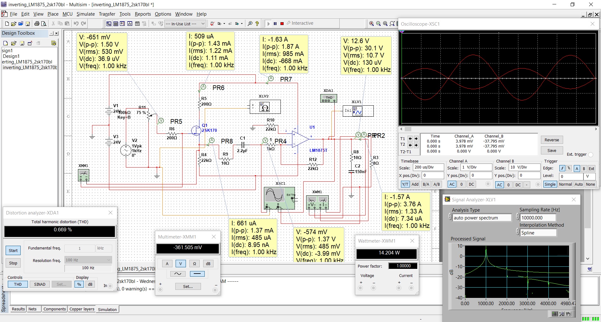

Trying a simple LM1875 with 2SK170BL
Attached are simulations of a simple LM1875 with a single 2SK170BL (left-overs from a DCB1 Buffer project). Is it stable based on the schematic?
I have built it with resistors and cap values, they are available with me currently. It does not show an excessive temperature raise and it's been two weeks operating. DC out is about 1 mV or so, similar to my non-inverting LM1875.
I have not tried the T-network because as I read it, the T-network is useful if we build without buffer. Please correct me if I am wrong.
PSU is a 18-CT-18 transformer with simple 2x2200 uF per rail.
Any comment on the bode-plot?
