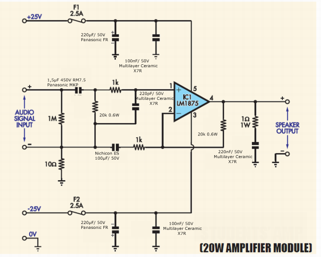

I've built quite a few LM1875 in different schematics with never the same Components. All I recognized is, an Amp with the cheapest parts can sound as good as one with more expensive Components, if it is built small, with shortest possible Signal Path and clean Layout. I have got 6 LM1875 at the moment in my Speakers and they sound really great. but as the Amps are partly built with different Parts, I deceided to built 6 last Amps with same Components. I think I'll use good, but not expensive Parts as in the Schematic.

good to know. My kit is now pretty similar to that but still has the 10uF cap. The nearest I have to the 1.5uF listed are gigantic WIMA 1Uf MKP 10 X7 400V-/250~10% Which are almost as big as the amp board, but I'm sure I could get it to fit ;p
ok, I know very little about circuits and would love some instruction on the very basics of these things. Here is a stock ebay board which many of us have..
My question is, what bits do what and why? Nothing overly complicated or detailed, just an overview so I can get a better grasp on what people are talking about. All discussions seem to begin with an understanding above these basics. Things like input caps, decoupling caps etc. I'm not really able to follow very well and this board is simple enough that a small guide as to what's what would go a long way to a better understanding.

I read the data sheet and read some stuff online but it's all very abstract for my way of thinking. The kinds of things I'm looking to understand has to be related to an actual item like this board which I can then transfer to other similar things.
For instance, using the schematic at the top of the page,
Across the input signals there is a 1meg resistor, that's there because....?
After that, there's a 1k resistor in parallel to a 20k resistor that's in series with a 220pF capacitor, this determines...?
The two 220uF caps are the..? caps, there to...? and they work together with the 100nF caps which reduces...?
This is my problem. I don't really understand what each section does or why and I'm too dense to figure it out unless it's pointed out in simple terms. I'll never understand electronics beyond very basic levels but a general grounding of a simple circuit like this will at least give me some idea.
In automotive terms, I guess the equivalent would be something along the lines of...
At the inlet there is an air filter, this prevents dust/dirt entering the engine, next is a carburetor that delivers a fuel and air mixture. The amount is governed by a valve, how open the valve is determines how fast the engine revs. Inside the carb is a small fuel chamber with a float valve whose job is prevent excess fuel entering the fuel delivery valve to avoid flooding. Once the fuel and air is mixed, it flows into the cylinders via timed inlet valves at the top of the cylinder head.. etc
Mechanics are easier for me to understand 😛
Thanks, Mark.
Nice op-amp introduction, unfortunately for me, the bits I'm most interested in are the bits where Dave says "but I won't go into that here" 🙄 I've been racking my brain over the diagram above trying to figure it out, could anyone see if I'm somewhat correct in my guessing here.
The 1.5uF = input noise filtering
The 100uF + resistor = gain level
The 220uF = supply stabilizer
The 220pF = current drain
The nF caps = high frequency filtering (ringing?)
The 1k & 20k resistor pairs = +input and -NFB loop.
The 1meg resistor = keep input impedance high
The 10 and 1 Ohm resistors, no real idea! Short protection? Output impedance?
These are my best guesses based on what seems to make sense to me, for whatever that's worth 🙂
