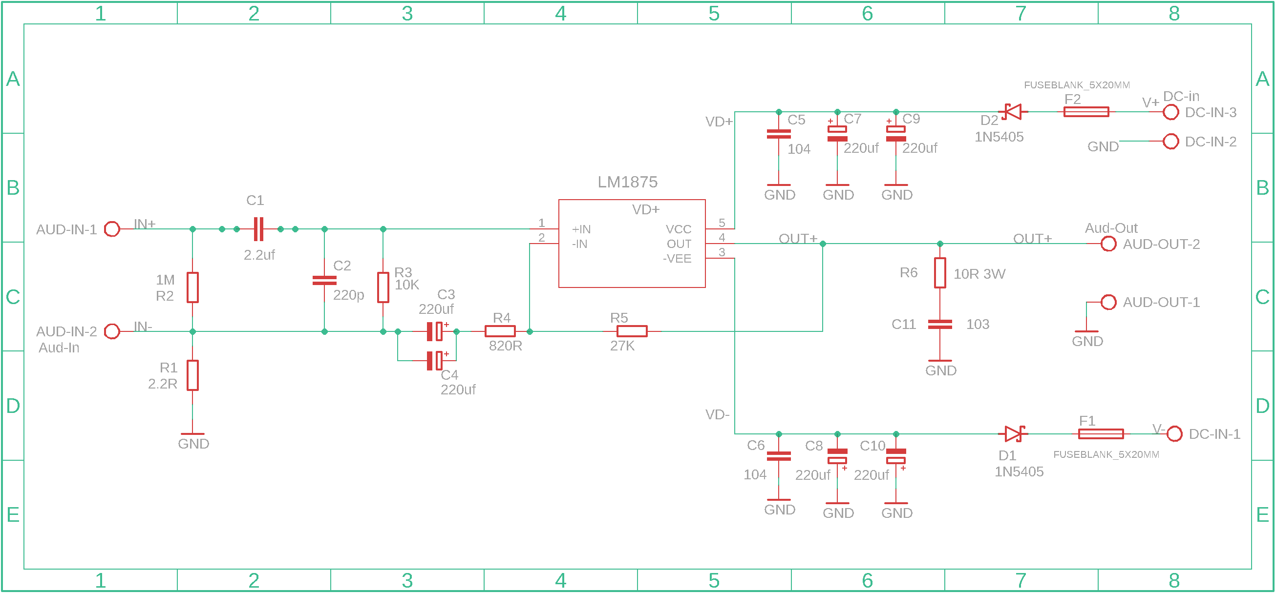

First I changed the NFB to 860R combine with 20K for Gain 26 but not satisfy cause the sound to be less beautiful. I don't know why
Then i test as your suggest. It's work well then.
Altering the gain by altering the feedback could cause you big problems with stability. Whilst it can be done, it requires addition of other parts and so is not recommended for a beginner.
The simplest and safest solution would be to add a series resistor to the input to the board. 22k would divide the signal by 2 as it would form a divider with the input bias resistor already present.

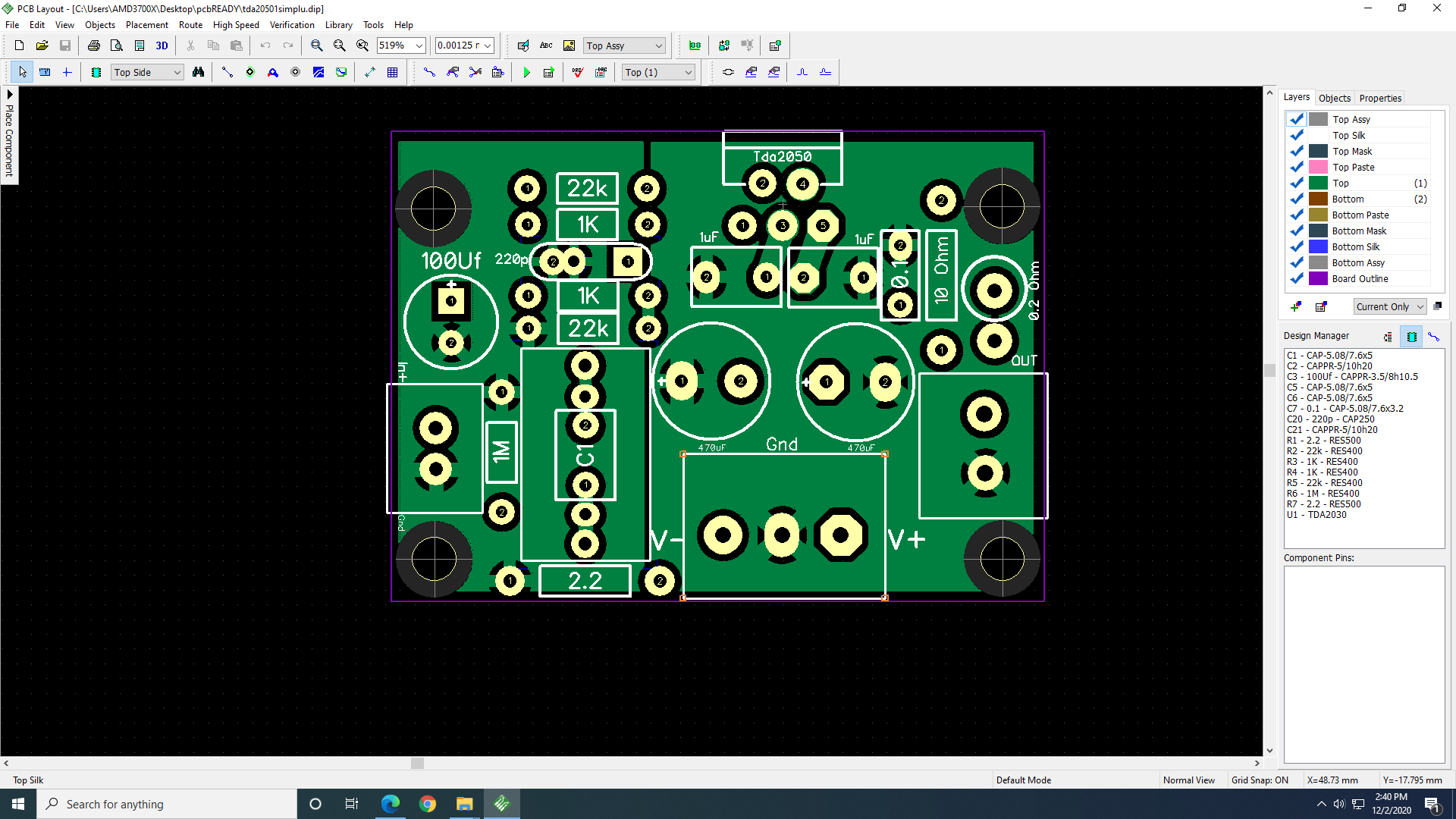

I order 2 Pcb as above. one for LM1875 for mid/tweeter and last one TDA2050 for Subwoofer.

That layout is for a really really warm sound; but, if you'd like it to play clearer, swap C6, C11 for 100uF or larger, with at least 16v spec.

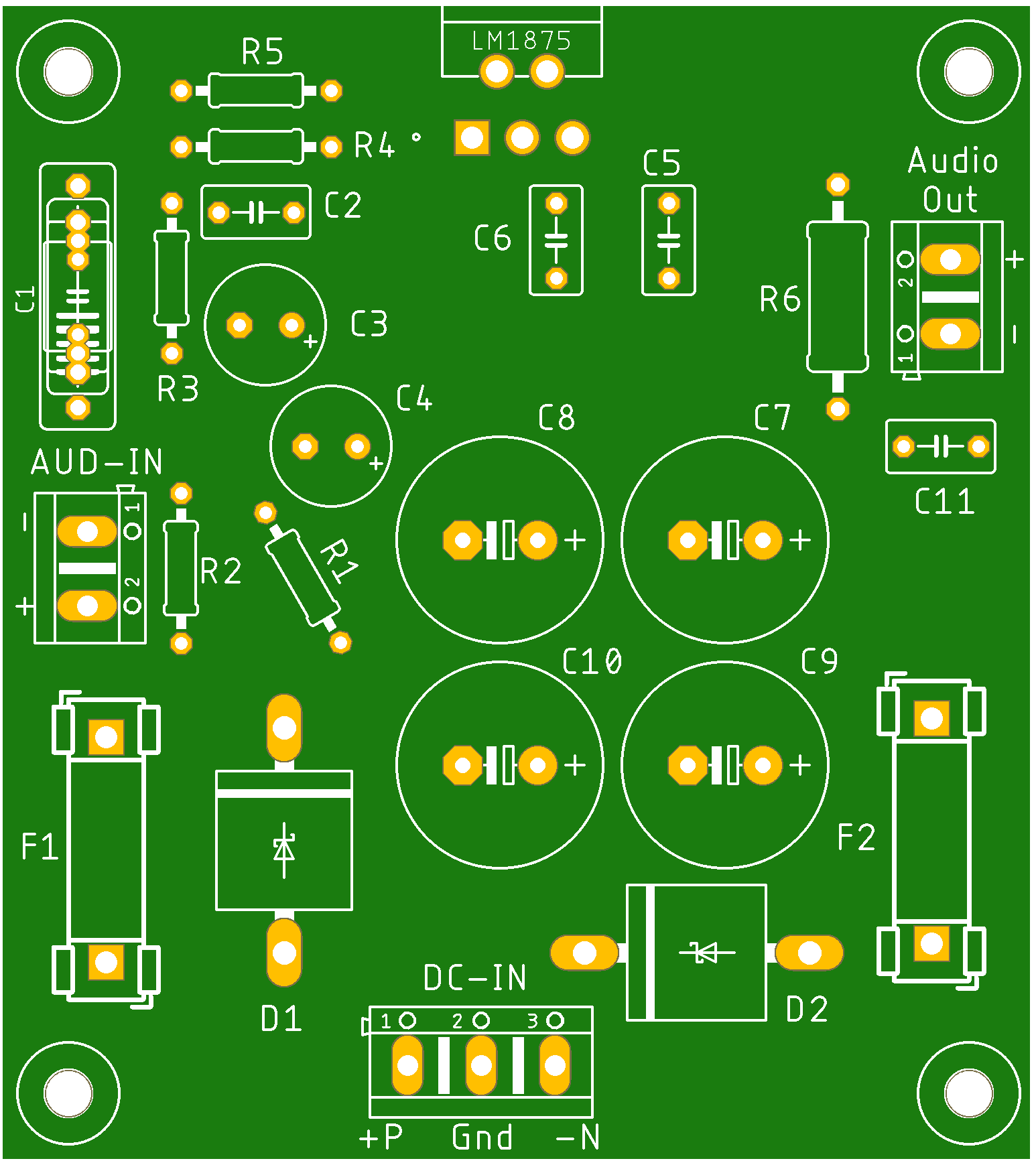

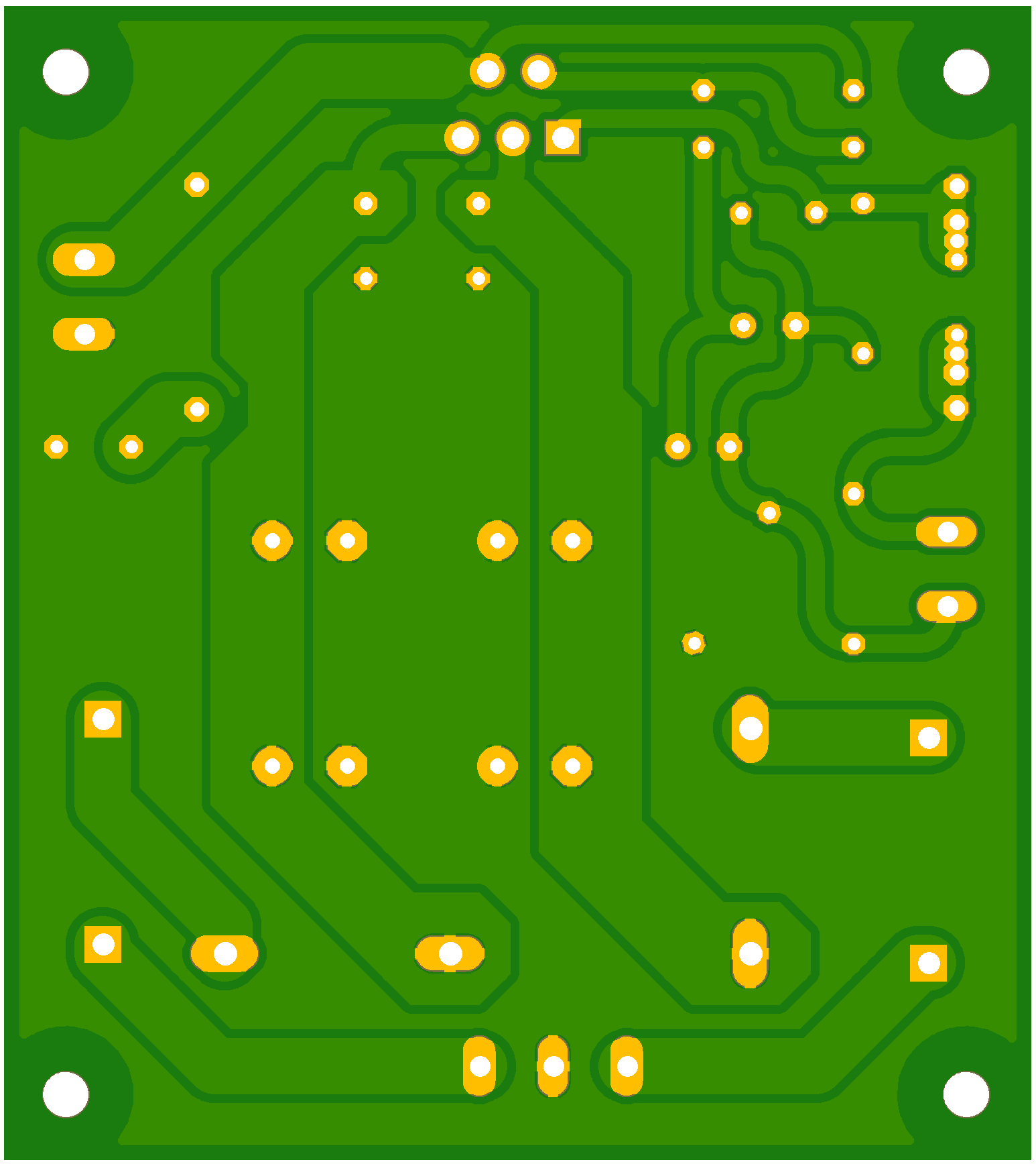

It might help some of the members. Please let me know if there is an error.
Single-sided board
Size: Width 69.52mm x Length 79.09mm
Thank you
