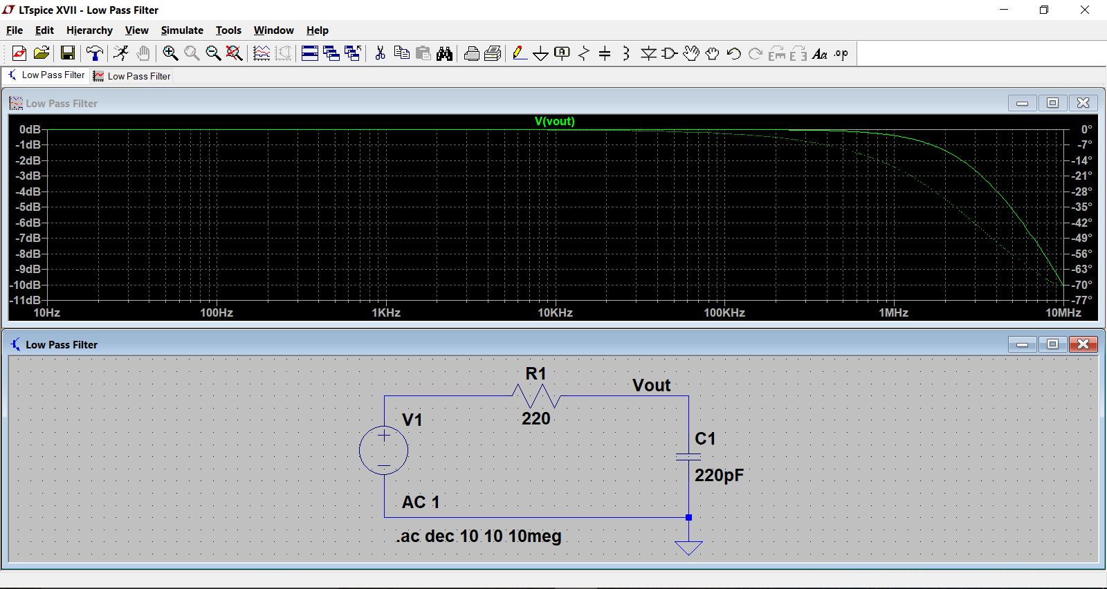

Regarding the 220R VR potentiometer at the input, I wonder what function this component has?
Regards Kurt
You're welcome 🙂 and pleased to hear you have one channel working.
The 220 ohm... only Daniel can explain that one 😀
What it does do is interact with the 220pF cap to form a low pass filter although imo the effect of it is minimal with those values. If you turn the pot to a low value resistance, or even to zero ohms, then the 220pF cap effectively appears in parallel to whatever you connect to the input and in certain cases that might cause problems rather than help matters.
I would recommend fitting something like a fixed 1k resistor in place of the preset.

The 1k and 220pF form a filter with a -3db point of over 700kHz and so any effect it has will be marginal. Its Daniels choice of how he wanted to do it though.
Now I better understand, why I couldn’t hear any difference no matter the position of the potentiometer 🙂
My testspeakers are not the best but still.
With your explanation of the function of the cap and resistor I wonder why he put a potentiometer there instead of a fixed resistor.
You would have to ask Daniel that one 🙂

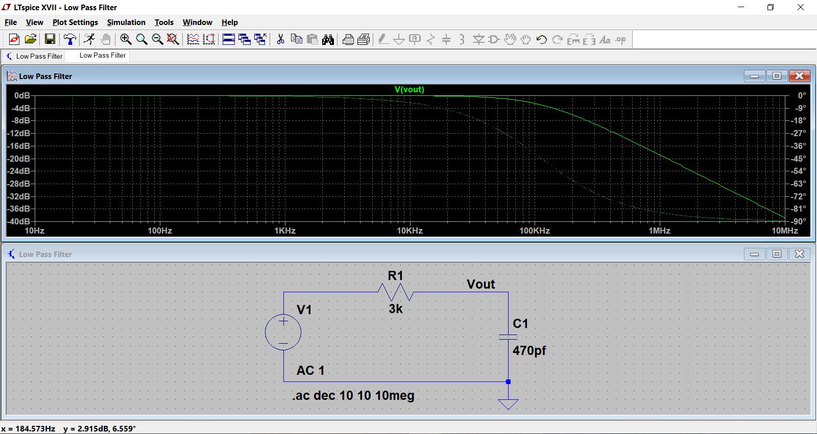

This shows graphically how the filter shapes the response. Look at the scale at the left. The second example would be more typical of values used in other designs.
One of the main functions of such a filter is to keep out interference.

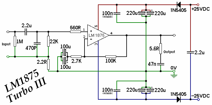

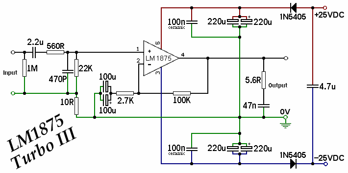

I'm in the process of building an LM1875 amplifier.

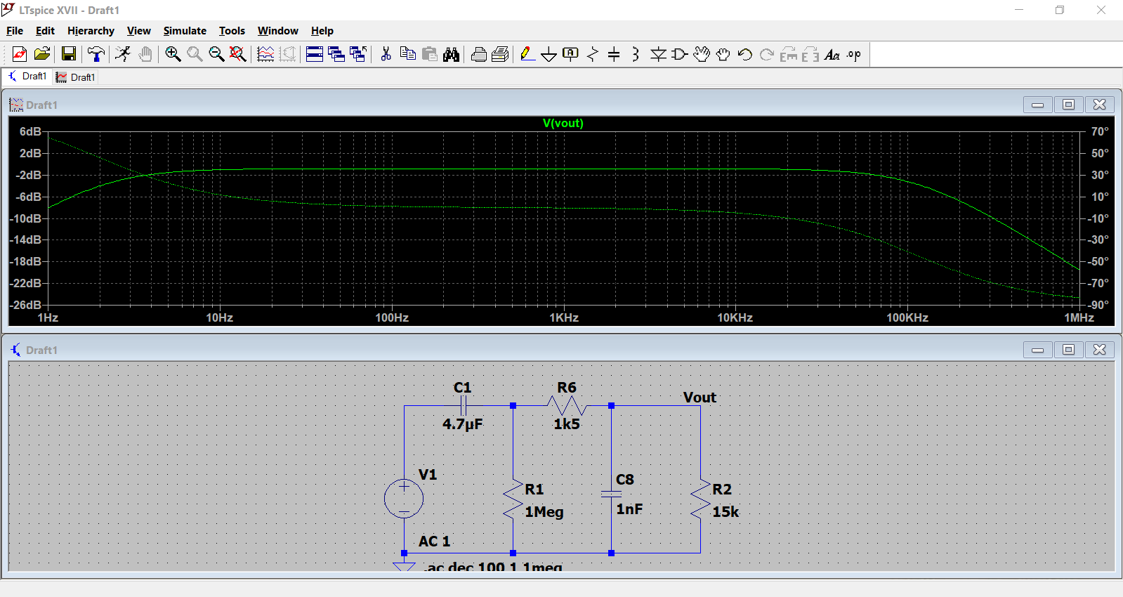

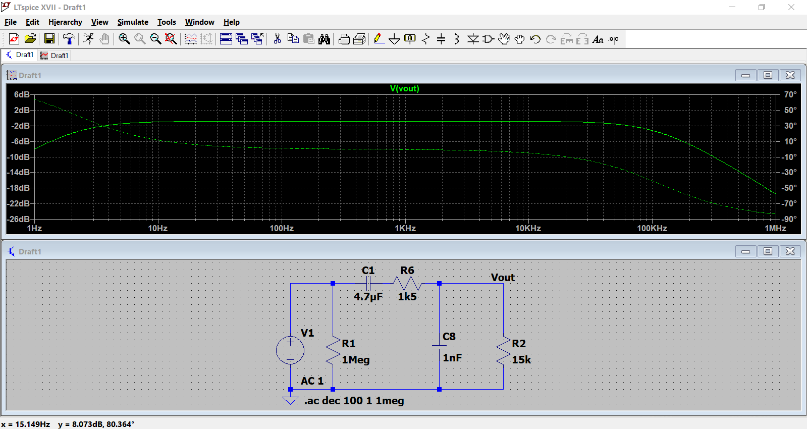

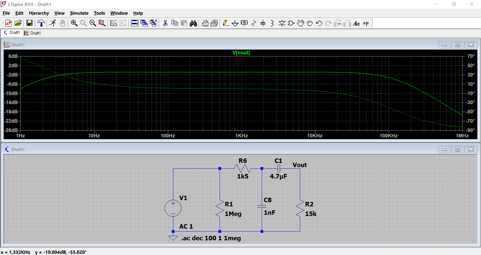

I have a question regarding the low pass RC network in the input of the amplifier: Does it make any difference if the RC network is put before or after the input DC blocking capacitor?
Common mode relates to a signal effectively appearing in series with both inputs.
For minimum common mode gain (maximum rejection of common mode signals) both inputs need to see the same impedances over the range of frequencies involved. That means the 2.2uF, 470pF and 100uF's would have to go (DC coupled) and the 22k would need to be made equal to the 100k. You would also need a 2k7 in series with the input. The 560 ohm would need to be linked out.
So that just isn't practicable for that configuration.
Common mode relates to a signal effectively appearing in series with both inputs. For minimum common mode gain (maximum rejection of common mode signals) both inputs need to see the same impedances over the range of frequencies involved. That means the 2.2uF, 470pF and 100uF's would have to go (DC coupled) and the 22k would need to be made equal to the 100k. You would also need a 2k7 in series with the input. The 560 ohm would need to be linked out. So that just isn't practicable for that configuration.
I had meant to get close, perhaps just for sport. In this case, I wanted the dividers at + and - to be same voltage proportions. The question is, did I get the input RF filter done right?
