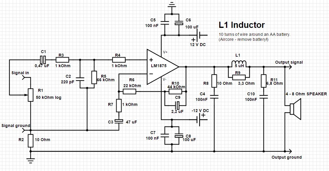

Hello.
I have mixed the Daniel beginners amp with details from other designs with the LM1875.
Would someone kindly tell me, if there are any major issues with the design?
For information, R3, R4 and C2 are for general stabilization and against radiofrequency interference/oscillation.
I have chosen 12 V power-supply since it's gonna be a PC-amp and one of the design-criterias is, it must fit in a small box I have at hand. (SIC!) So no big trafos.
There will be a Carlos-style powersupply. Dual mono build with 2 pcs. 9V ac windings, each rated at 1,66 Ampere.

Otc,
try adding an R+C across the speaker terminals.
Reduce R9 across the inductor and use the removed portion as the resistor value in the R+C.
The lower value for R9 will damp the ringing in the output inductor, L1. Try 3r3 (3 off 10r in parallel), or 5r (2off 10r in parallel).
The R+C becomes 6r8, or 5r + 100nF
This has the added benefit of slightly reducing the RF that gets injected from the speaker cables.

AndrewT,
Thank You for evaluating the circuit and suggestion of added RF-filtering.
If I understand correctly, that would be like in attachment?
It would be advantageous to use a 20 or maybe even 10 kOhm log pot, in stead of the 50 kOhm? (R1)

10k, or 20k or 50k vol pot would all work.
Even with the 50k vol pot and 100pF of cable to the power amp you would have a low pass filter of ~ 1/(2 Pi R C) = 1/(2*3.14*13500*100+220)*10^12 = ~36kHz or about 1dB down @ 20kHz, when the vol pot is at ~-6dB
The 6r8+100nF goes across the amplifier's speaker output terminals, it is not at the amp PCB.
The amp now sees 5r+200nF as the HF loading when no speaker and no cables are attached.
You can now trim R5 to minimise the output offset. Start with a 100k 3/4 turn temporary VR in place of R5, to find an approximate value for R5. Then you can insert a fixed resistor just above that value for R5 and add a big VR to do final trimming. Maybe 82k || (200kVR+270k) which gives you an adjustment range of 63k to 70k

C6 & C8 can be any size from 100uF to 1mF
C5 & C7 must be located very close to the chipamp power pins and must have a low loop area back into the Zobel Return and Speaker Return.
C1 must be your input high pass filter.
Be careful that it limits the signal that C3 needs to handle. There should be zero AC voltage across C3, if it is to do it's DC blocking job properly.

Thank, You. I get Your points.
Specifically I read the thread about Prof. Cherry's LF phase-correction in the feedback loop and understand that C1 in my circuit can not go higher in value, it is mandatory in the circuit to cut LF at same or a higher frequency than C3. So will only use value 0,47 uF or maybe smaller, but different types of film-caps.
I suppose the Prof. Cherry phase-correction is audible and not just measurable?
I think it is audible. But maybe I am being fooled.
It does create a small hump in the response just before the roll-off. Maybe that is more audible than the phase correction.
I consider the input filter as mandatory to remove that LF hump.

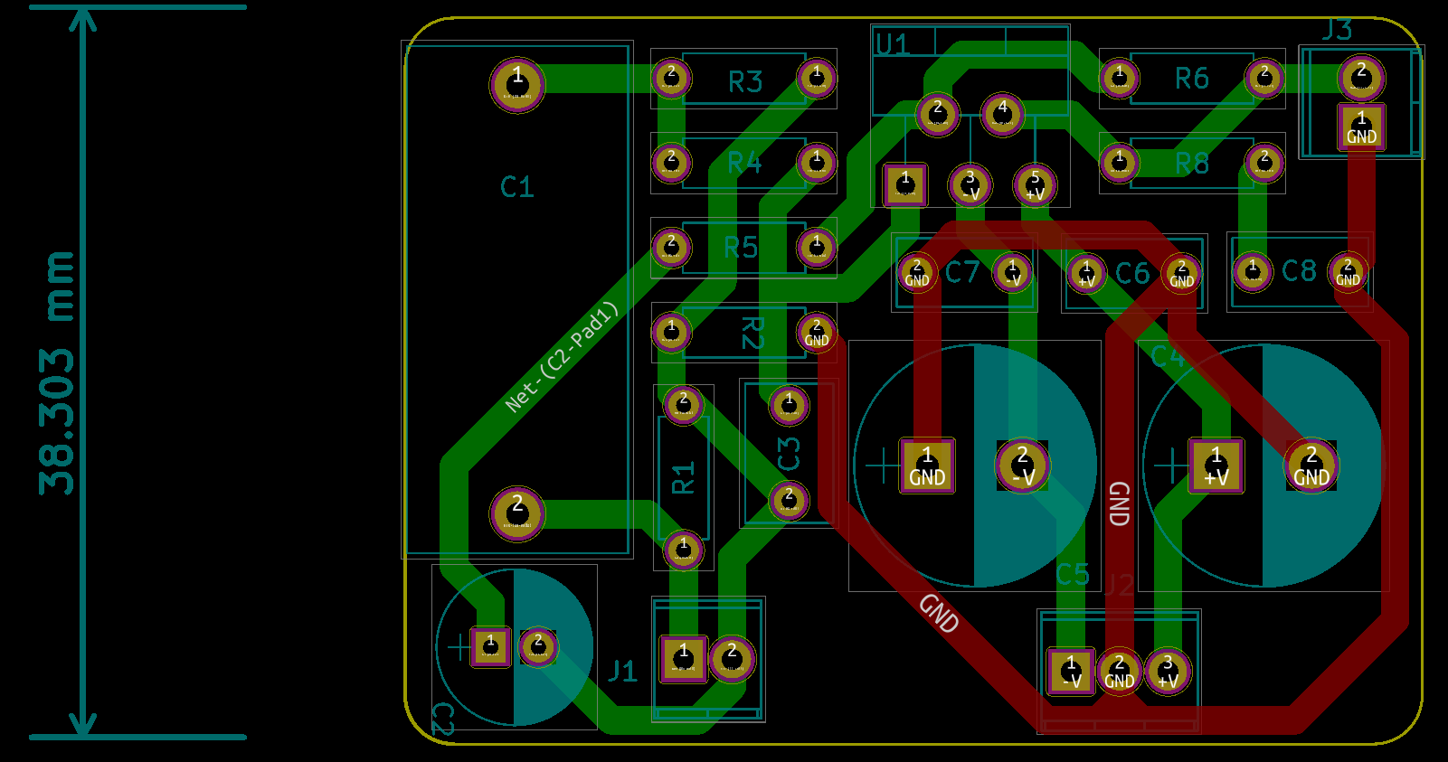

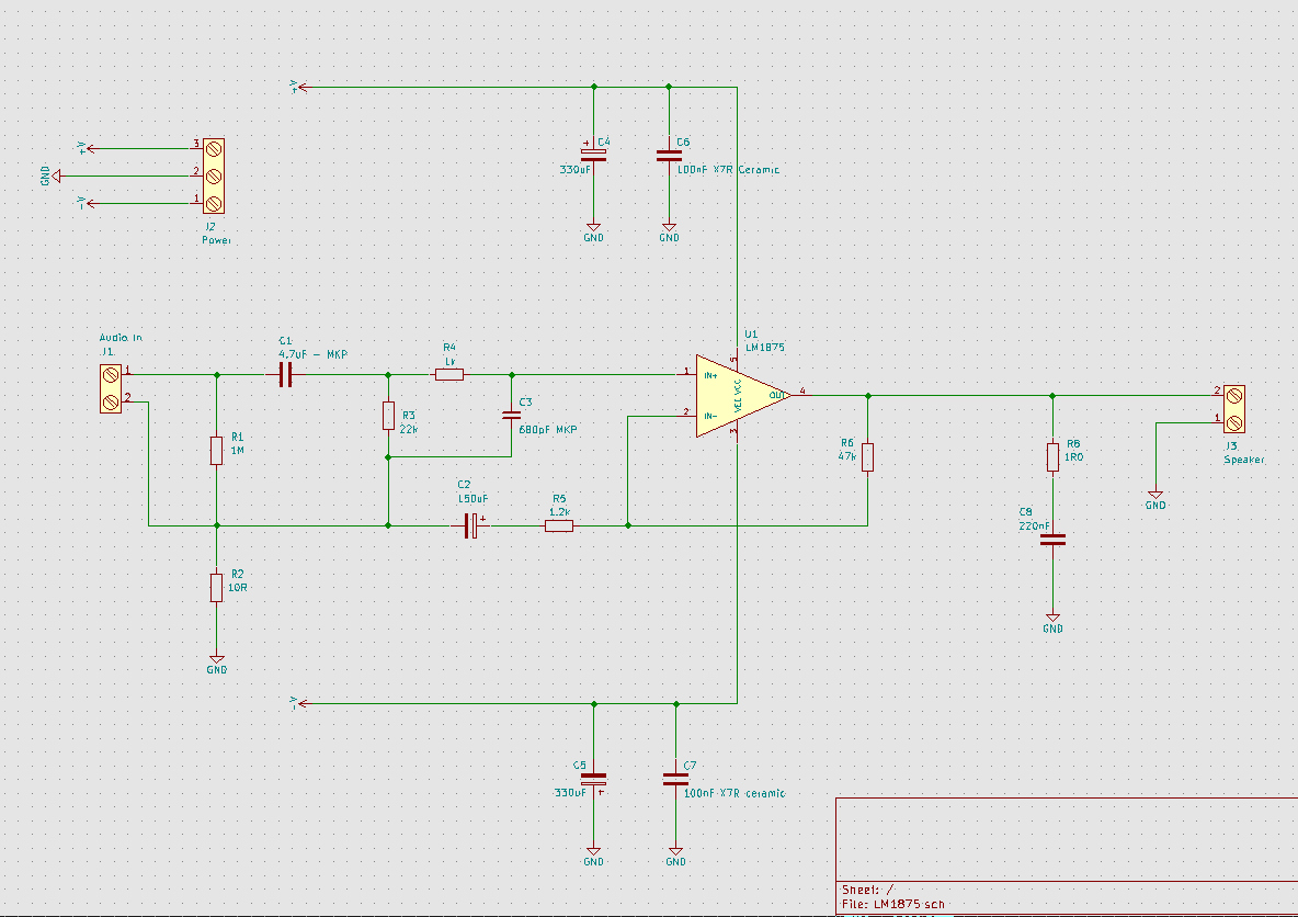

Hi all,
I've been lurking about here for a while now & would like to thank all the contributors to this thread (and others on the board...) for all the excellent information they've provided.
I'm about to have a go at building an LM1875 based amp & would really appreciate it if you guys could have a look at my schematic and board layout & let me know if I'm doing anything particularly stupid.
I've a centre tapped antek toroid (2x15V @ 2.67A) that I'm looking at for the power supply, am I right in thinking that this is going to be not nearly enough to feed two of these things in stereo?
Much appreciated
Jay.

Your 2x15Vac 2.67Aac is an 80VA transformer.
That is good enough for between 40W to 80W of total maximum power.
That easily covers a stereo pair of lm1875
Personally I prefer at least 160VA for a power amplifier due to the lower regulation offered and thus the smaller range of voltage between no load and quiescent load and maximum power load.
Your -IN input sees 47k for the DC current .
But you have 23k at the +IN input. Why?
Change that to 47k to match the -IN input and then reduce the input capacitor C1, to 2u2F
I seriously doubt you will be able to hear any difference between an MKT/MKS and an MKP. In my book smaller and cheaper is better.
A physically smaller capacitor here is more tolerant of interference.
C8 (the Zobel route) MUST tie into the decoupling ground between C6 and C7. Do not take it on a meandering route around the PCB. That long route adds inductance/impedance and ruins the performance of the Zobel.
+32dB (40times) is quite a high gain. Do you have a reason for going this high?
