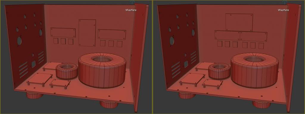

The header boards will be mounted horizontally at nearly 1/3 bottom of the heatsinks, You will see my populating project with the 3D images I'll post in a moment. I wait for your comments on it 🙂

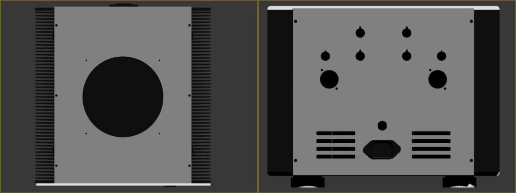

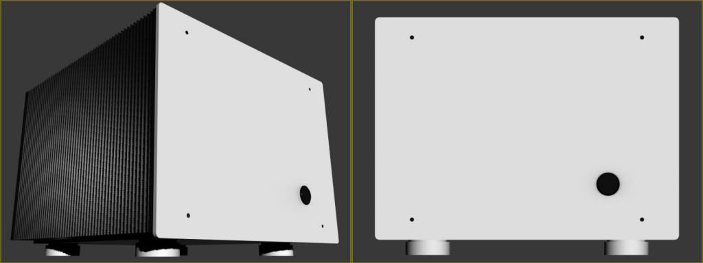

Here some picture of my future Enclosure, those are mainly 3dsmax viewport screenshots, I do not have made any lighting and rendering rig yet.
Front perspective and front.
Top and rear.

Inside arrangement (notice the cylinder on top witch symbolize the fan)
Two different arrangement for amp boards and fets, witch one do you think is the best?
Any comments are welcome!

I'm quite lost, since it seems that my heatsinks are a little on the weak size (300x210x40 with 32VDC rails) for my project, BobEllis suggested to use a fan to cope with the heat (I choose a 140mm fan at max 1000rpm).
Shall I forget about the fan and risk an overheat?

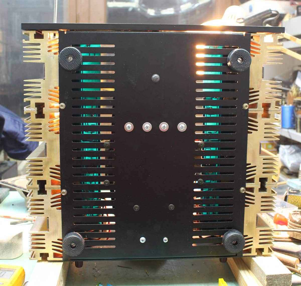

if everything is up to scale and I'm judging by it's looks by experience , I believe your heatsinks are good up to some 120-130W of dissipation per channel
if you aren't comfortable with temp at preferred Iq , make Babysitter - one lazy 12cm fan per side

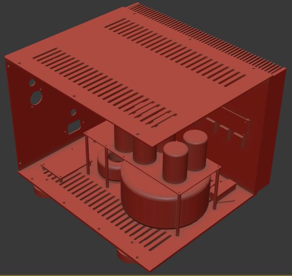

regarding holes - you need at least 8 times more then you drew , same size on bottom and top plate
blowing air through inside will not help much , regarding heatsink temp , fins are outside :devilr:

Well, I don't really know anymore what I should choose between air cooling (I already have the 140mm fan and fan controler) or passive cooling with airholes
My passive airholes proposal
I have to look for the price of the cut witch will be quite high with that much airholes (a total of 100)
