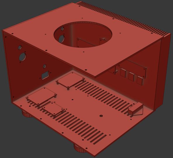

However, do you agree with Zen Mod about going fanless (Zen Mod, I don't disregard your advises, don't get me wrong), as it will cost me quite a bit more than the fan design I already planned?

point is that you don't need to scorch innards of amp
I'm not arguing with fan solution , just pointing that caps , xformers and even Jfets don't like oven temp - without fan
with fan - and tiny holes area , there is no benefit ............. while increasing uncertainty/eveness of air flow

you know - you can always put some risers between bottom plate and heatsink , same as between top plate and heatsink ;
say that 5mm around circumference will do the job
that way you can entirely avoid perforation of plates
Way to throw a wrench in the works ZM!![]()
Quite true 😀
However, Zen Mod, this is a brilliant idea, but I doubt the enclosure can keep its stability with gaps between plates and heatsink (think about bending at the spacers), and optionally it will be less sexy, so I think I'll stick on the last design I posted (Well I shall admit that I'm also a little tired tuning this damn thing 😛).

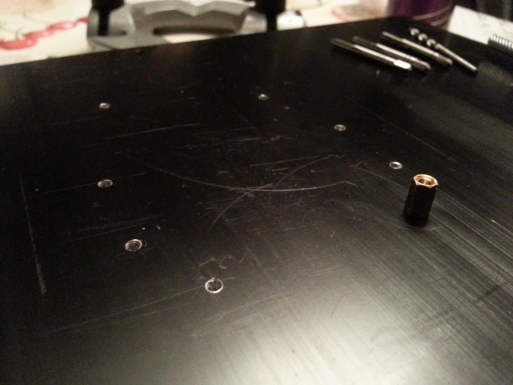

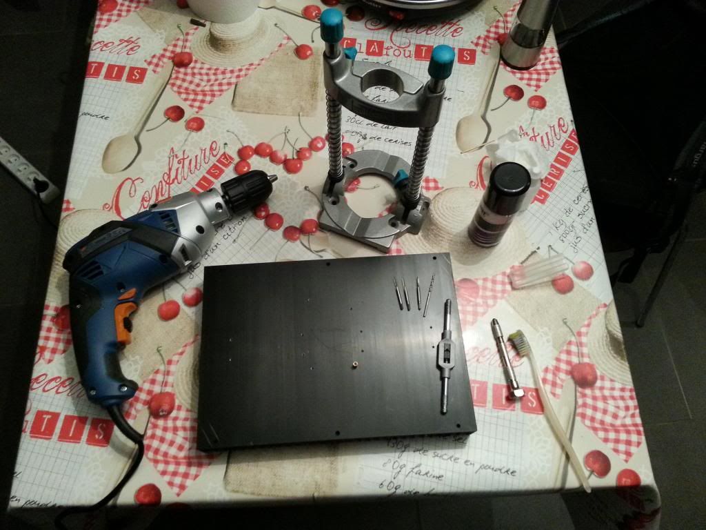

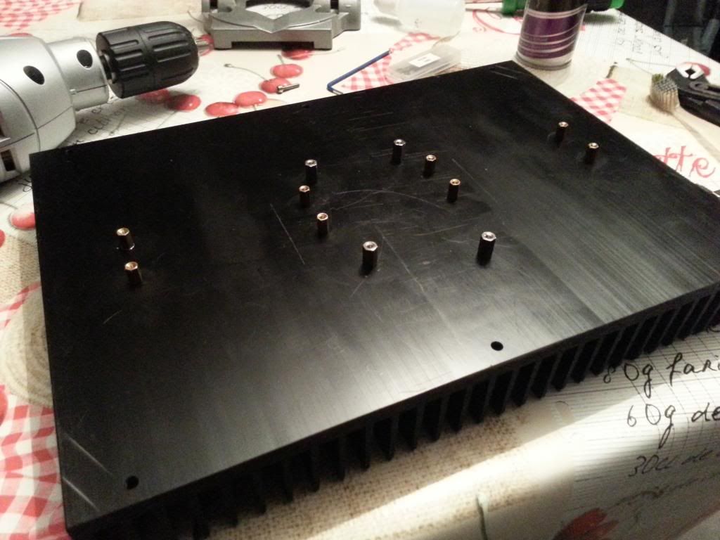

I started the drilling and taping process on one of my heatsink. I still have to drill the fets holes, but I need to do a test fit before.
