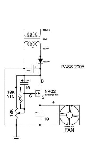

Not daft at all.
The circuit that is the current discusion will have enough oomph to get the fan turning on power up , and then, you need only adjust to pot to make the fan silent.
Any fan makes a huge difference vs. pure convection when your sinks are on the small side.
You'd need a resistor from gate to ground to form a voltage divider. Size the resistor to make the fan just start on power up, then the NTC would increase fan speed with temperature. The catch is does the temperature coefficient lower the resistance enough to keep up with the demand?
As this is a class A amp, actively variable fan speed is moot since the heat is pretty constant. Good concept for Class AB, though. Rod Elliot has a controller on his site that uses diodes as sense elements and a comparator to drive the fan control.
try like this
maybe it will need another pot (say 5K, wired as variable resistor)) , in series with NTC
to determine , in vivo

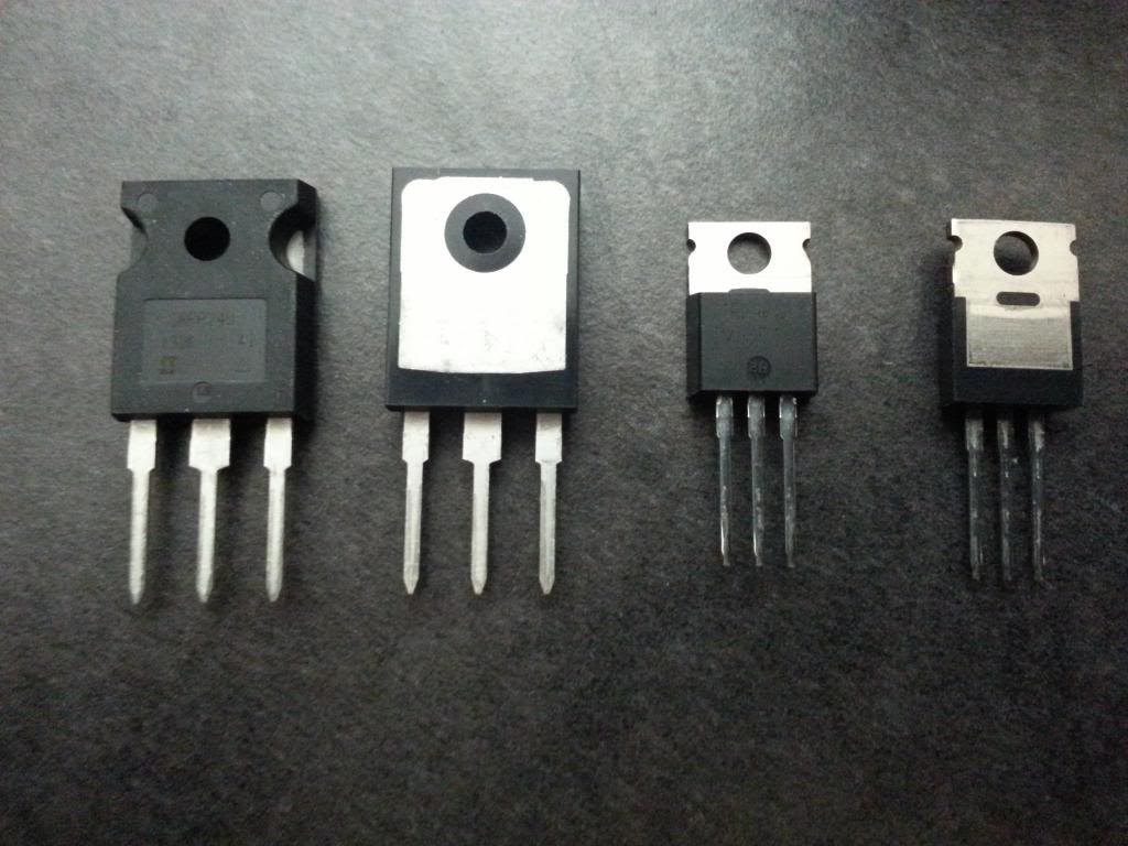

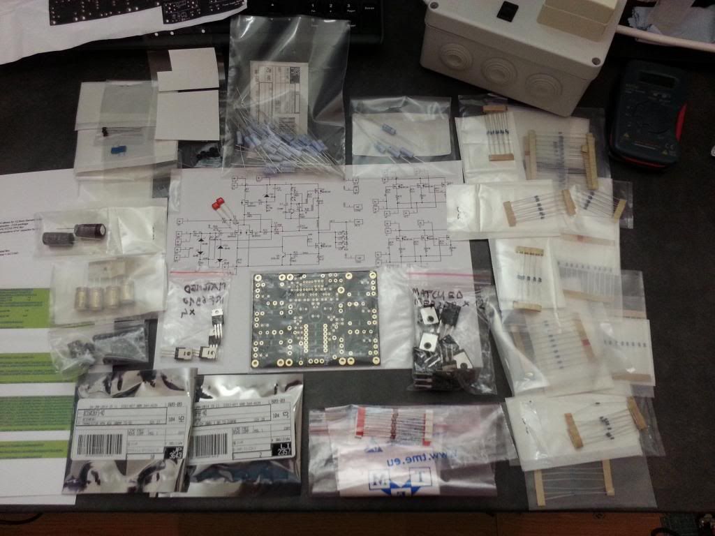

Here all the components:
NOTE: You'll see that I already have received the fets from HK (still waiting those of h_a), and they seem at least legit to me, although, I don't know of their matching condition, this will be a good opportunity for me to learn how to match fets. For this project, I'll use the irfp240 and irf6910 from h_a.

Q1 IRF9610 X1
Q2,Q3 Paired IRF9610 (from h_a on DIYAUDIO forums http://www.diyaudio.com/forums/swap...fets-your-f1-f4-f5-aleph-j-3.html#post2436167) X2
Q4,Q5 ZTX450 X2
Q8-Q13 IRFP240 sixlets (matched by h_a on DIYAUDIO forums http://www.diyaudio.com/forums/swap...fets-your-f1-f4-f5-aleph-j-3.html#post2436167) X6

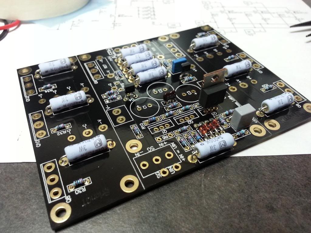

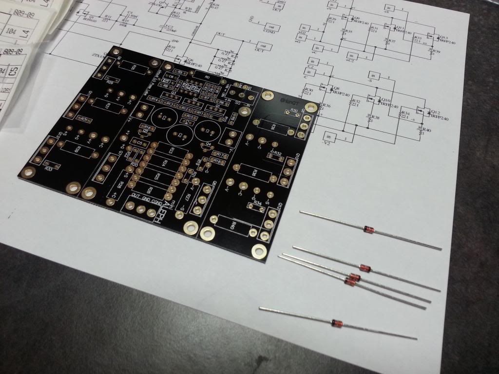

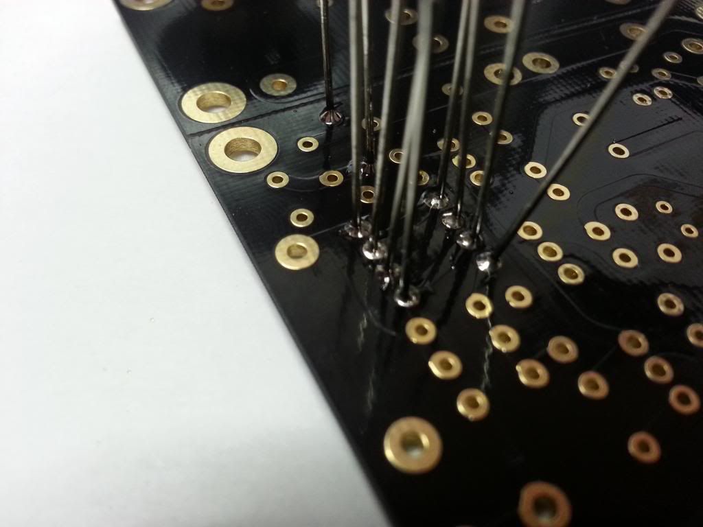

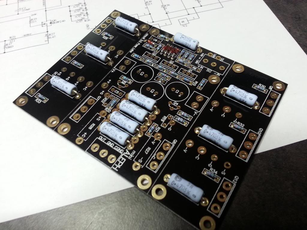

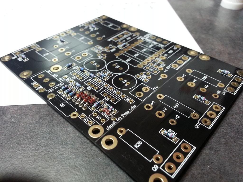

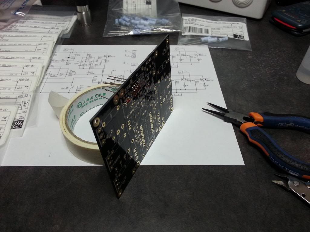

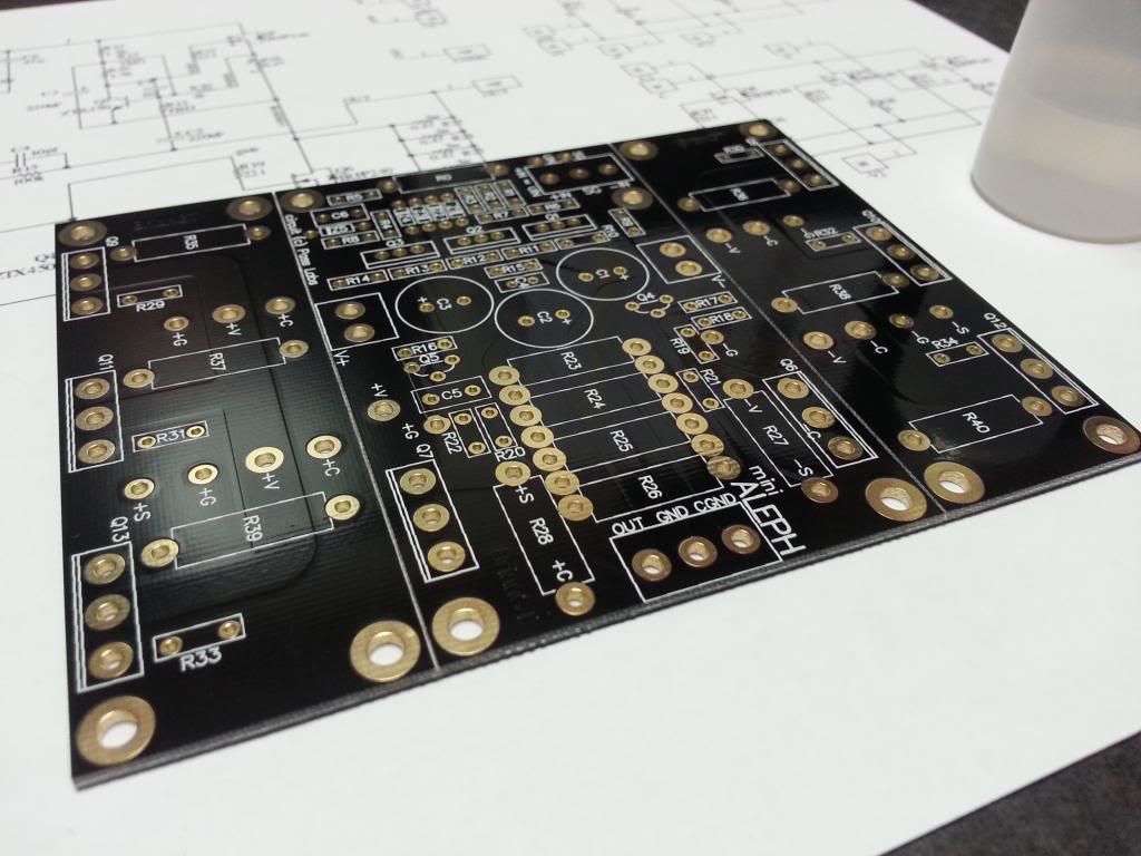

BUILDING:

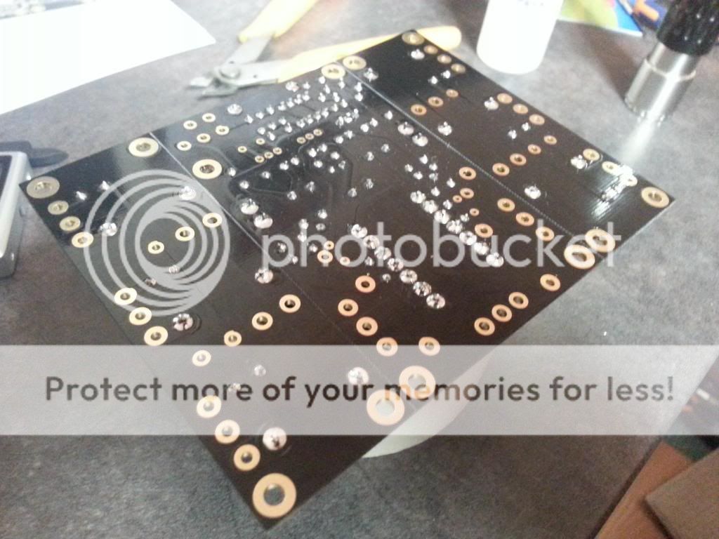

As for the PSU, I took the time to clean the contacts with isopropanol, I've cleaned the component legs too.
As usual, start with small components then go bigger.
This is my procedure for soldering (Z1-Z5 diodes) pay attention to the polarity.
Soldering the 1/2W resistors

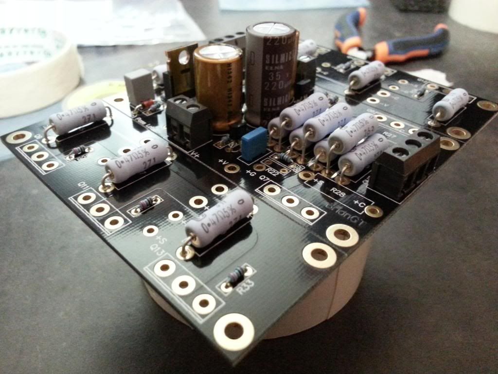

Soldering the 3W 0R47 resistors, I try as much as possible to solder the components with value upward, witch will facilitate troubleshooting

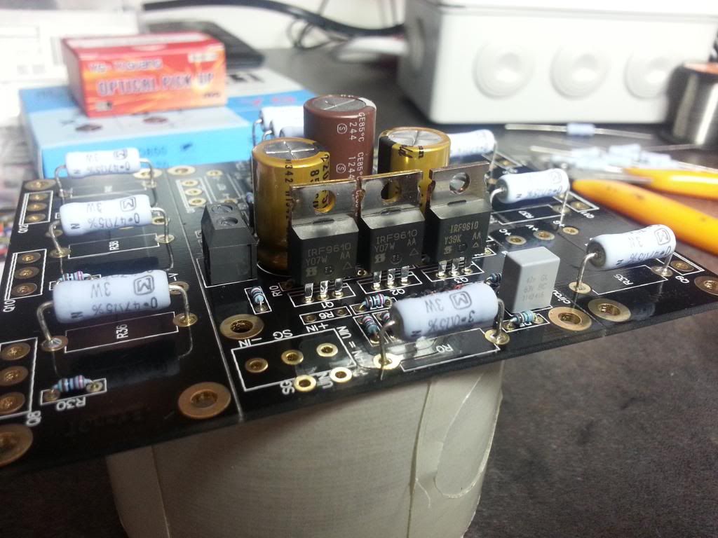

Soldering the film caps and non matched transistors (pay attention to the polarity of the transistor, Emitter, Base, Collector)
Soldering the Elco capacitors (watch for their polarity) and the V-/V+ terminal posts.
that's it for now 😀

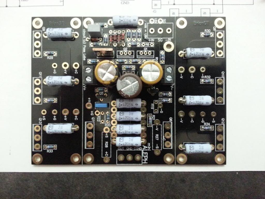

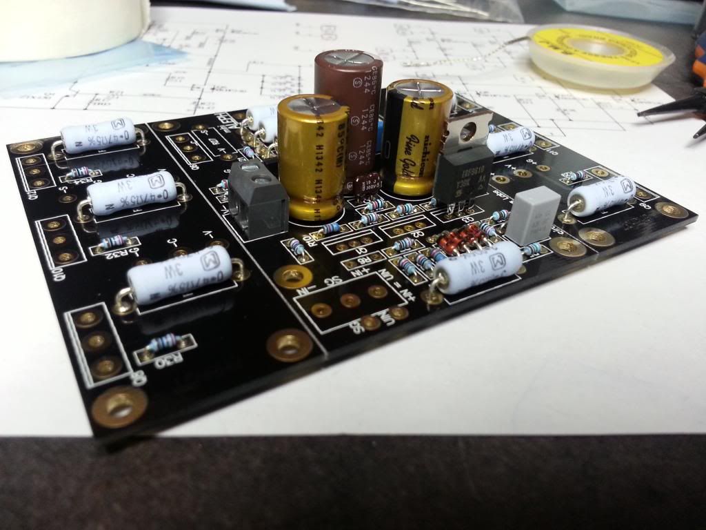

Here, a test fit for R47-R49, I think I must install R47 and R48, but shall I install R49?
I put the signal terminal posts without soldering them, I don't know yet if I will use them or not.

Like this
nice

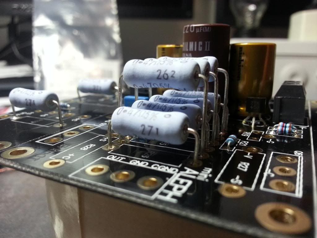

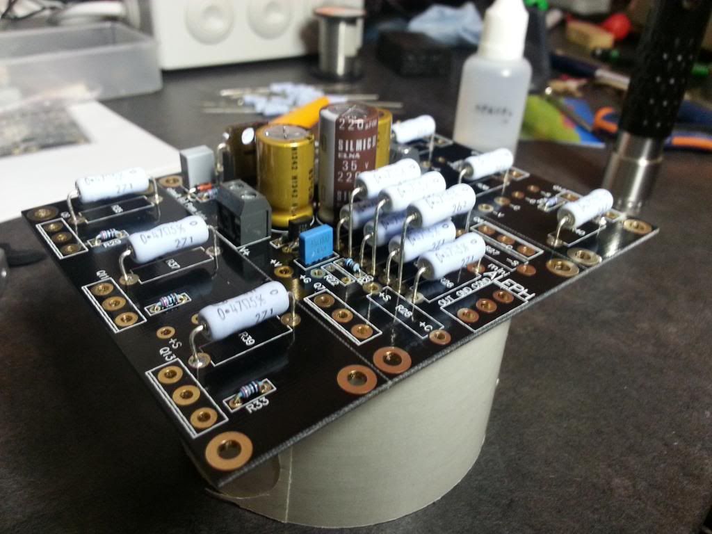

next time rise those 3W Pana at least 3mm from pcb
Thanks a lot for this advice, I have lots of 0R47 res at hand, I will change them (with the 3mm gap) and use the old ones on upcoming project 😉
I put them flush on the PSU too, is it really a big problem here too? Must I change them? (Just note, that the big fan will blow right at the psu)
Zen Mod, as a teacher myself (in CGI, not electronic, everybody would have noticed 😛) I can't demand my students to be "good" students if I won't behave like one myself.
So, here we go!
Just a little piece of card board for separating the res from the pcb😉
Un-soldering job was quite easy, thanks to the incredible quality of Brian's boards.
