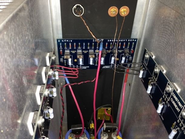

I'm thinking about pre-transformer stage, do you think a filtered Iec inlet will be a significant addition or a standard outlet suffice?
Also, do you think I shall consider a softstart module to moderate inrush current inside the psu?
If you have an IEC with a filter, and it's rated for 500W or more, it's not going to hurt anything.
The softstart is nice, leave room for it, but don't try to do it with the rest of the build - you can add that complexity later.

My advice is just this... you need BIGGER heat sinks. Alephs run HOT.
unless you can dedicate 1 of the heat sinks you pictured for each mosfet you mount... (2 with a fan) - you're going to have problems.

ZM, i realized that after drilling and tapping 12 holes! (actually... 24!)
The problem was my drill press didn't have a deep enough clearance to mount the FETS in the middle of the sink.
Only upside is it's such a massive heat sink it's not really that much of a problem.

Well, of course I got two heatsinks (one per channel) and I plan on using a 140mm fan (silent one) to cope with the heat 😉

On the PSU for R1 and R2 (bleeder resistors) I took 2.2kohm 2W resistors, should I better use 3.3kohm 3W instead or the 2.2k are sufficient?
At 30V rails your 2K2 resistors dissipate .4W (V^2/R), so are adequately sized. You could go with 3K3 and the discharge rate would be a bit slower. Either is fine.
Thank you BobEllis, although I've already ordered some 3.3k 3w along with some thermoresistors (EPCOS cl60 equivalent) I'll be able to begin the build with what I have already on hand 😀
