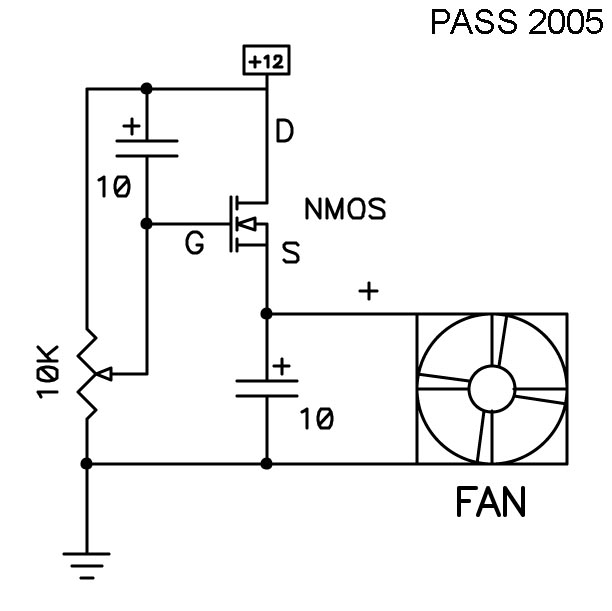

Save yourself a transformer and the fan controller - use the same transformer for protection circuit and fan. Set it up ct, use a bridge for +/- and a single 1n4007 followed by a small cap for the fan supply. You can make very simple fan speed control with a pot and a mosfet. You can add an extra cap across the resistor to help starting if slow speed operation becomes a problem. All fits on a small piece of perfboard. Layout not critical.
Papa posted a circuit for this many years ago, I will try to redraw it when I get home, but will try to describe it;
1N4007 and 100 uf (value not critical) cap create a ~9V supply from a 15VAC winding and ground.
10K pot connects across the 9V and ground. Can be single turn, 10 turn or 25 turn if you really like turning things.
To +9V connect the fan +
To fan - connect the drain of an n channel mosfet. General purpose anything like IRF610, IRF510, etc. (to name what's in my parts bin)
Source of mosfet to ground.
Wiper of pot to gate of mosfet.
1-10 uf from mosfet gate to V+ if needed to help startup.
The voltage at the mosfet gate controls current, which is controlled by the voltage divider created by the pot. The cap from V+ to gate creates a spike on turn on that will give the fan plenty of juice to start and then drop down to a lower running speed.
Thanks a lot BobEllis, I think I will learn a lot with this project and everybody advises 🙂 (even if some of them are still little obscure form me right now)
I'm eagerly waiting for your drawing, but I will try to understand the concept from your description.
