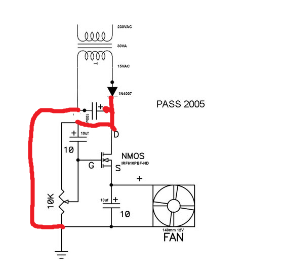

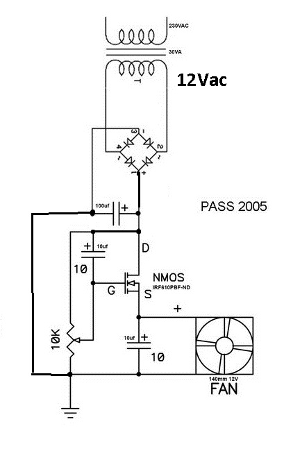

I'm in the way of building the Fan controler board, here's the schematic adapted to my configuration, I'm not sure for the 4007 diode and 100uf capa, I know the diode is meant to drop a bit of voltage and the capa to smooth it, but I wonder about the polarity.
Thanks Zen Mod, I know that my lack of knowledge can seem shocking at time, I'm learning.
However, My transformer is a 2X15vac, witch is mainly meant to feed two HP protection boards, I just want to chip out the 15vac from one of the board and lower the voltage to something near the 12vdc needed by the fan before the speed controler.
BobEllis spoke about a 1N4007+100uf capa to drop the 15vdc to 9vdc. http://www.diyaudio.com/forums/pass...ld-aleph30-needs-some-help-3.html#post3786213
What I was trying to describe was a half wave rectifier. Omit the bridge, tie one side of the transformer to ground then connect the other to the diode. Add a cap and you are at roughly 0.667 x VAC. The way you had it drops 0.7 V. Nine VDC is probably enough to get your fan to start reliably. You can further slow it with the controller.
If you really want to use a bridge, 15 VAC is on the high side but the MOSFET can drop that down to something less than 12v to keep your fan quiet. You probably want a heat sink on the MOSFET.
No the 100 uF goes across the cd to smooth the ripple.
And the pot also goes across the DC as in ZM sketch
Do I got it right?
Like this
Arf, crossed posts 😉
But I'm glad, I got it right 😀
Thanks a lot BobEllis / Zen Mod
