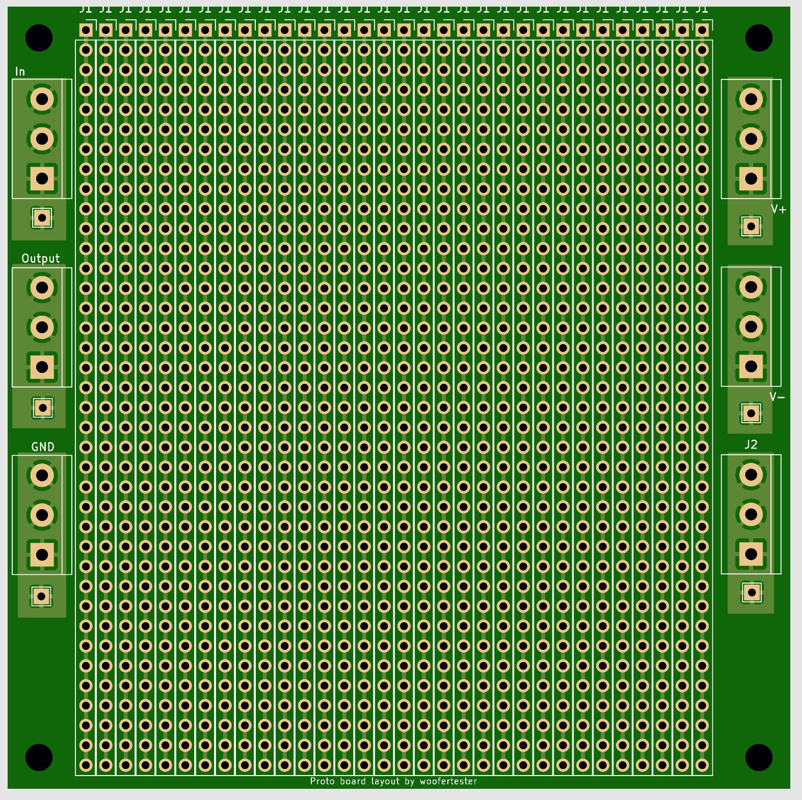

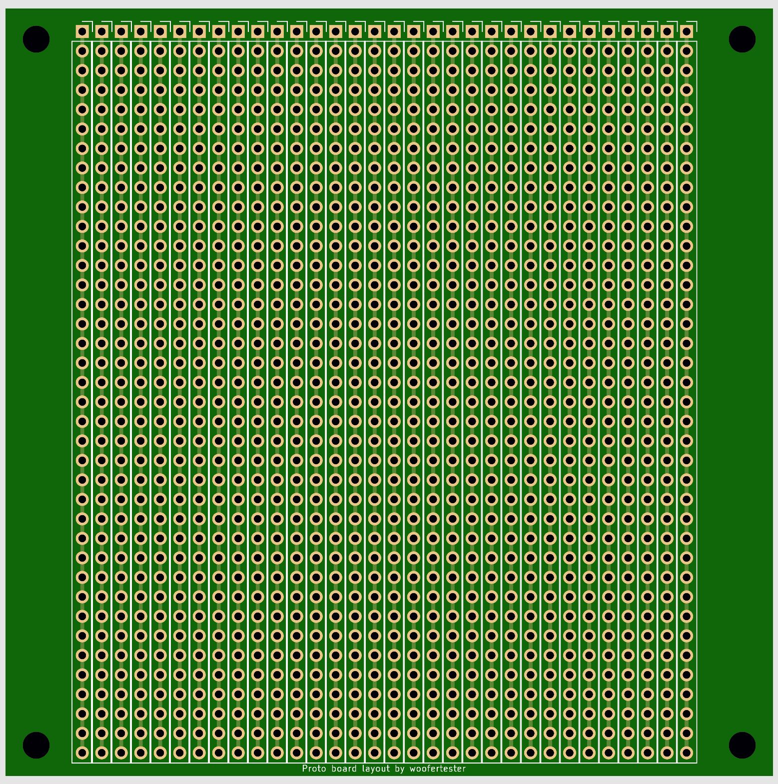

Swiss Army knife PCB for buffer building
I have wanted one of these for a long time. This is a good reason to create one.

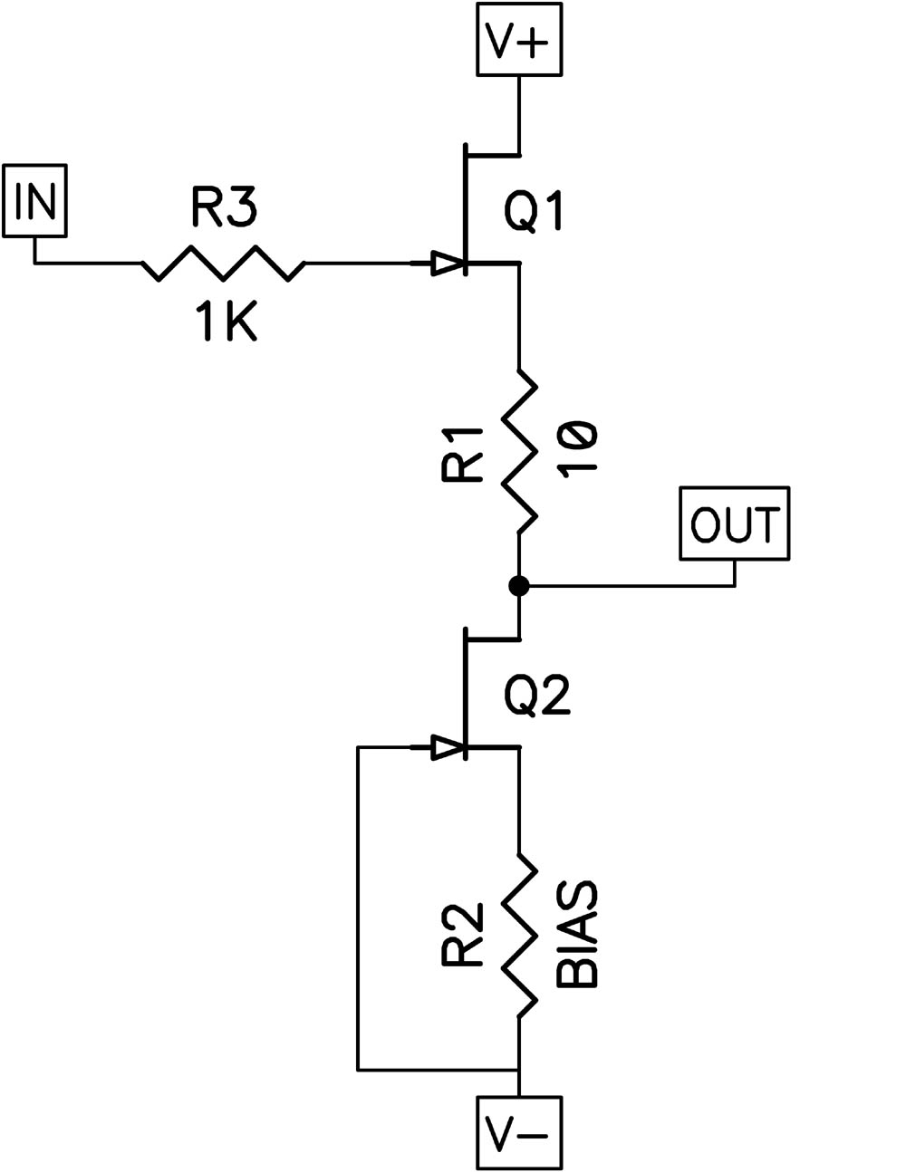

Bigger resistors will not solve a power dissipation problem. The circuit will have to be redesigned to add source resistors for local degeneration. This will lower bias current and may increase output resistance.
For now, just live with the J175 operating its power limit.

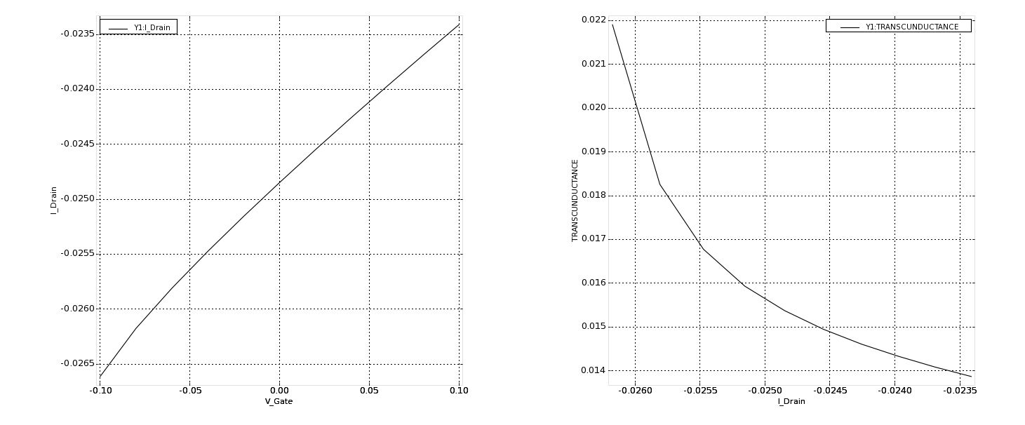

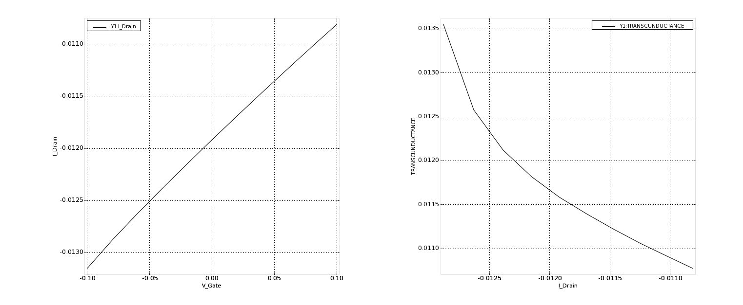

Below is the basic schematic for a CCS beast cell. R3 is just a gate resistor. Any value from 200 to 1k ohms will fine. Nelson's micro-beast uses 470 ohms for R3.
For good linearity from the J113 jfet, Nelson's bias resistor, R2, is 47 ohms for 10 to 15 milliwatts dissipation per J113. Even at that dissipation, I can't keep my fingers on the jfets for more that 10 seconds. So heat dissipation needs to be taken into account.
Lastly, R1 is 47 ohms. One drawback of the J113 jfet is Idss values range from 7 to 30. So matching J113s is important.
