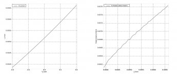

I have bought some 208s and 209s to evaluate. I also have a SOT23 socket so I can do some curve tracing. Picking up the part and placing it in the socket is a challenge.
The 2SK208, 209 and 2145 have power limitations. That is why I am thinking of using the GR grade parts. Just use many more of them. They are small and can be packed tightly. If the GR parts are used, Vds can be set to the datasheet maximum / 2.

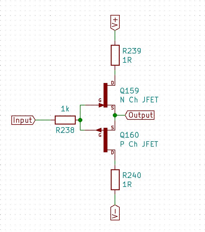

Are all the Resistors the same? And will you show a schematic for the cells.
Complementary buffer cell schematic attached.

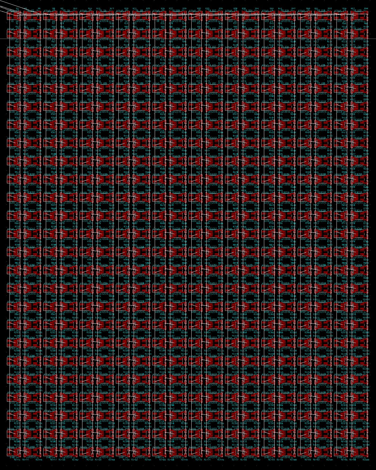

B1 power amp version
Here is the layout of a B1 power amp version using the 2SK2145. This is just the inner part. Terminal blocks and capacitors not added yet. Board will be 6 layers.
500 pcs of 2SK2145. 1000 JFETs total.
Dimension ~ 160mm x 210mm. After adding terminal blocks and capacitors, dimensions should be 210mm x 210mm.
Maximum power dissipation is 300mW for the entire package of the 2SK2145.
I think that the decision is what grade of 2SK2145 to populate. The Y grade or the GR grade. What voltage for the rails. 12V?
If the Y grade parts are used, voltage rails could be + / - 24v
Discussion welcome.

I would use Y grade, without any source resistors; Idss spread ignored, as good enough (1.2 to 3mA), so with 500 cells you can expect at least 1A of Iq
output DC offset taken care of with preceding buffer stage
rails voltage - depending of intended use
though ...... maybe it is better to build proper big amp ...... it makes sense up to 100 cells ( purpose cans), everything above that could be just show off, which is already made
I mean - I'm not expecting better sonic results than with, say , M2 or many other candidate OS-es, when going in OS made for speakers territory

Thanks for the advice. My initial thought is also Y grade.
Making this into a power amp is interesting to some people. Some benefits compared to a proper typical output stagepower amp.
JFET is lower distortion than MOSFET
No heatsink required
No feedback
Self-biased. Any adjustment is just removing one or more resistors.

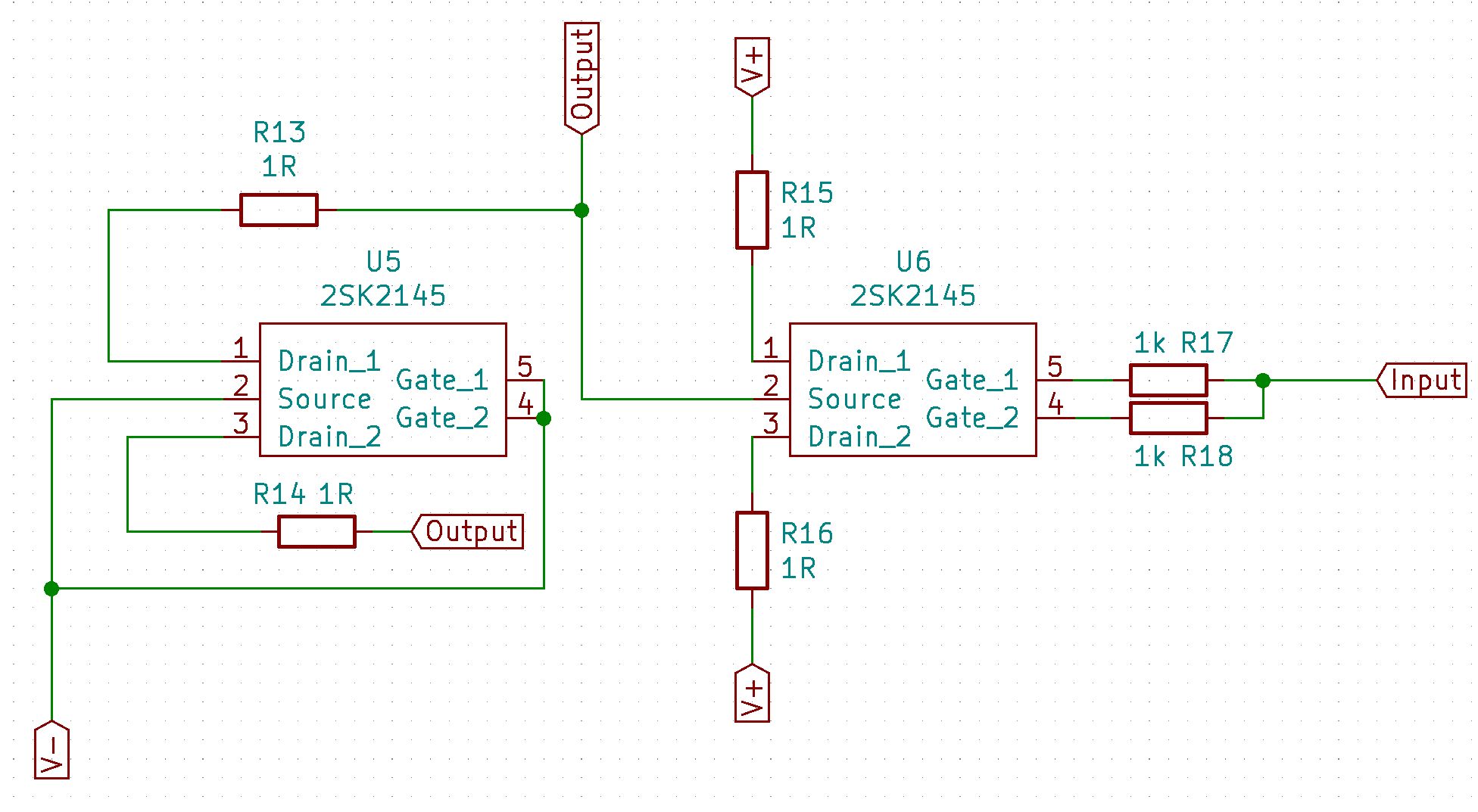

In 2012 member bcarso measured that 2SK2145 has interchangeable drain and source, his conclusion at Discrete Opamp Open Design post #530.
Seems it is possible to create a B1 cell operating at Idss with a single 2SK2145 or 2SK3320 (same die smaller package).
That is a slick trick. Thank you for sharing. I believe that prevents me from disabling the lower half of the buffer for purposes of adjusting output voltage offset.
I wouldn't dare to flip JFet, to mimic polarity counterpart
probably just from me being clueless, but better safe than sorry
- if that was meaning of explained
I am not sure if I understand your "mimic polarity counterpart". Flipping the part only interchanges drain and source. It does not interchange N-JFET for P-JFET.
For the 2SK2145, if drain and source are interchangeable the way 2SK170 is interchangeable with drain and source, you can make a B1 buffer with one 2SK2145. It is a very clever trick.
I can add a source resistor on the current source which brings the resistor count to the same as what I already have laid out.
A jumper can also be used there to allow operation at Idss and disconnect option of the lower half.
