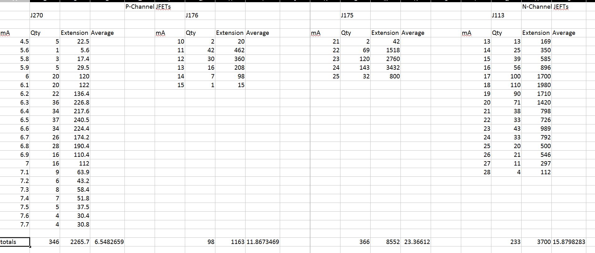

For Idss, my J113 devices are all between 14mA and 28mA. I have tested hundreds. I bought a bag of 1000. Slowly working my way through them.
My J175 devices are between 20mA and 24mA. I have tested 100. More are on the way.
My assertion is that the combined Idss of each 1/2 of the buffer must match. The parallel buffer elements are all connected at the output.
So, there will be a PCB for un-degenerated FJETs like the J270 and 2SK304. That pcb is on the way to me. There will be a pcb for degenerated JFETs like the J113 and J175.

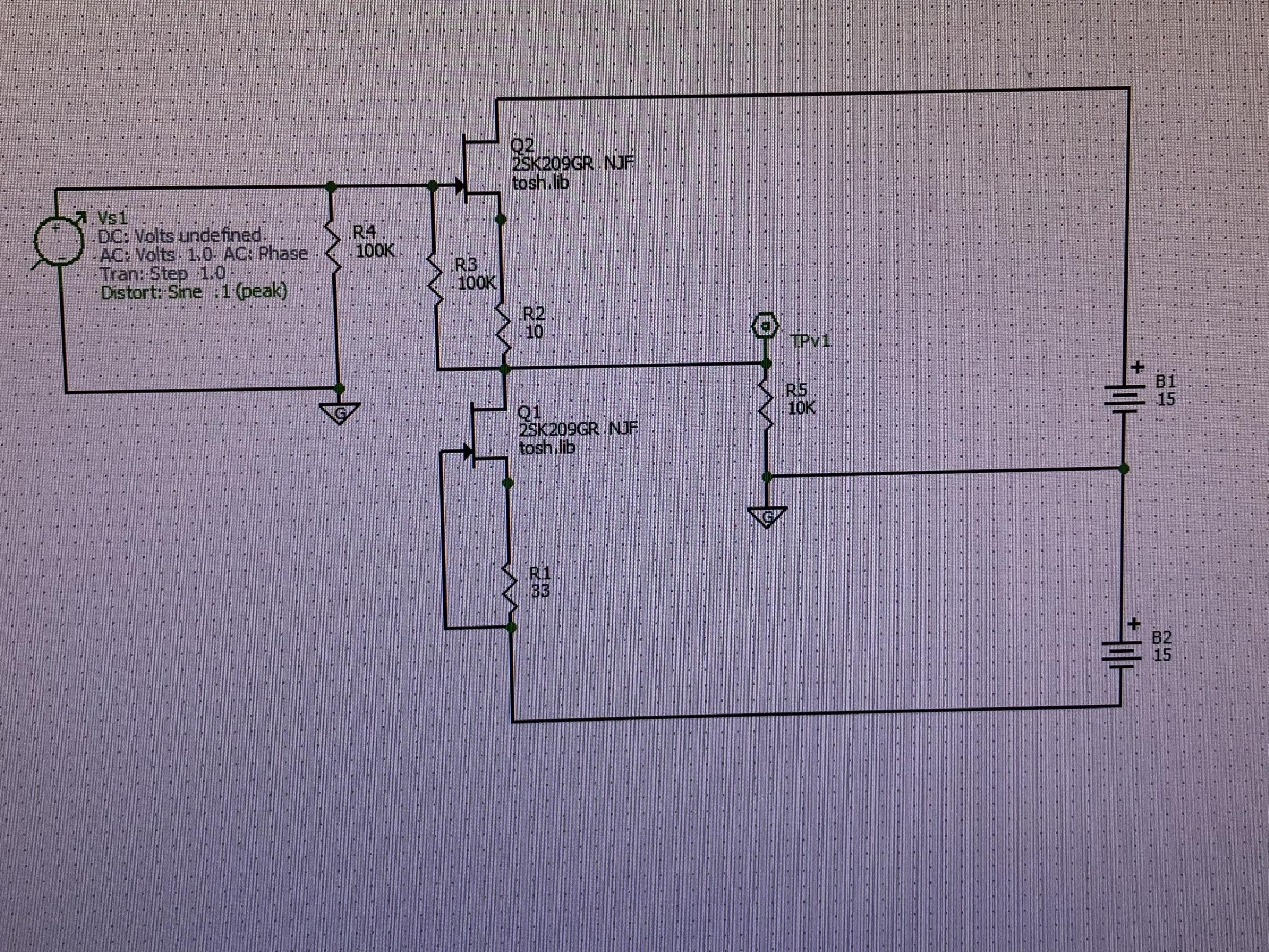

Here is another possibility for CCS mini-beast using the Toshiba 2Sk209 GB jfet. This design was suggested by Wayne from Pass Labs. Remove R4, R5 and add a gate resistor to the input:

I agree that a 2SK209/2SK208/2SK2145 massive B1 is a great idea. The trough-hole version is first on my list to build. The surface mount version for me will have to be assembled at a contract manufacturer.
Rochester has good candidates for through-hole JFETs. I have ordered some to evaluate. I will also build J113/J175 through-hole versions.

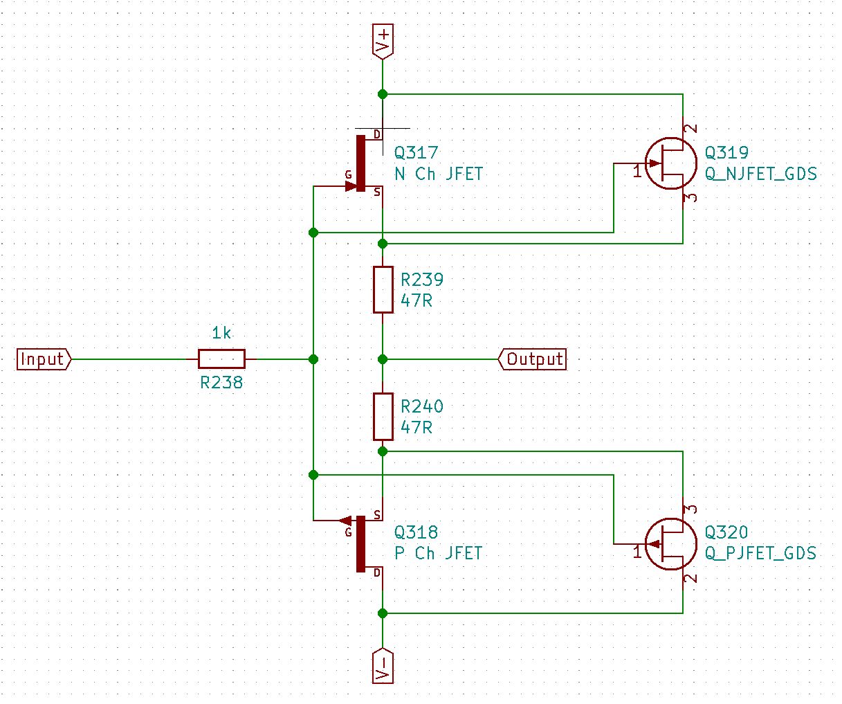

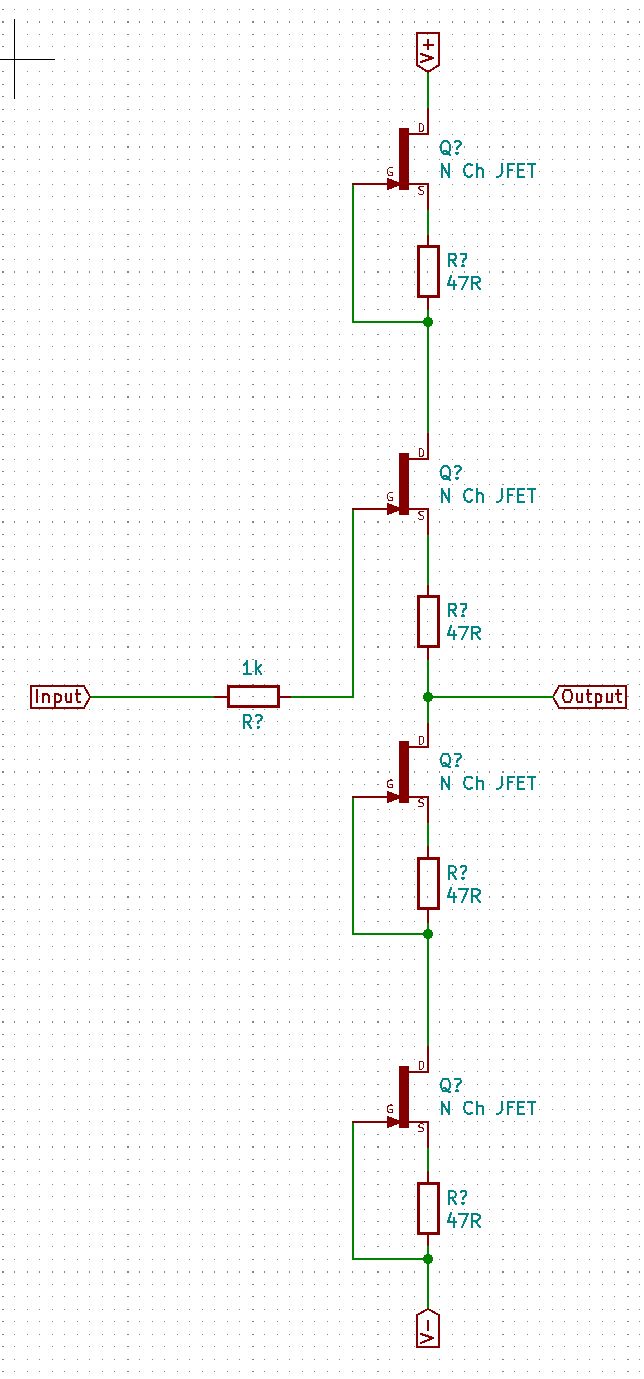

After new information from Biosonar, I have changed the basic cell. Here is the schematic.
I have added G-D-S transistors. The original transistors are D-G-S. Now the builder can choose D-G-S devices or G-D-S transistors. You can choose one of each.
The J113 is D-S-G and the J175 is D-G-S. These two can be used with this new board.
B1 Mini Beast
Both D-G-S and G-D-S pinouts are supported on this Mini B1 Beast

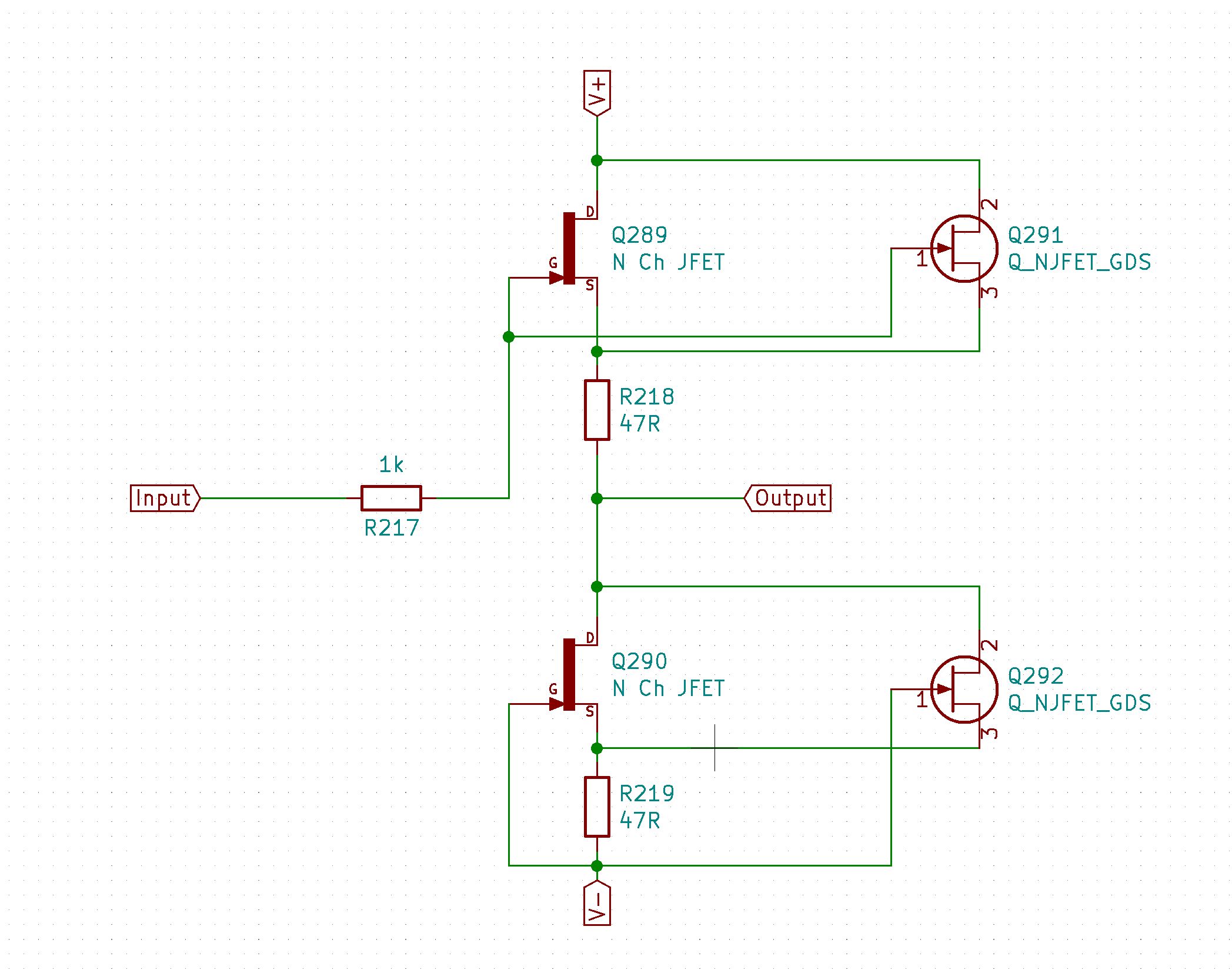

You can also use all P-JFETs if you reverse the power supply polarities. Aye, Keptin. Reverse the polarities.

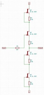

Series B1 for extended voltage?
I have found a surplus JFET that is reasonably priced and has good gm and low noise. The limiting factor is that the device max voltage is 15v. If I want to use + / - 15v rails, is this a reasonable approach for the basic cell?

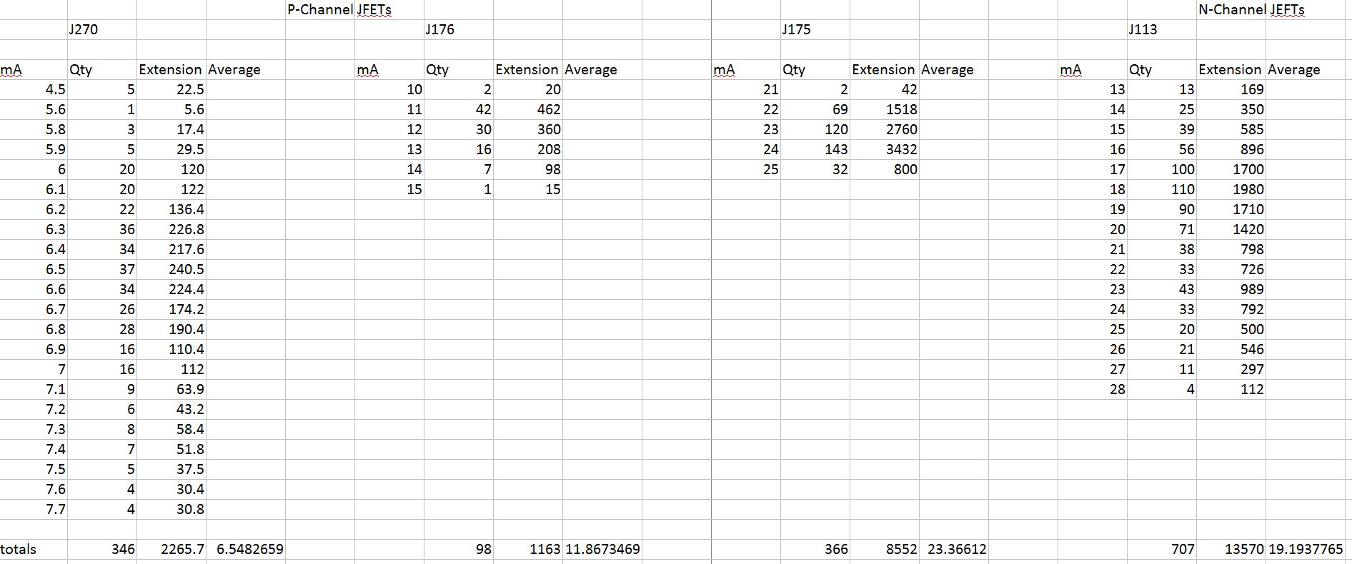

JFET Idss comparisons
Attached is a table of P JFETs compared against the J113.
There are no close matches.
My method will be to populate all of the lower Idss version, N or P and then populate enough of the other version, N or P to make the total Idss of each half close enough for very low output offset voltage.
This is for the complementary version. I want to be able to have a complementary version as well as a single ended version.

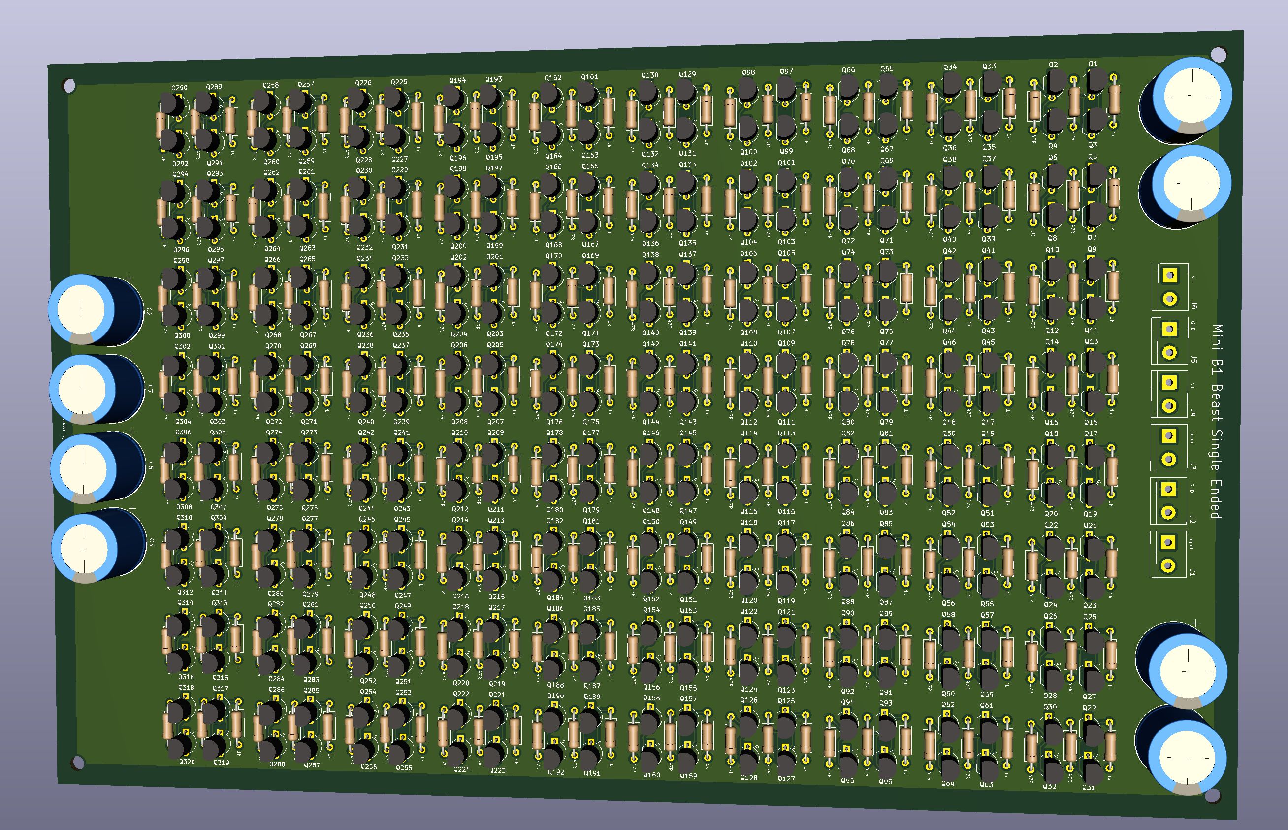

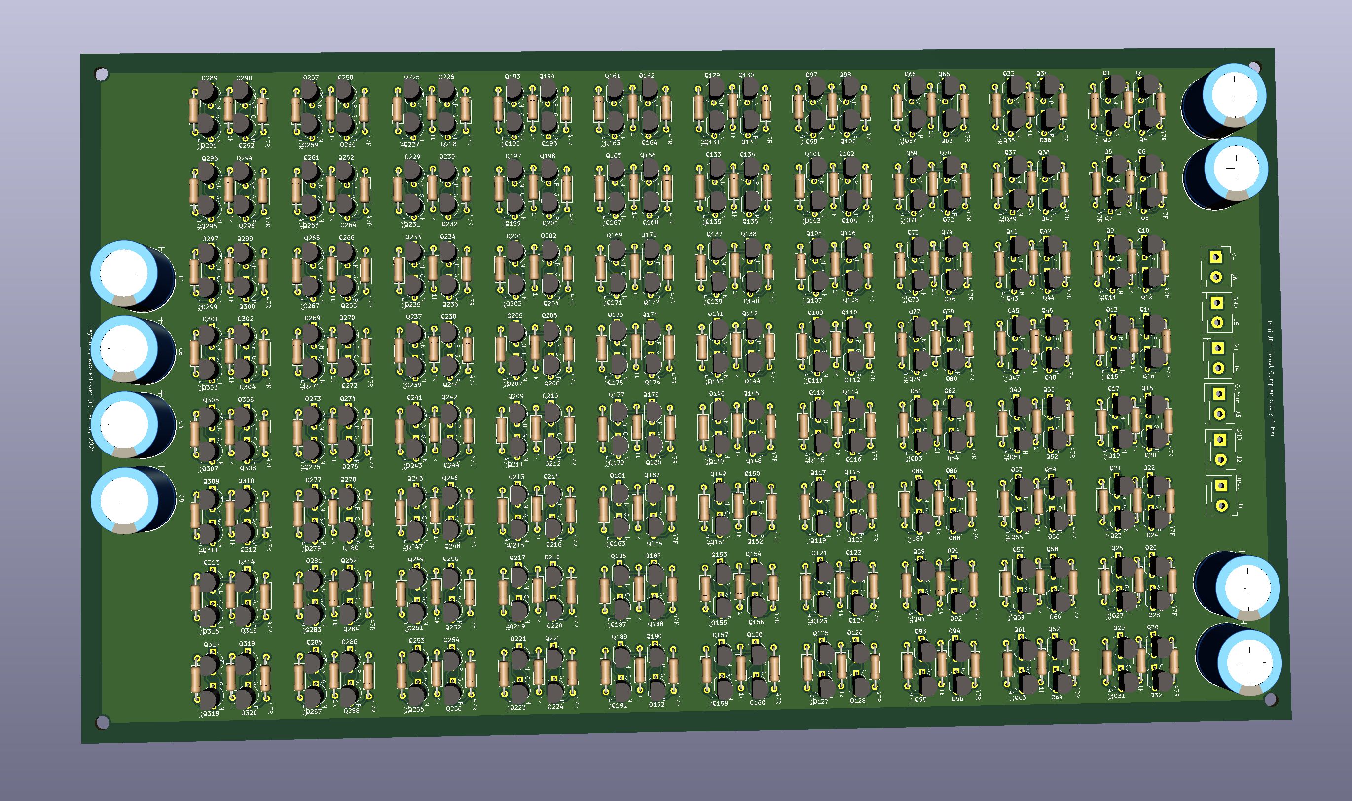

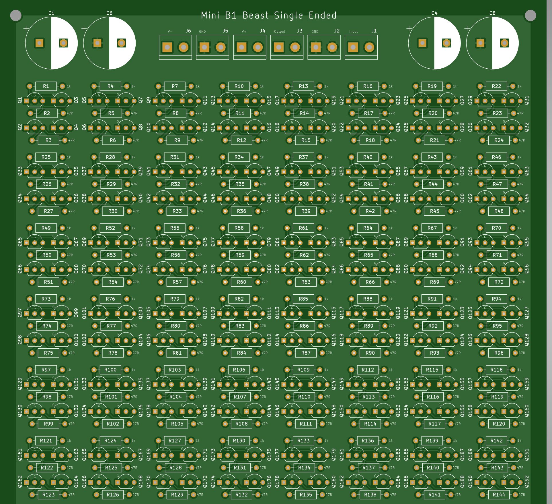

Single Ended Beast final layout
Updated silk screen. These final boards are universal for any pin-out of a JFET. You can have different pin-out top and bottom. D-G-S on top and G-D-S on bottom. Or vice versa.
You populate one JFET on the top of the cell and one on the bottom of the cell.
No need to identify P or N JFET. The board is populated with all N or all P.
