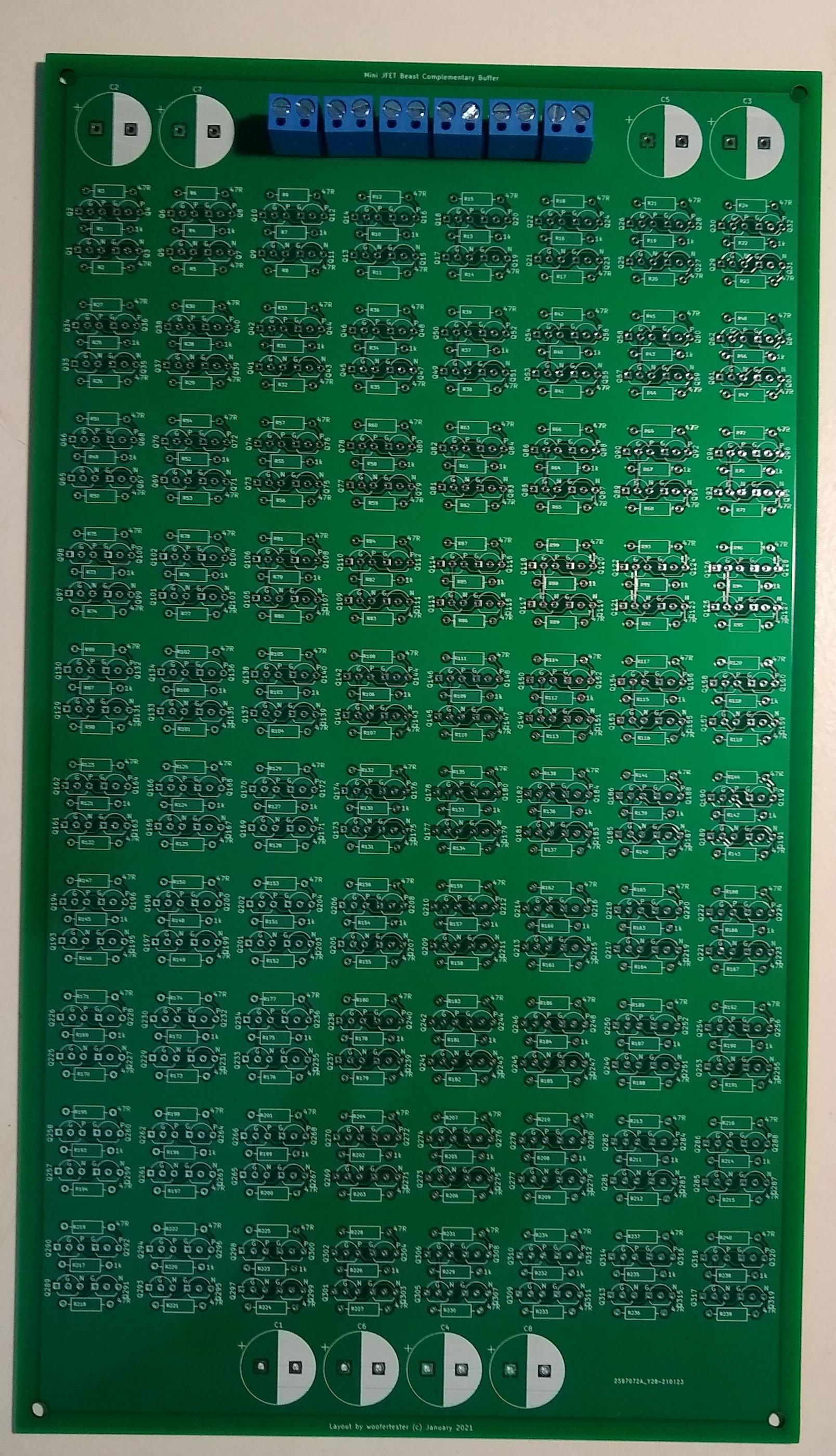

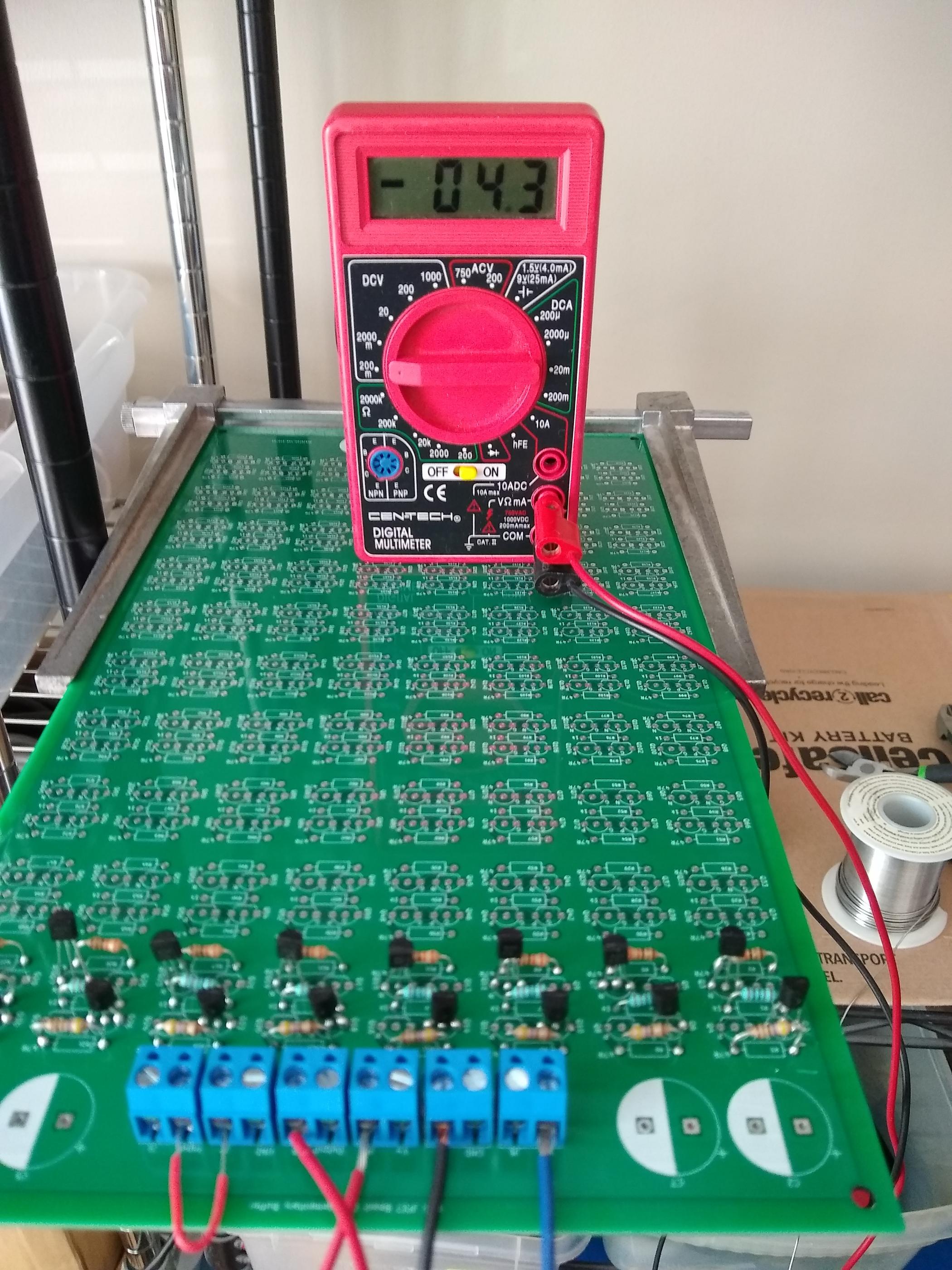

This PCB just arrived. It is the 3rd generation. It is the first PCB that I actually like the layout and the flexibility of using any JFET in any position in the circuit.
Just mounted the terminal blocks. I will install one pair of devices and have a look.
The silk screen lettering is too small but not a reason to re-spin. The resistors should show up tomorrow.
The devices will be J113 and J175 which are available from distributors today.

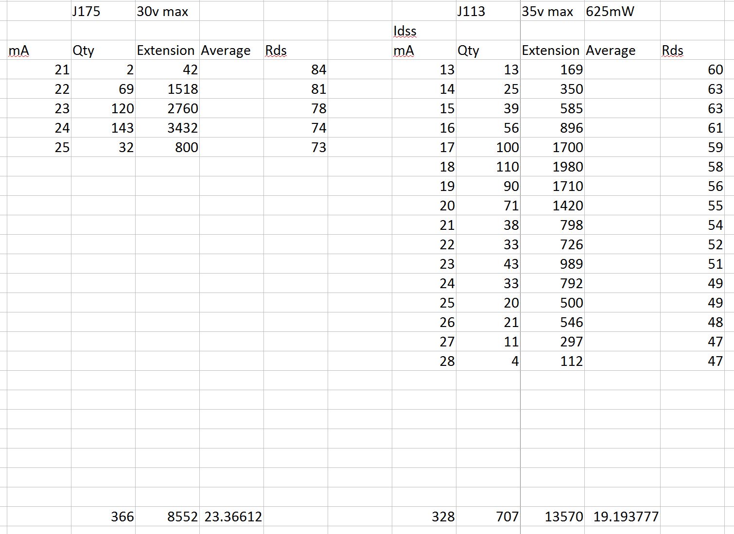

Interesting discovery. After measuring Idss of many JFETs, I am working on identifying some matched pairs for bringing up the PCB with just one or two pairs.
The matched pairs are no longer matched after placing the source resistors. After some trial and error, a good first approximation is to use a 33 ohm source resistor for the J113 and 47 ohms for the J175.
Good thing I am doing this work on a plug-in board.
Maybe you need to match for both Idss and Yfs, or employ the source resistor when you do the matching measurements.
If you look at post 226, I enumerate Rds. Rds ~ 1 / gain. There are no gain matches.
I pulled out a matched pair of Punkydawgs K170/J74. J74 Rds = 32 ohms and K170 Rds = 43 ohms. The ratio of gain N / P for K170/J74 is not 1.
I think that this is one reason you often find a pot as a source resistor in a K170/J74 pair.

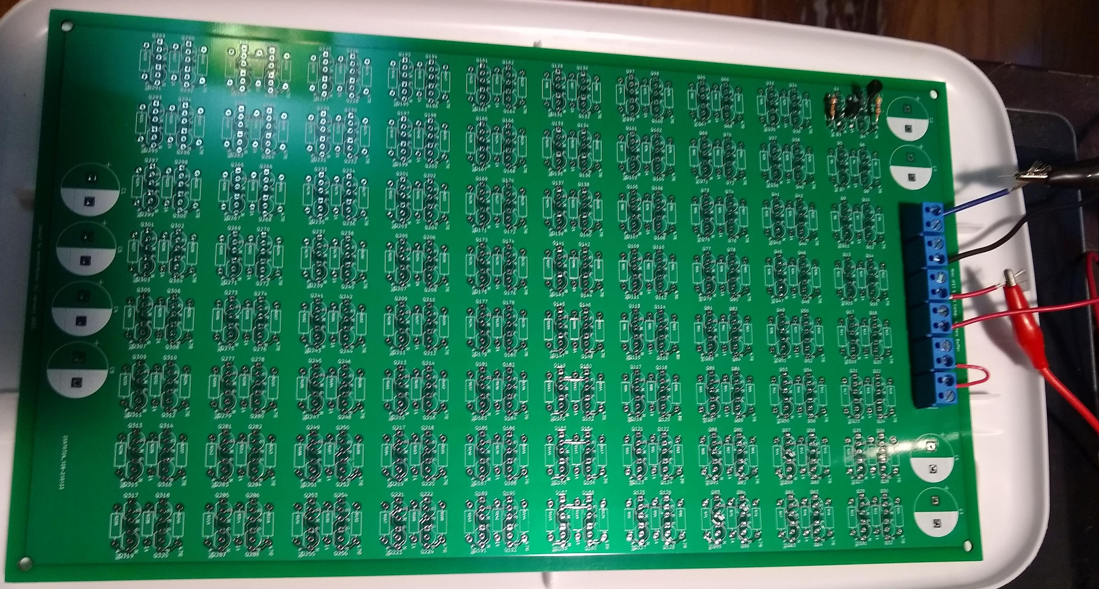

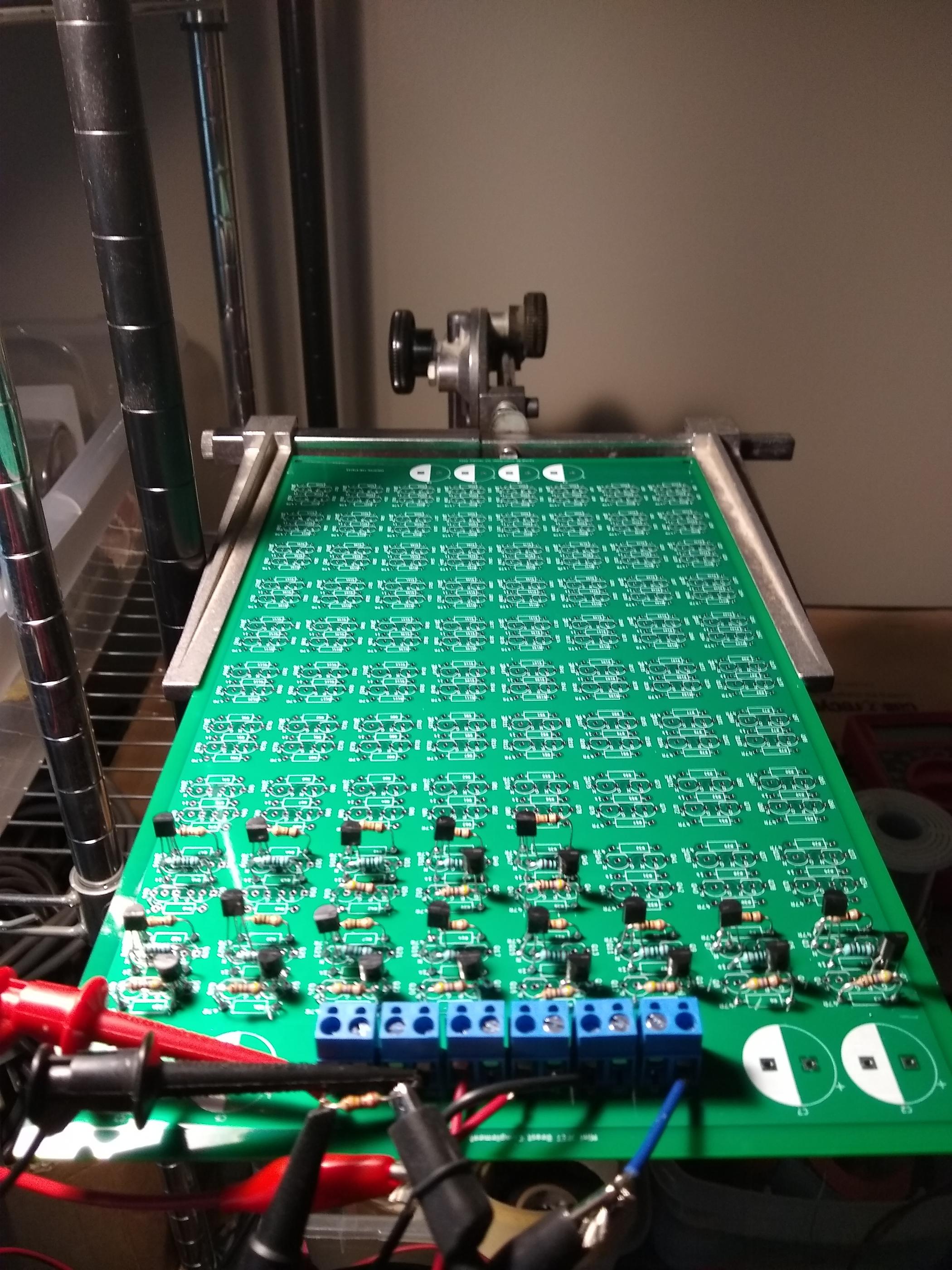

8 cells populated
130 mA idle current. Offset settles to 2 mV. The picture is shortly after power up.
I am bringing this board up one cell at a time to see how it operates.

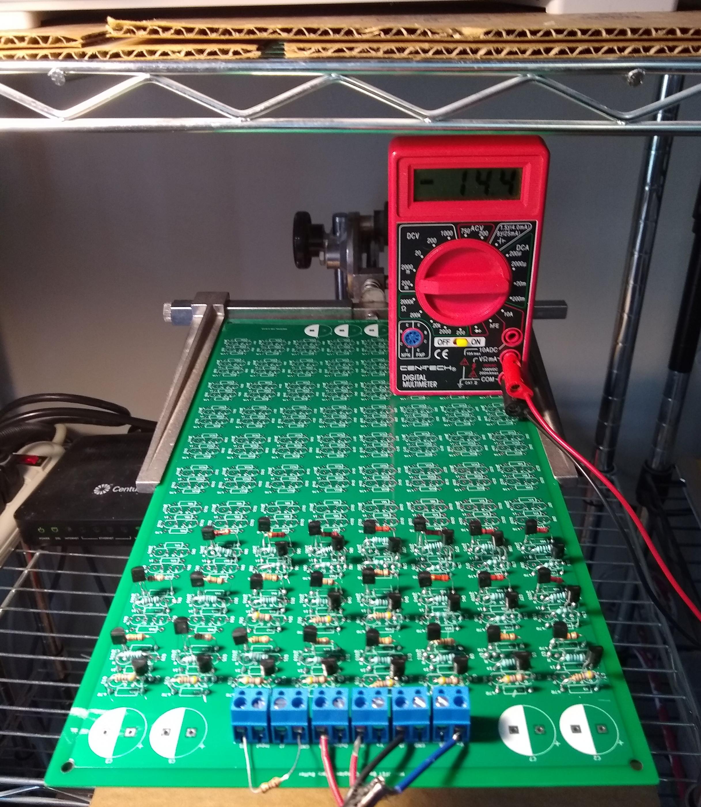

10 cells fully populated. 3 cells 1/2 populated.
180mA idle current. Output offset near 20 mV.
Output impedance 5 ohms.
Fully populated board should be over 1A idle current with near 0.6 ohms output impedance.
