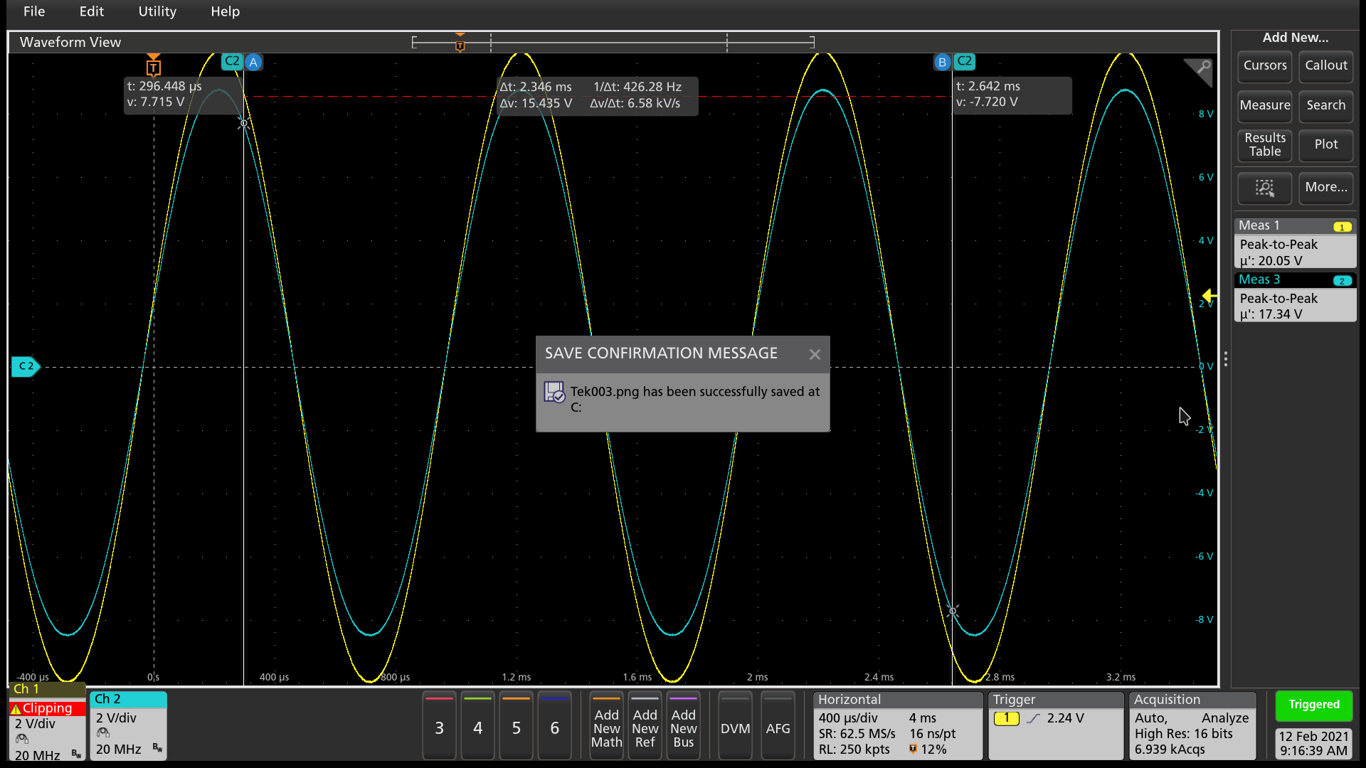

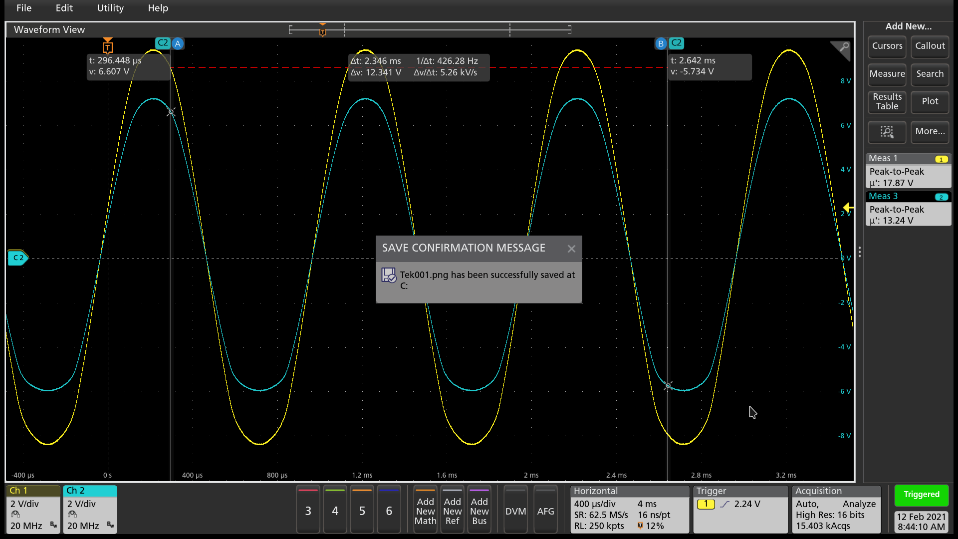

Attached scope capture, yellow trace is input from sig gen to PCB at 1kHz. Blue trace is output from PCB to 3.3 ohm power resistor.
Not too bad for a handful of gnarly JFETs.
Same setup 8 ohm load. 4.7 watts RMS into 8 ohms. My sig gen stops at 20v p-p. You can get more power with higher voltage rails and/or more drive voltage. I would run this PCB at + / - 15 if you want absolutely the most output.
Looks beautiful. Do not use this amp with a 3.3 ohm speaker.

Oops, wrong magnitude, should be 12-18M hence impractical. Sorry.
No worries. I appreciate the discussion. If you look at the scope shots above, this amp works well until you hit current clipping and it clips softly. I think a good low impedance driver is all that is needed to make this amp a complete package.
No need for heat sink and the temp coefficient is self-stabilizing. If you build 4 PCBs and run balanced, you can easily get 10-20 watts. It is just not high current and low impedance.
Being a complementary power JFET output stage, it is very unique.
