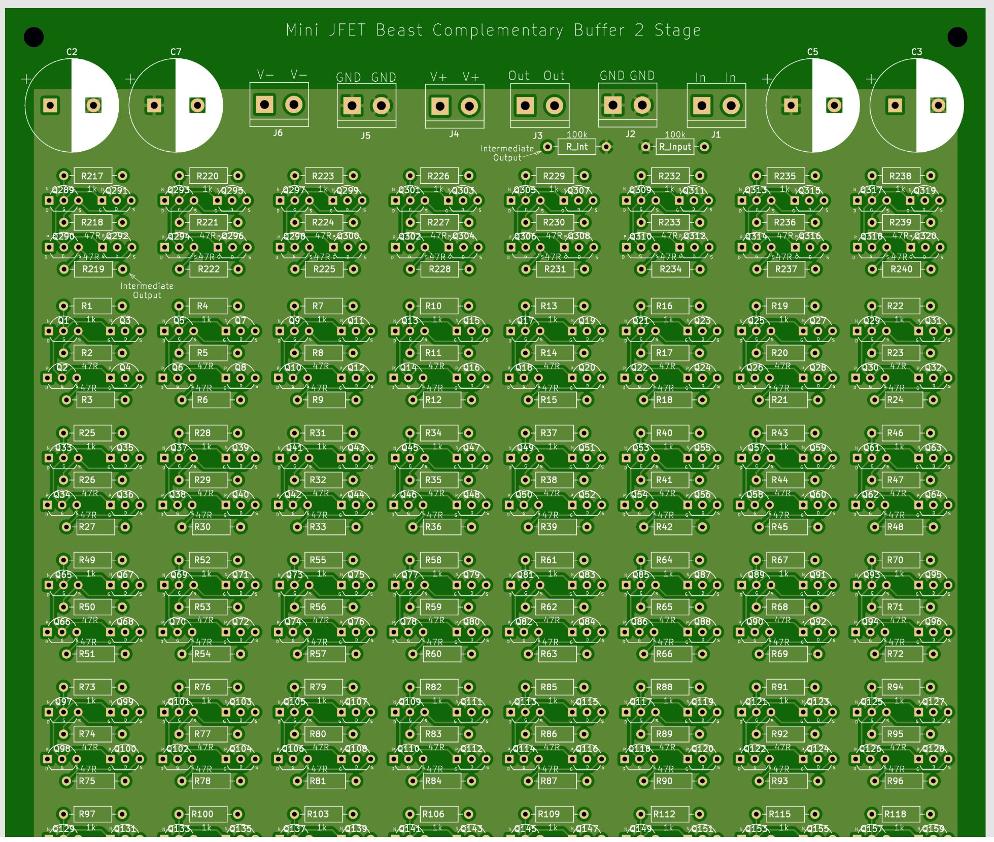

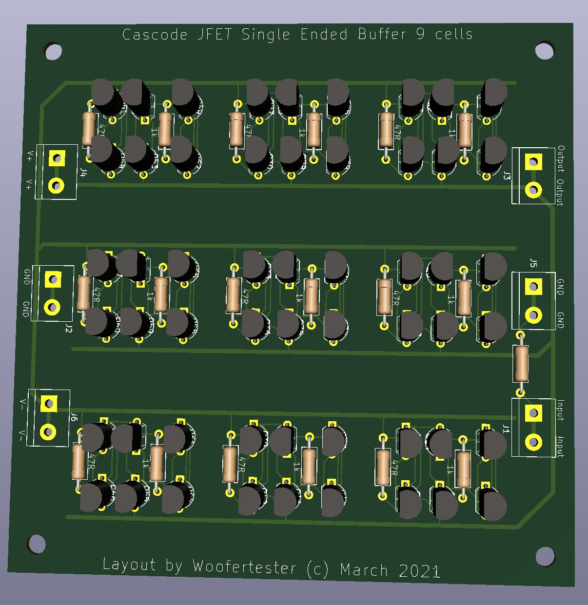

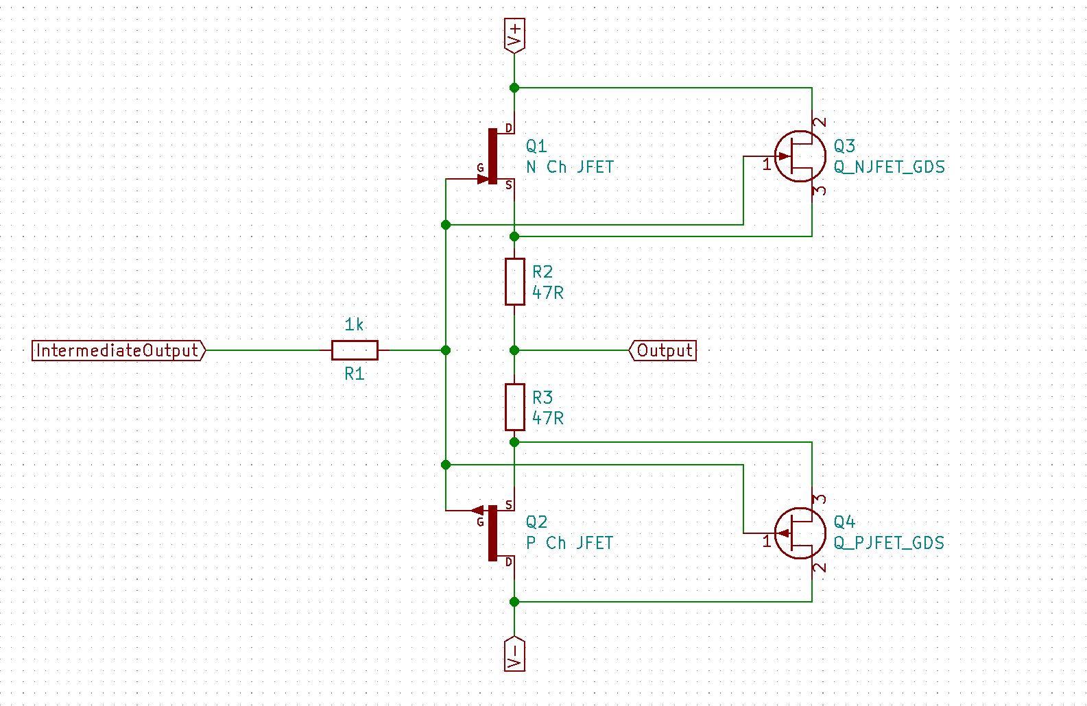

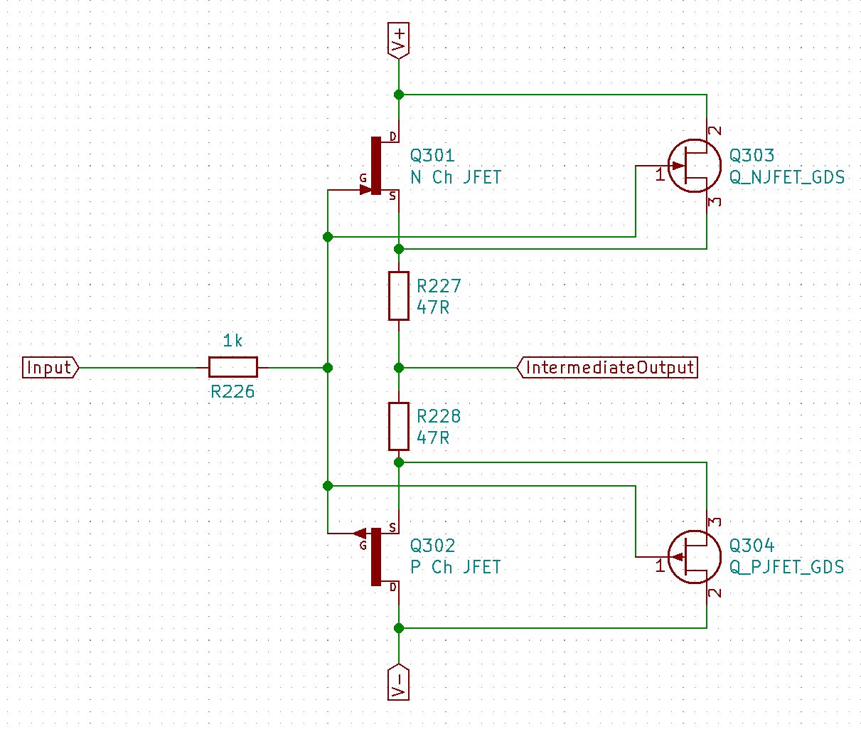

Schematic of both stages. The schematic is hierarchical. 8 instances of stage 1 and 72 instances of stage 2.

Wow! 6-layer board 😱
I cannot imagine what this has cost you to get to this point. This is a super interesting project for the hardcore greedy boy. Thank you for sharing your journey with the rest of us. :cheers:
The engineering fee is more than the PCBs by quite a lot. It is a learning exercise for me. Adding to the skill stack. Having a one-of-a-kind NP inspired JFET power amp is the largest attraction.

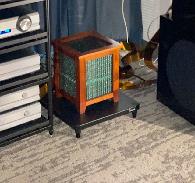

Needs a photograph. Here is one.
Papa sent me the boards, j-fets, and resistors. There are 4 boards with 512 j-fets per board. It was a soldering exercise. Was done Tuesday about midnight, burned in on Wednesday, and off to Axpona on Thursday.
For those of you who are curious as to what it sounds like - it is lovely, precise, and very, very fast. Flat to 500 kHz.
At Axpona Kent English of Pass Labs and I played a game with the listeners called "Identify the Power Amp". Amazing how many audiophiles and every reviewer got it wrong. Common guesses as to what it was were pagoda, bee hive, and trash can. I guess I need to work on my artistic skills.

Hi Jon,
Thank you for the picture now that the video has been blocked.
