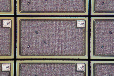

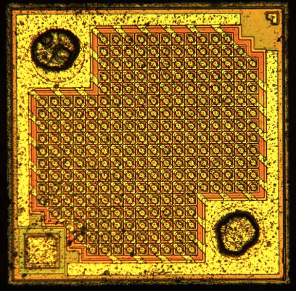

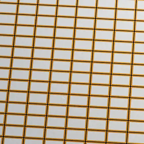

But then it would only have 2 Jfets. What kind of beast would that be?
Scary: The Beast With Two Jfets
The beast is inside the TO247 package when you inspect the bare die with a scanning electron microscope.
Patrick
Patrick
