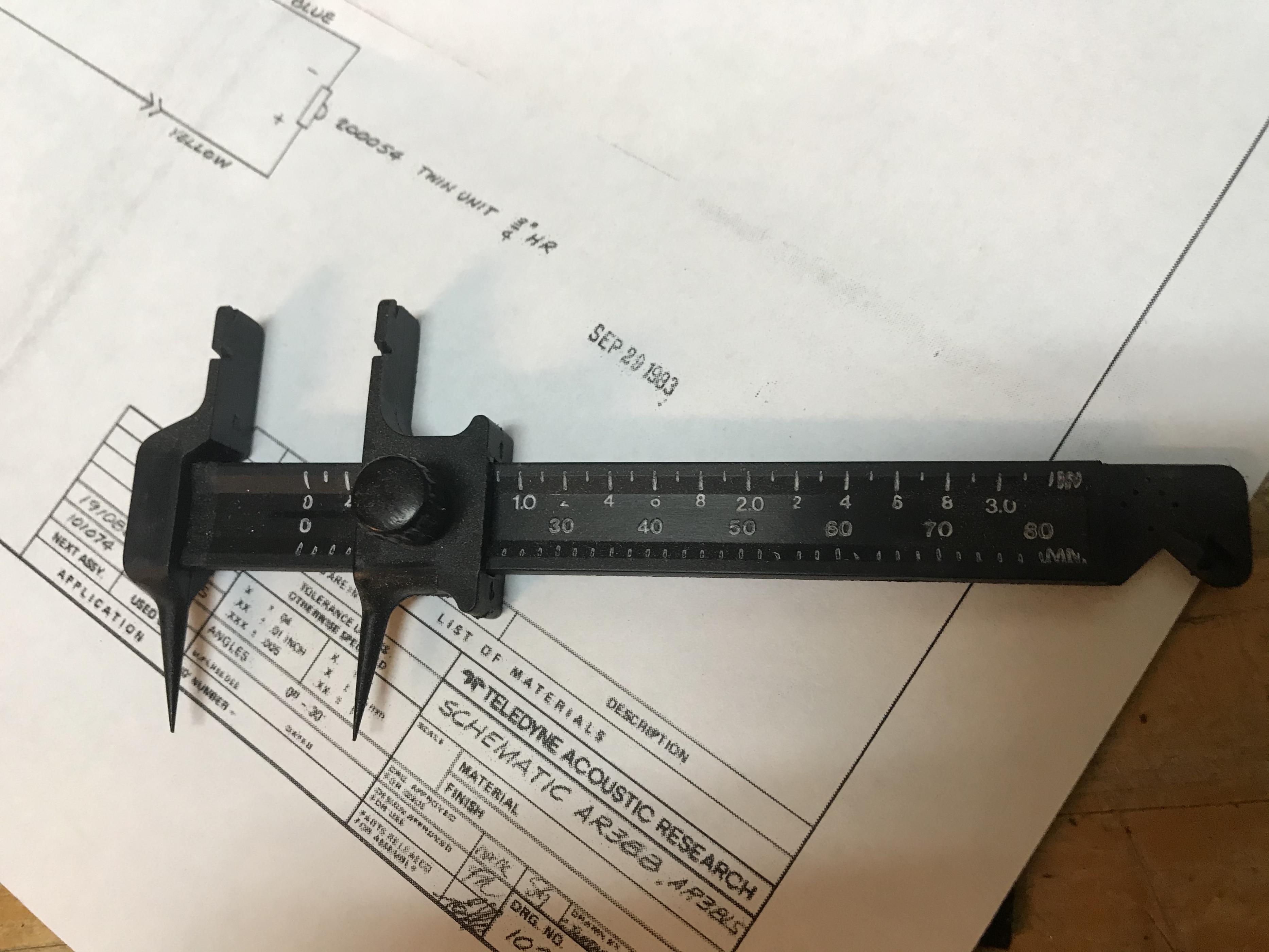

Resistor Lead Bending Tool | Production Devices
Can be interesting tools 3 pcs. 800K kit 🙂 ..Or find some similar model(s) Best regards
That is cool. Thanks
For the price, they are a good buy and makes the board look more professional with each resistor, diode etc bent exactly the same at a nice right angle.
Great tip. This cheap tool lasts forever and saves a lot of time. I love mine

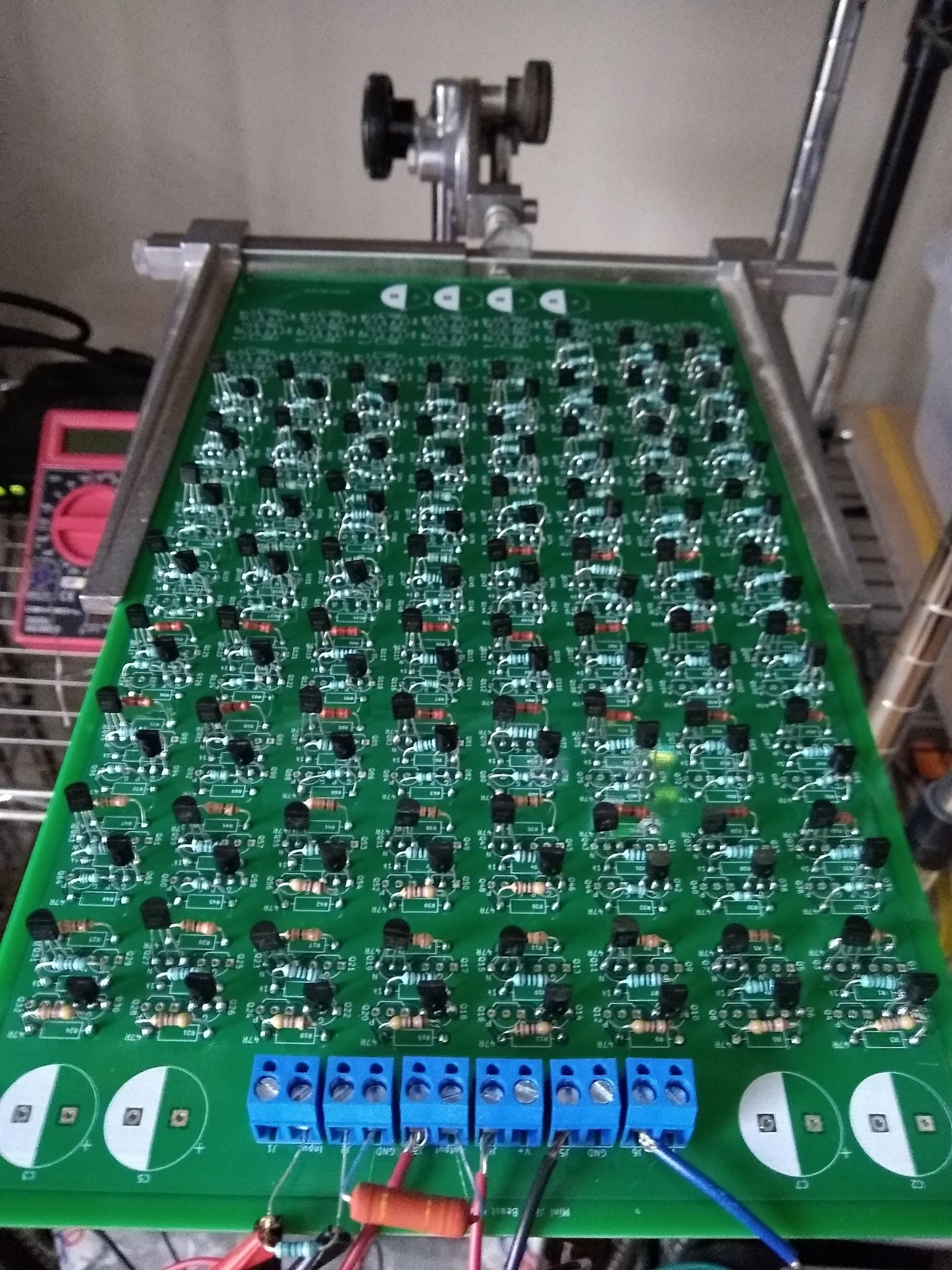

48 cells populated. Idle current 730 ma. Output offset voltage single digit millivolts.
Building one cell at a time is instructive. I check output offset and choose the next pair to move the offset closer to zero volts.
If I fully populate this PCB, it should end up around 1.2A. I plan to stop as close to 1A as possible.
What are your thoughts on going single ended? N-JFETs here are half the price of P-ones. If going with 100 fets, could one compensate differences in individual fets with source resistor of certain value, if very close matching is not desired?
What are you using to hold the PCB? Looks pretty handy.48 cells populated. Idle current 730 ma. Output offset voltage single digit millivolts.
I bought it at a flea market decades ago. It was used by a pinball repairman. It is a Technical Devices PCB Holder. It is cantilevered with 4 detentes. It is easy to flip over and remains horizontal in either position. It has a quick release mechanism.

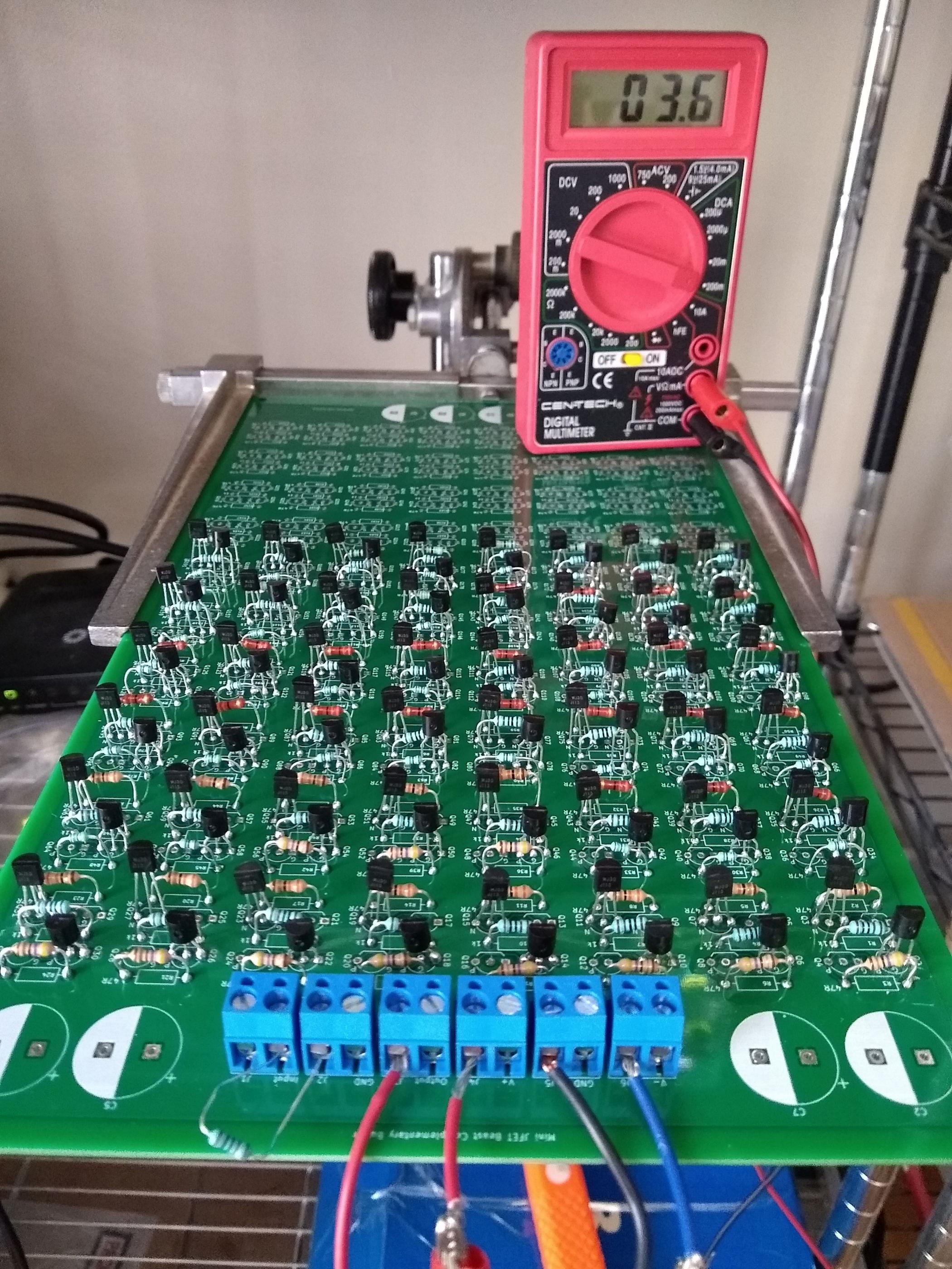

66 1/2 cell populated. 1A idle current. Less than 10mV output offset.
Connected signal generator and oscilloscope. My sig gen cannot drive this beast. The sig gen runs out of current on the negative going 1/2 of the sine wave at maximum voltage of the sig gen.
This beast will require a low impedance buffer if your preamp does not have a low output impedance.
