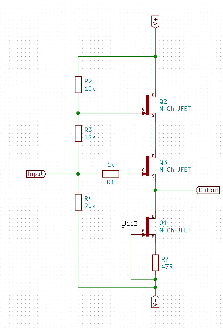

Rail to rail SE buffer
I am thinking about a rail-to-rail single ended JFET buffer. I stumbled upon a nice JFET for Q2 and Q3 but the max voltage is 1/2 of the J113. I would like to achieve near rail-to-rail swing.
Will something like this work?
I assume a capacitor belongs across R2 or R3.

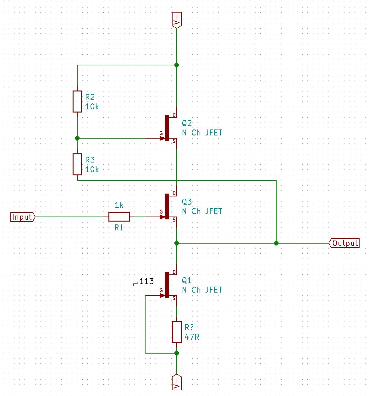

R2 and R3 ref. to output, R4 not needed, cap across R3
don't fret, I had posted much greater stupidities, over the years
Like this? Yes I see your point.

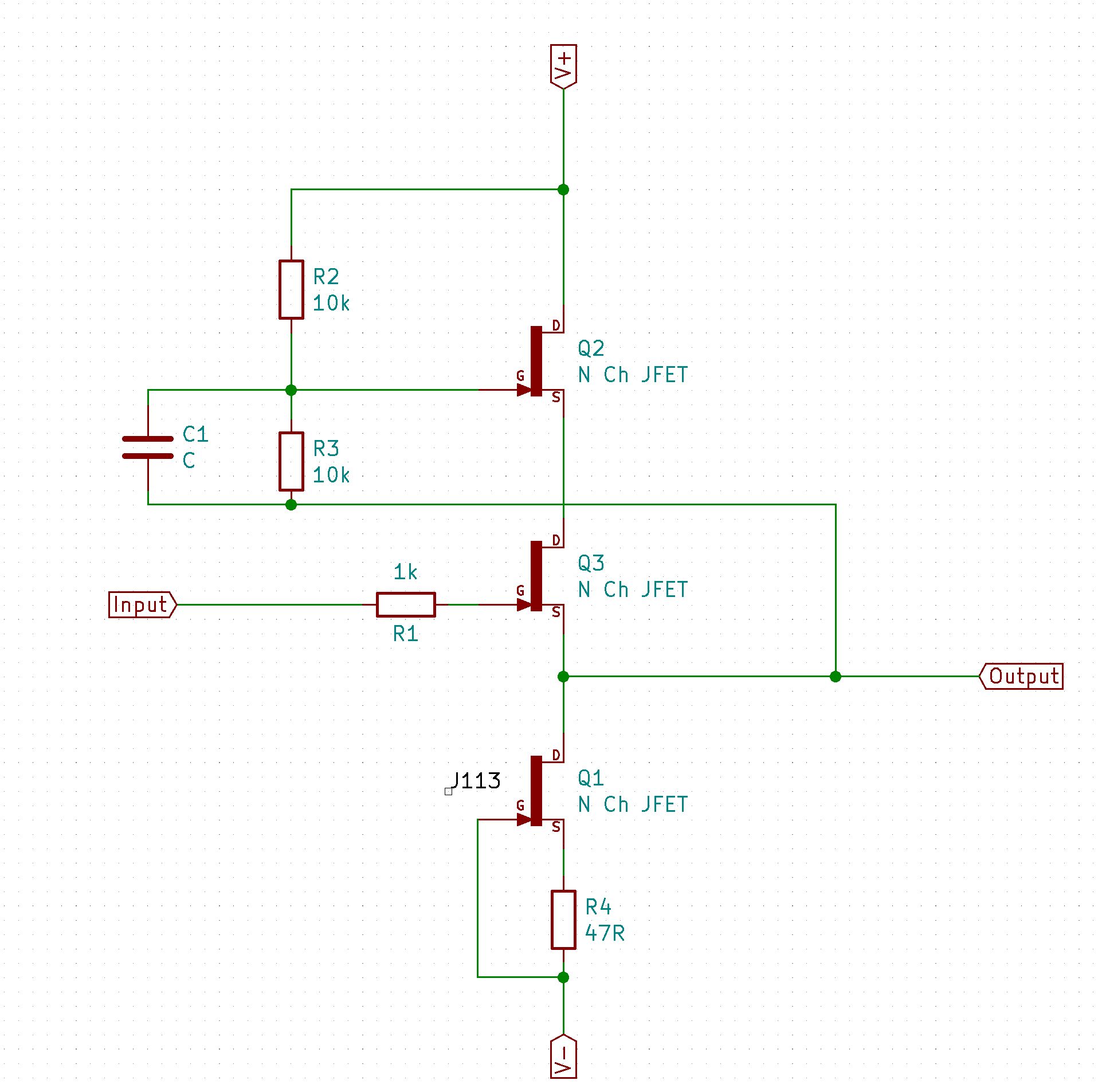

Q2 can be a garden variety BJT I suppose.
The cap is IMHO a bad idea.
I suggest you take a close look at Calvin's hybrid-compound-super-buffer.
hybrid-buffer - calvins-audio-pages
Patrick

I can breadboard with and without cap. Thanks for the suggestions.The cap is IMHO a bad idea.

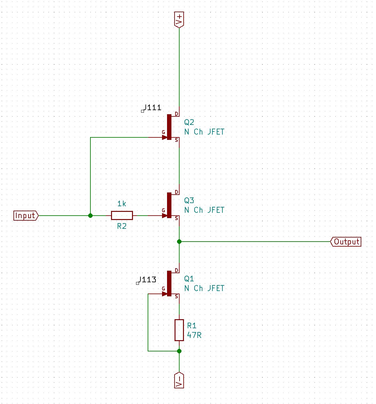

If you pick a Q2 with high Idss and high Vp you can use it as a cascode without
the caps and resistors, just attach its gate to input through a gate stopper resistor.
J11 is a candidate, maybe J112
Thank you. Like this?
