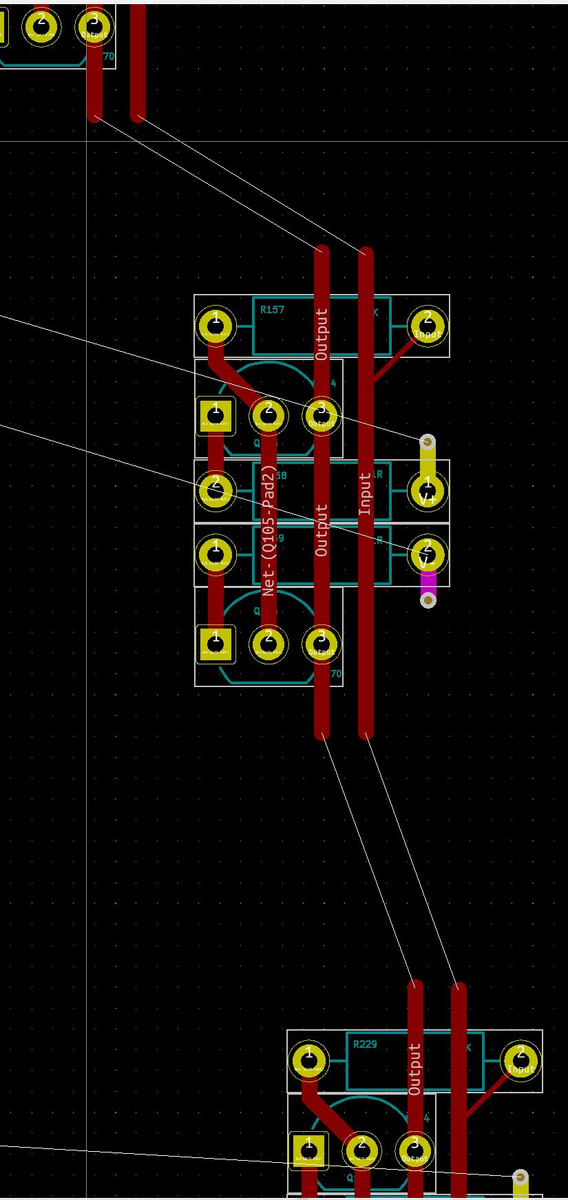

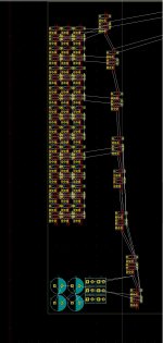

Yes scalability is a benefit. I can make a small version to learn and make a much larger version when ready. Speaking of that, if there are any Kicad experts who want to participate, we could make open source sub-circuits for people to use as desired. The largest time sink is cloning and arranging the cells. The tools to make these massively parallel row-column arrangements are not native to Kicad. One of the plugins that should help so far has been a disappointment.

Wouldn't it be better to use a layer for each DC rail, and then short via to where's needed??
Here is the buffer cell laid out for a 4-layer board. The cell packs much more compact than a 2-layer board.

Your PCB layout went well but I suggest to place some ventilation holes in PCB.
I remember Elektors D.Self parallel NE5532 power amp. The opamps in the middle of the PCB went pretty hot compared to opamps at the edges because of difference in air flow. The copper in a 4-layer will help to distribute heat also, but I guess some ventilation holes would support to keep temperature raise low.

Good question. If you look at Nelson's article, the PCB is on its edge and the enclosure is vented.
Even if I mount it horizontally, I would use a well ventilated enclosure.

I have been struggling with Kicad to actually lay out 250 identical buffers. Just learned the last step this morning to make that happen.

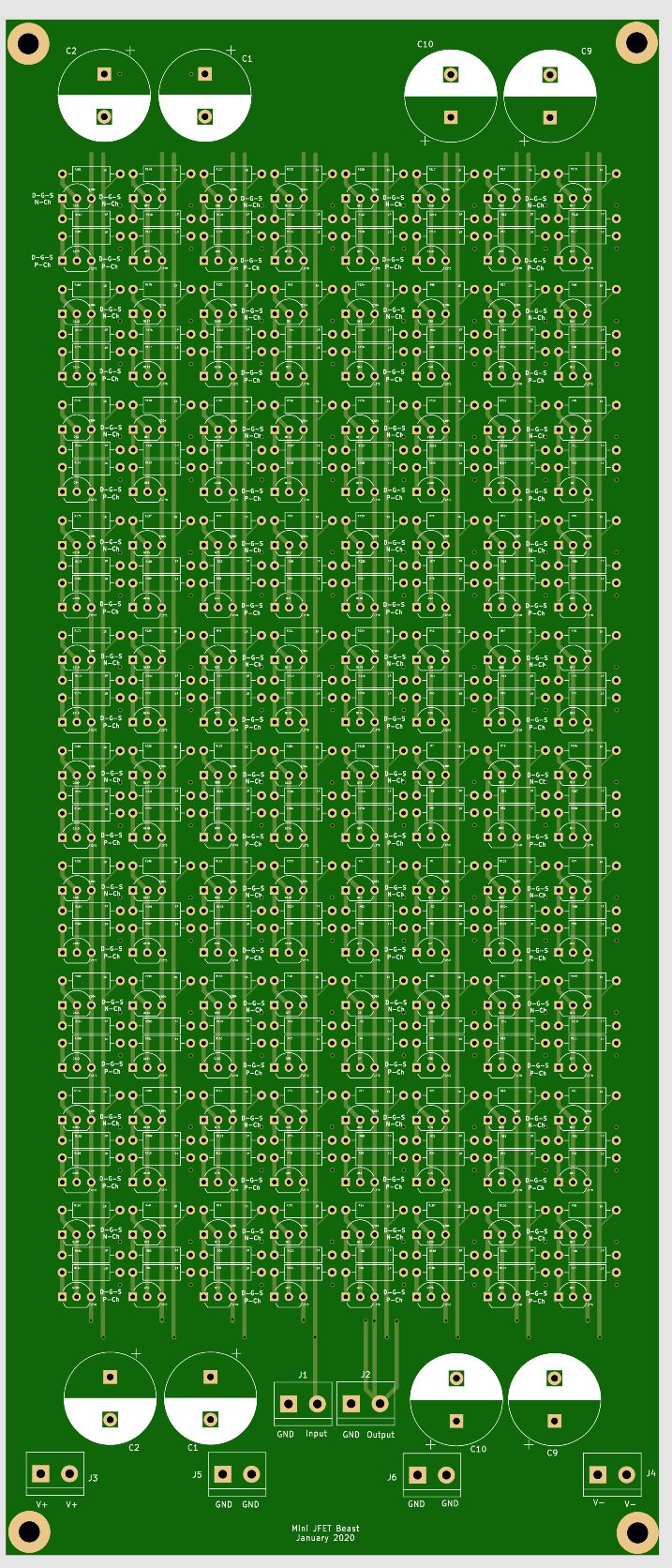

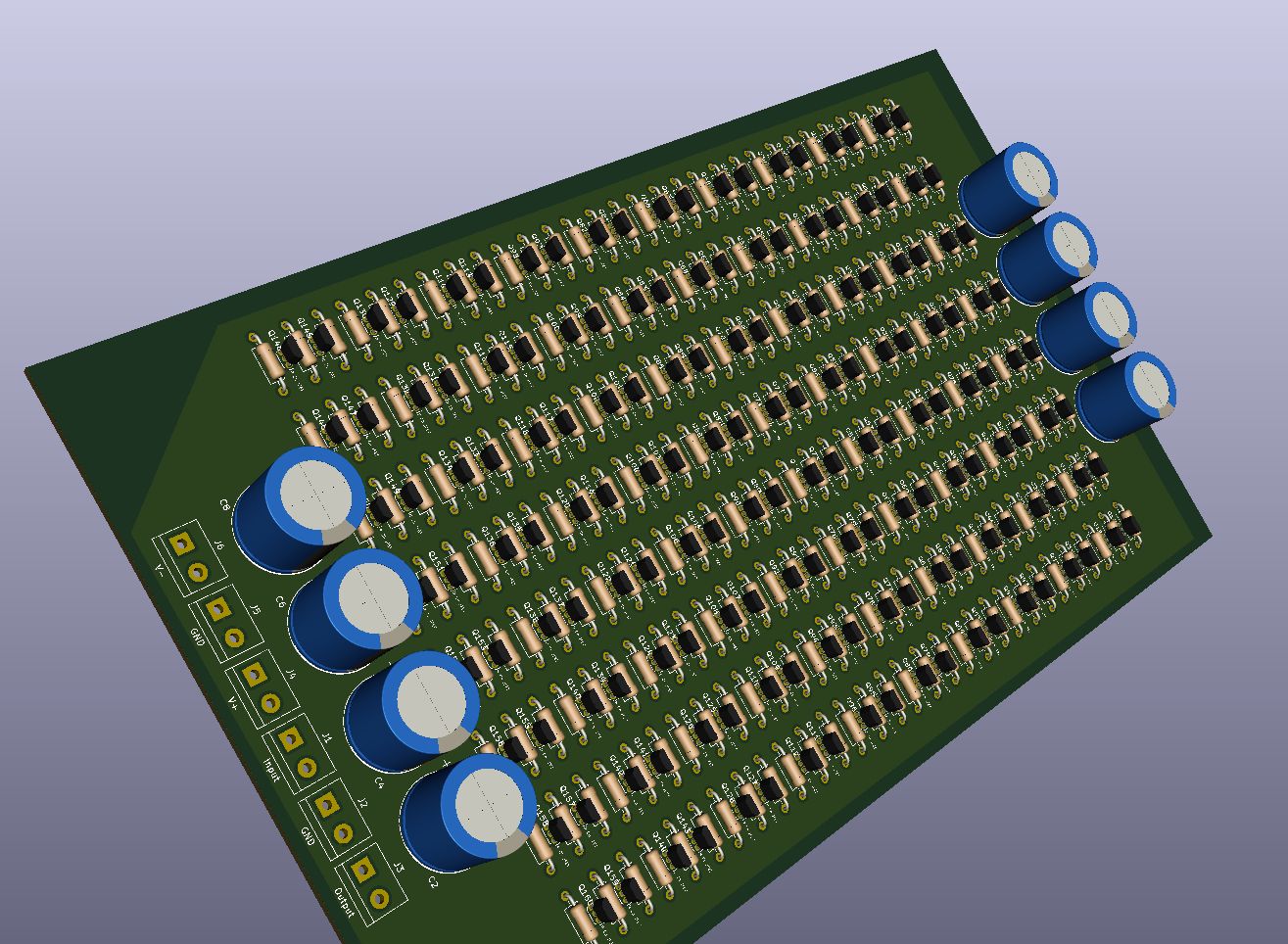

The TO-92 through-hole flea-powered version is now in production. It may get to me by the end of next week.
In the meantime, the massively parallel B1 starts layout this week.

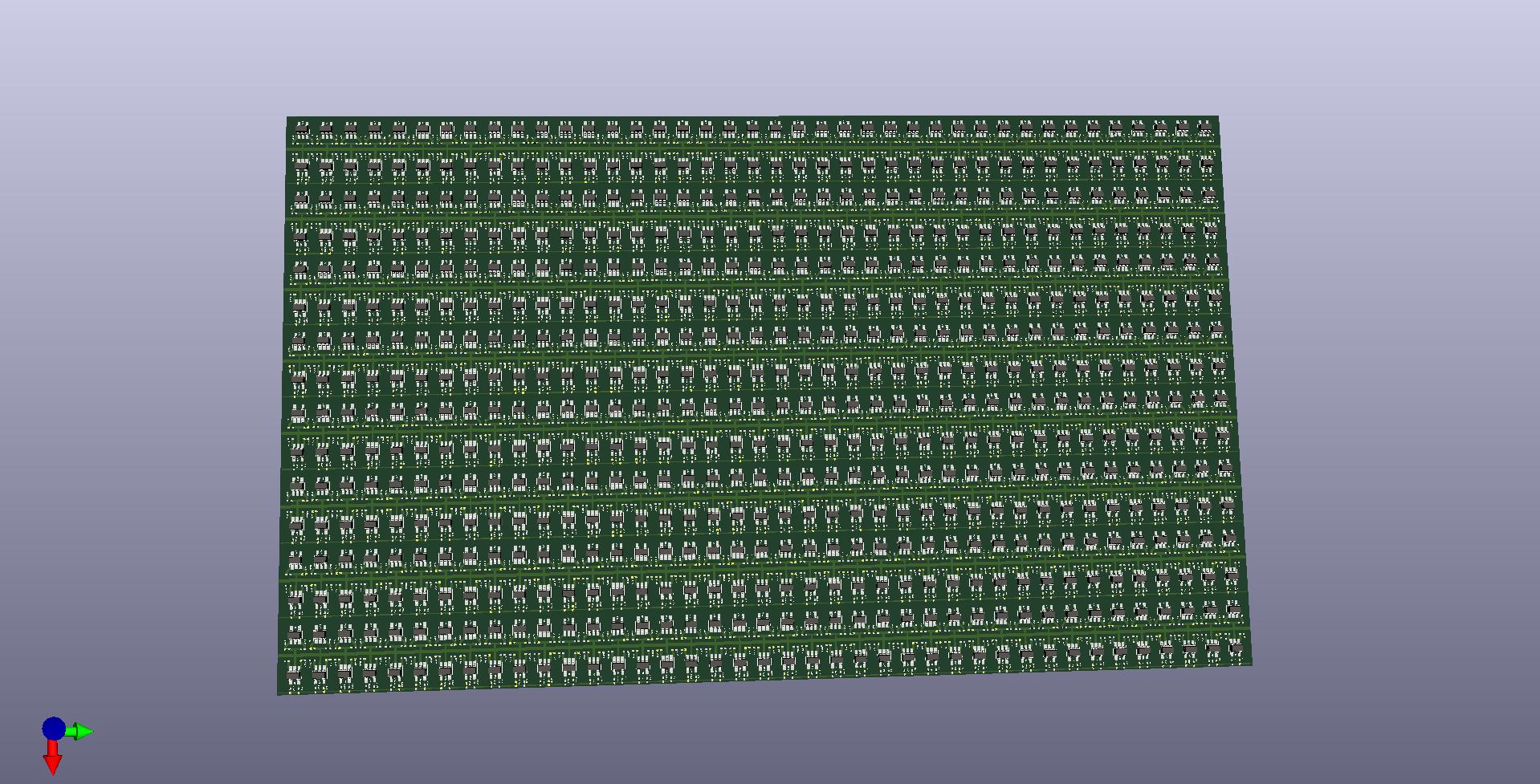

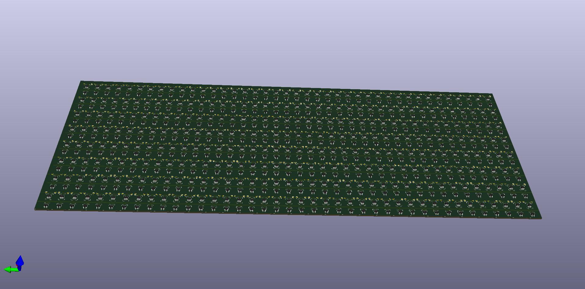

This one is good enough to send for fabrication. It has taken a week to figure out how to get the plugin to place these. Hand route one cell. 639 cells are a clone. All parts have unique sequential part numbers. There are 999 ways to do it wrong and 1 way to do it correctly.

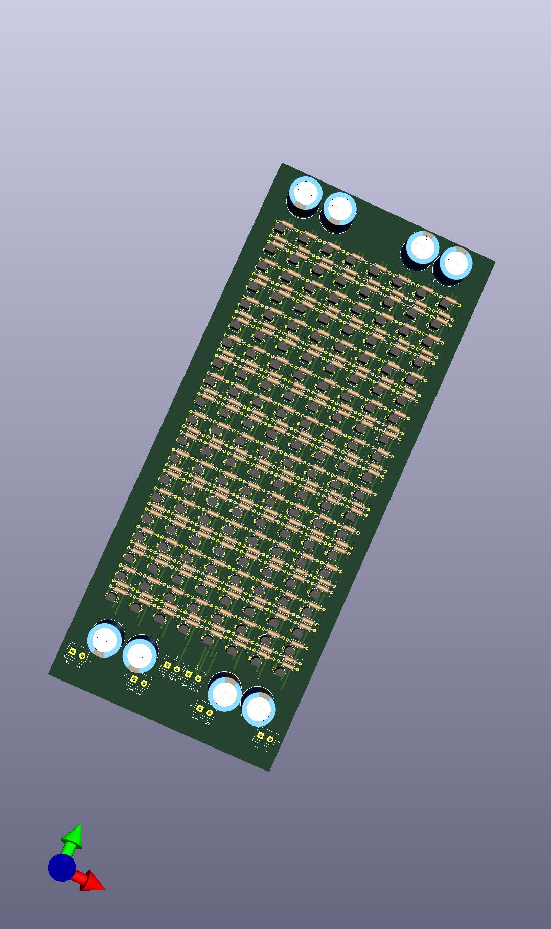

Third iteration of massive complementary buffer. 80 buffer pairs for headphone usage and flea power speakers.
6-layer board allows no hand routing between buffers. I only had to route one buffer and clone the rest. The cloning plugin also can arrange a matrix of identical circuits.
All of the circuit nodes have their own copper layer.
