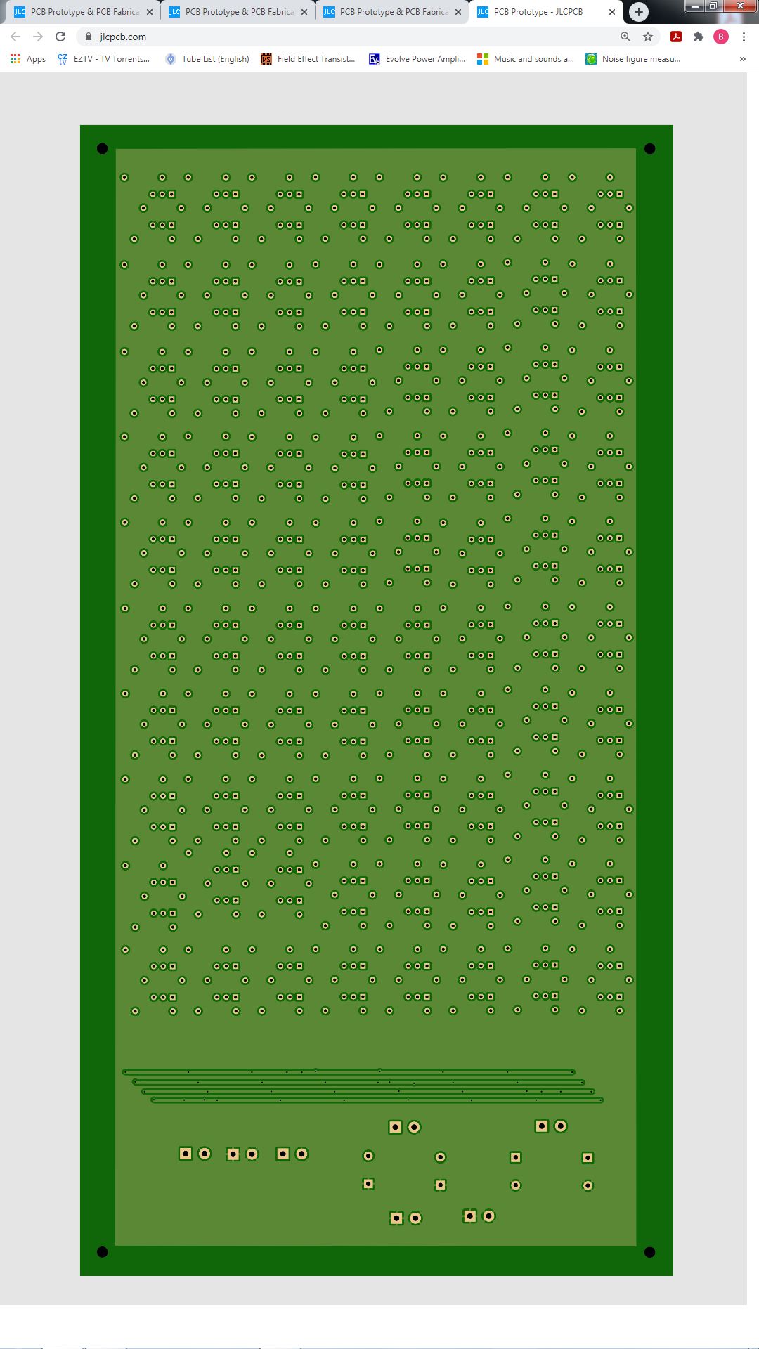

1000pcs?? Vasting precious discrete jfets, they are all ready disappearing...Here is what I think is the "optimal" layout for the buffer. It consumes 0.2 inches^2. It is two of the 2SK2145
This is 4 transistors comprising two parallel buffers.
The NP original Beast 14" x 21" board costs double extra because of large size and is larger than needed for the SMT version.
The plan is to make a 10" x 12" board with room at the top and bottom for power and signal terminal strips.
1000 pcs of 2SK2145 should fit on one side. It will be 1000 B1 buffers in parallel.
Using the Y grade of the 2SK2145, it should be possible to run at + / - 15V and not have power dissipation problems at each device.
Bias current will be at least 1.2A, probably closer to 2A.

The first through-hole boards arrived and it was a disappointment due to solder footprint of the transistors. Almost impossible to solder for me.

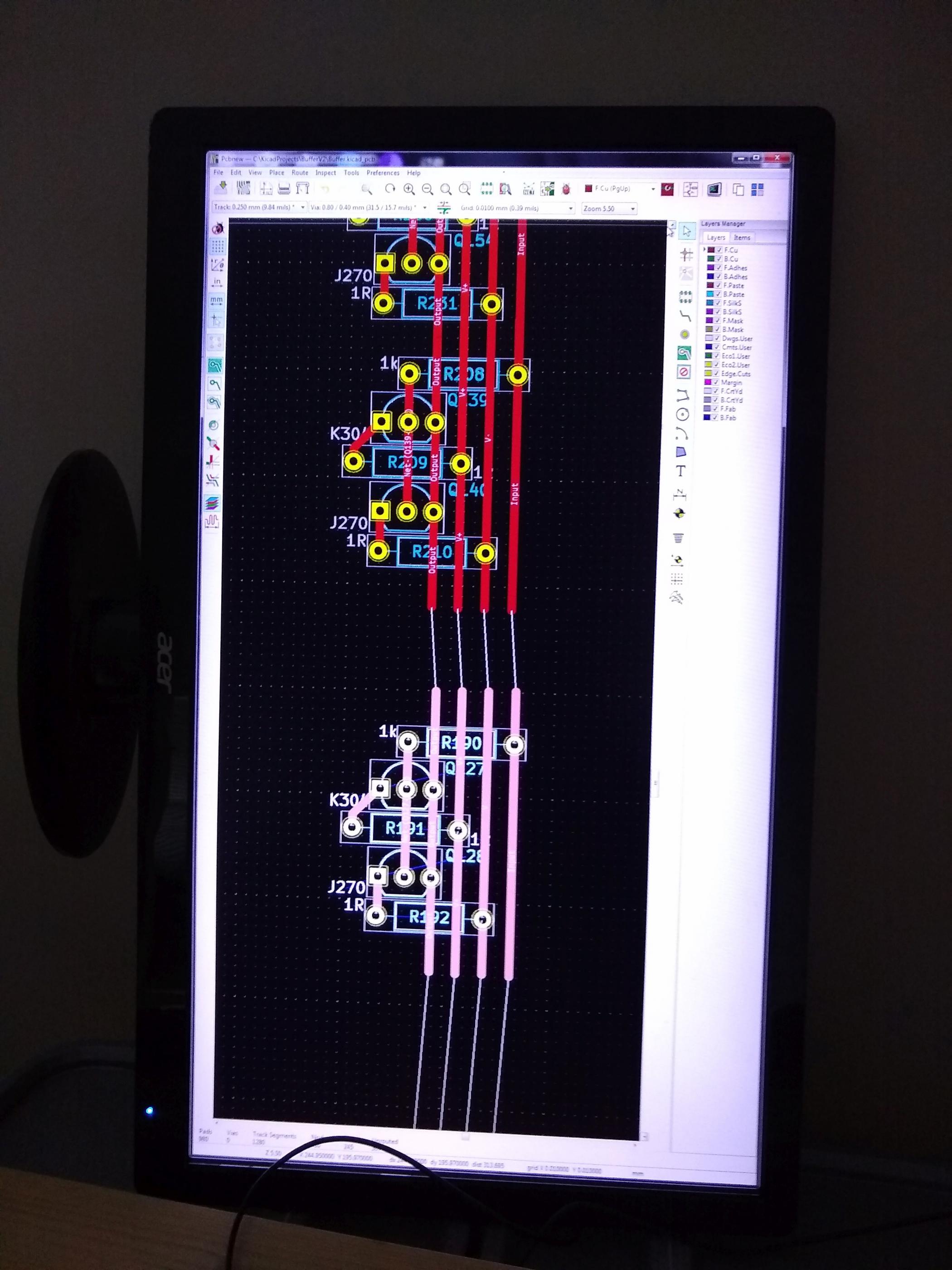

Rev 2 of the through-hole board is now in layout. Resorted to turning my screen sideways. This is so much better for placing and aligning cells in columns.
I think that the basic cell in now improved as well. Learning how to orient and space footprints better.
My goal is ease of bus routing rather than nice neat columns of parts.
The basic layout fits on one side of the board. Back side copper for routing the buses between columns.

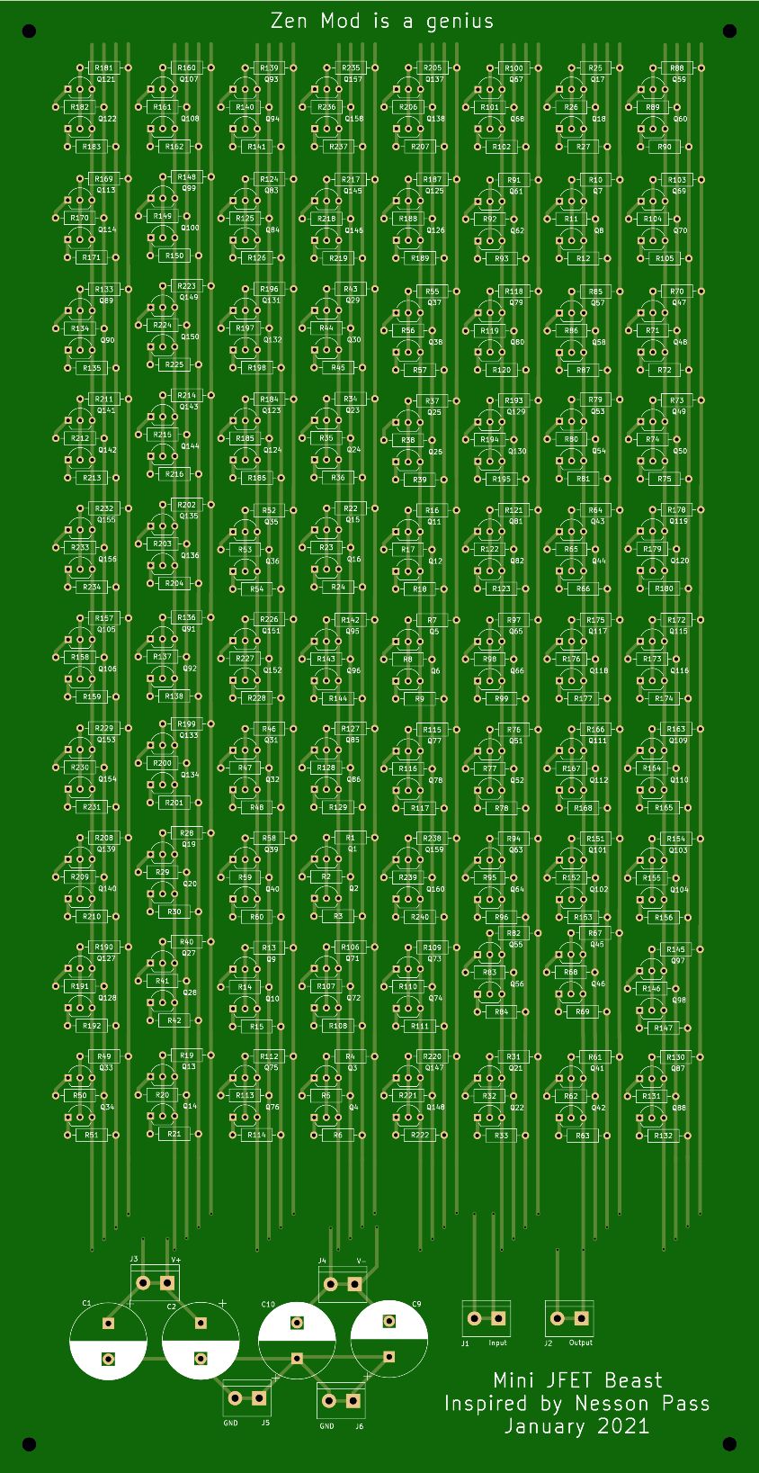

Mini Beast V2 board
160mm x 310mm double sided
I am pleased with the new cell layout for stacking in columns.
The specifics of getting these to move and stack is tedious and could do with some automation.
There are ostensibly plugins to help Kicad and they garble the cell so no help from the "place footprints" plugin. The "replicate layout" plugin is immensely helpful.
This was about two full days of layout work. Quite a few more days to learn enough to know how to spend the two days on this layout.

There appear to be connection problems and wrong traces on the filter caps and PS connectors.
Also on the Vin and Vout connectors. NP name is spelled wrong.
For example, are there not traces shorting together each of the six connectors' 2 pins?
That would be a net error, not a DRC error.

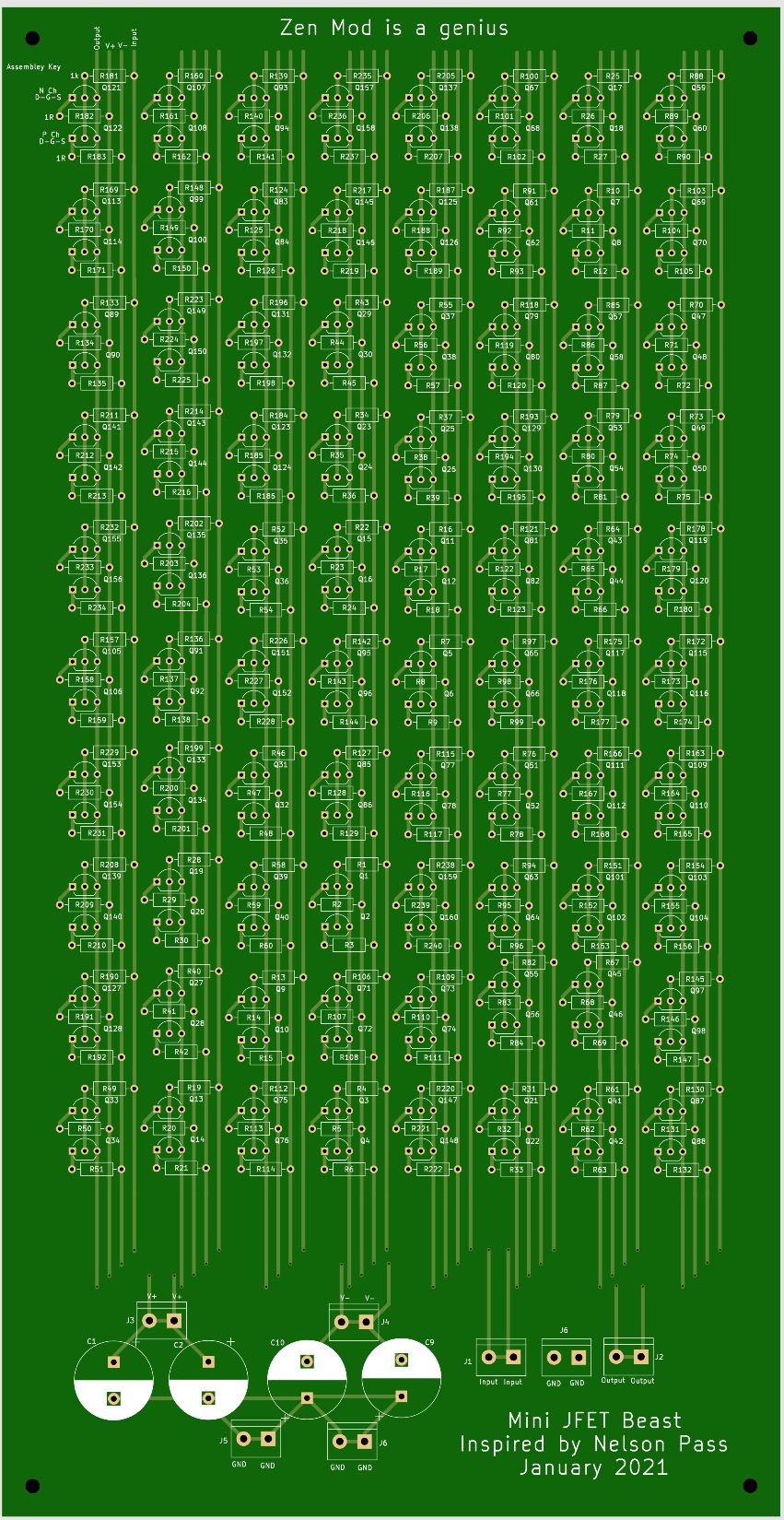

The DC filtering and current distribution need attention.
Wouldn't it be better to use a layer for each DC rail, and then short via to where's needed??
The problem is that I did not label every pin. Now it should be clear. I also added a GND terminal block between the signal terminal blocks.
Top view and bottom view attached.
Good points. Just learning 2-layer layout now. a 4-layer version would be a refinement/upgrade.
I can measure the traces and quantify the resistance of the tracks. If the tracks are high resistance compared to the impedance of the JFETs, then your idea would be called for.
