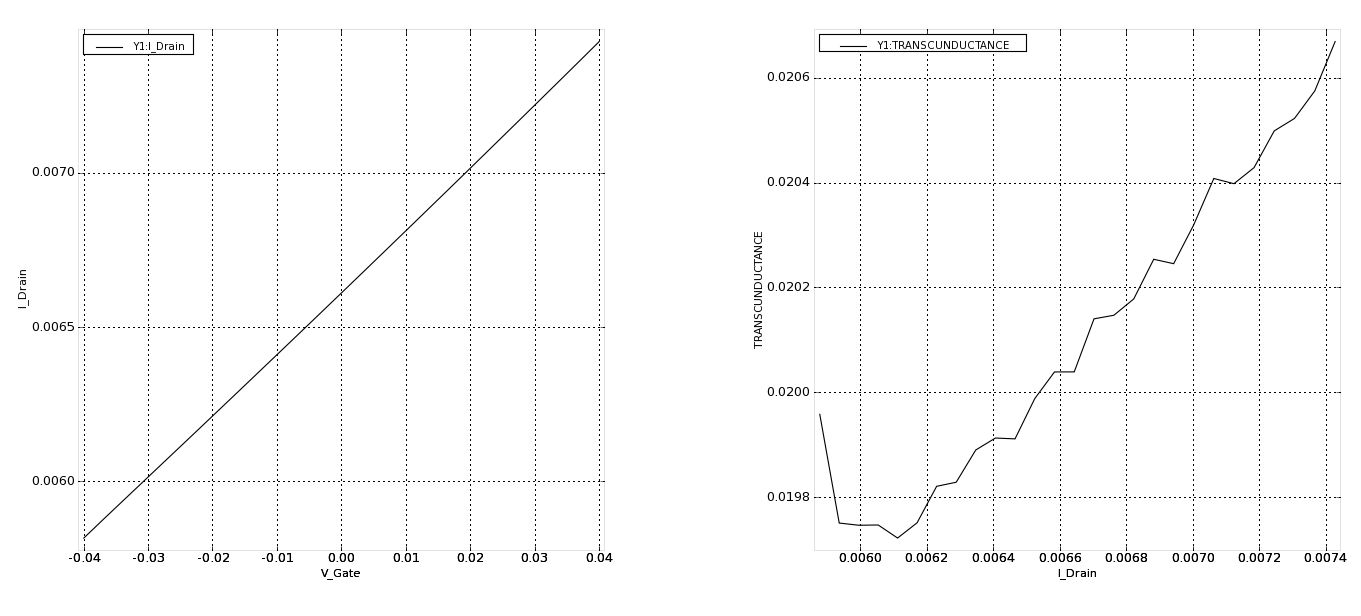

Beast with 1000 JFETs redux?
Here is the 2SK209BL Vgs-Id and transconductance plots at Vds = 5V

For sure the LU1014 is on the road map. But it will never become a complementary buffer. The LU1014 is a different animal for a different rodeo. I also don't consider the LU1014 just a JFET. The extensive curve tracing I have done tells me it is a static induction transistor so it has a more special place on my list than just a JFET.
I think that there is an appetite in this community for pedestrian JFETs in a highly parallel complementary follower. Nelson's disclosure of 4 different topologies is evidence.
So, I am searching for some candidates.
Here is a new question. Does anyone have noise spec for or an actual measurement of a Sanyo 2SK304?
J270 P-channel JFET 360 pcs tested Vds 5V
Idss ranged from 4.4 mA to 6.1 mA
Average Idss 5.1 mA Total ganged Idss 1.8A
2SK304E N-channel JFET 272 pcs tested Vds 5V
Idss ranged from 2.8mA to 4.6 mA
Average Idss 3.7 mA Total ganged Ids 1.0A
Next step is to create a board that can gang enough parts to make a complementary buffer with 250mA bias.
